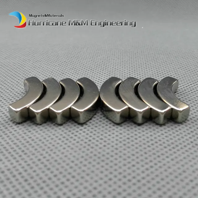

                    Looking around i see machine materials. Tolerances could helped by
                    using curved rotor magnets. I'm thinking machining and prices.
                    DOUBLE ROTOR LOOKS GOOD, HEY?
                    https://www.apexmagnets.com/54mm-x-46mm-x-20mm-motor-magnets?fee=5&fep=168&gclid=CjwKCAjwpfzOBRA5EiwAU0 ccN1EhXNh6tX66kQ9hC5eENT9L-wjOmtCOnHFqijz_iD5UY_NVZwiJuxoCymoQAvD_BwE
