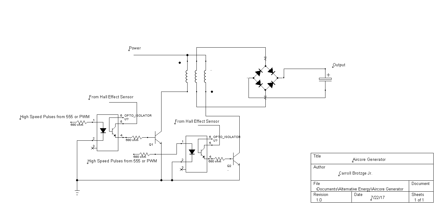

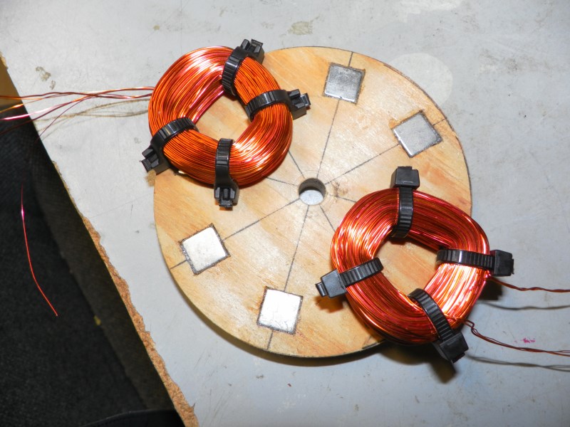

            Aaron asked me to share some info about my air-cored motor on the original thread about the Zero Force Motor. There are a couple of reasons why I am going to share here instead. I did not order the book or watch the videos about John's Zero Force Motor. So I really can't compare what I have done with what has already been done. I came about this design because I was looking for a motor/generator design that would not have the drag from the cores being attracted to the magnets. I didn't even know if I could make a motor that would run without cores but made a simple one and it did run. So I decided to pursue it some more until I got to the point where I am now. I still have a lot more things to try and explore but I am willing to share what I have done so far.
            I have attached a drawing and pictures to help you understand what I have done. In the first drawing you will see the relationship between my magnets on the rotor and the coils. You will notice the sides of the coils are aligned with the center of the magnets. The magnets are alternating in polarity. Using hall sensors and a circuit I designed the one winding of each coil is pulsed when the magnet is right over the side of a coil.
            The coils are trifilar with two 30 gauge wires and one 24 gauge wire. I made the coils this way because I wanted to make this a generator as well as a motor.
            After the first coil is pulsed the rotor will move 45 degrees and another winding in the coils will be pulsed with the opposite polarity to again give the rotor a kick. The third winding is picking up the inductive kickback of the collapsing magnetic fields as the transistors are turning off and also picking up the impulses from the magnet passes.
            At the time I made the video I only had two coils mounted in the machine. I have now added two more and have room to mount 4 more on the opposite side of the rotor when I get time to wind some more coils.
            If you look at the schematic you will see I have a slightly strange circuit. During the on time established by the hall sensors I also am adding pulses to the base of the on transistor. This was to make the motor side more efficient and to add some more inductive collapses for the power winding to pick up.
            Also when you look at the schematic you will see I did not use bipolar switching. I am only using two transistors and have the windings of my coils connected so that by pulsing one and then the other winding I am actually reversing the polarity of the coil every 45 degrees. Using this method allows me to add recovery diodes at the collectors of the transistor like the SSG for additional collection of the energy from the collapsing magnetic field. Those diodes are not shown on the schematic.
            The last attachment is a scope shot of the signal on the power winding. You can clearly see the AC signal from the passing magnets and the pulses from the high speed pulses being applied to the base of the transistor. You can see from the scope shot my timing wheel had slipped slightly causing my pulses to be just a little late from when they should have been. My timing wheel is adjustable for experimental purposes. That is something I have not really done any exploring into yet. I have just been running it with the pulses centered on the peaks of the magnet passes.
            There so much to be learned from this type of motor. I have the coils mounted with hot glue because the stress on them is so low I felt it was safe to do that and it makes it easy to change things any time I want to. The rotor is made from some very high quality plywood so I feel it is safe for the speeds I am running at. I don't push it for high speed. With an input of about 24 volts or so it will run about 3000 rpm and only draw about 150 milliamps. With only 4 coils and with only recovery from the power winding I am seeing an efficiency of about 25 %. Nothing really to brag about. I have not made an kind of measurements of the torque of the motor. I do believe when I get the other 4 coils mounted I will have enough torque to turn a small load and still recover most of the energy being used to power the motor.
            Carroll

              Hello all,
              Carroll

                        Congrats Carrol; to your good circuit. Two Switch transistors and the two Transformer coupled Coils reduces the power consumption to drive the coil ( motor magnetic impulser unit) to about the same low level as I have, with my used principle and my single winding, without distorting the signal. ( Still about square) I took my coil values and used that x2 in your two coils and made a simulation.
                        BUT, but with your principle you have to have two windings on the same bobbin. To make them fit there we have to reduce the Cu-wire diameter. ( More Ohms in both coils)
                        That reduces the Amp-turns with reduces the magnetic power as a result.
                        Compared to a single wire coil principle, here we have to increase the battery voltage.
                        If your input pulse signals A and B (not the iterrupting F.G. chopping signal. Not simulated yet) is let say: Cycle time=6ms ,OnA=2ms OffA=4ms, OnB=2ms OffB=4ms and signal B is delayed 3ms
                        THEN the OUTput will be a 3ms+3ms (50%/50%) zero and 180 degr. square signal. (With my coil values) Do you want that??
                        BUT with a shorter On-time (A and B) than 2ms the output signals will be a mess, corrupt and stocastic.
                        And you are right about windage losses and such. I know nothing!
                        I come to think of one important thing: Your coils are NOT TRANSFORMER COUPLED. Air coils. Uhuuuu Now output signals will be a mess, corrupt and stocastic
