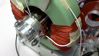

            More pictures
              Pictures of similar builds

                      A Zero Force Motor with nice stable speed.
                          https://youtu.be/IHtL6lGovwM
