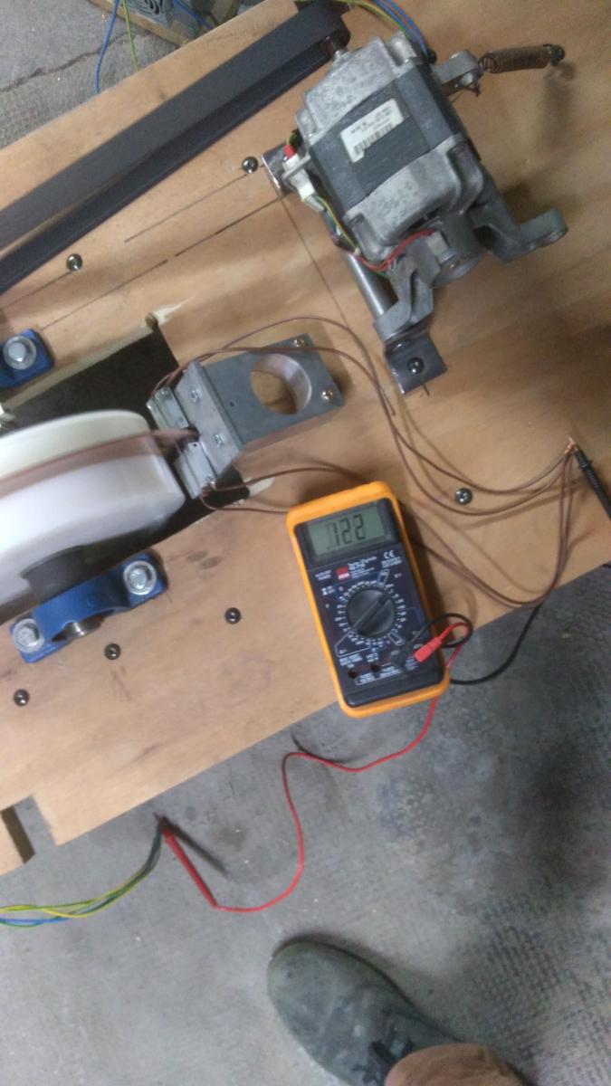

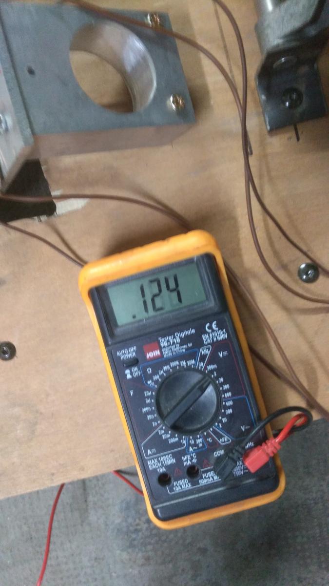

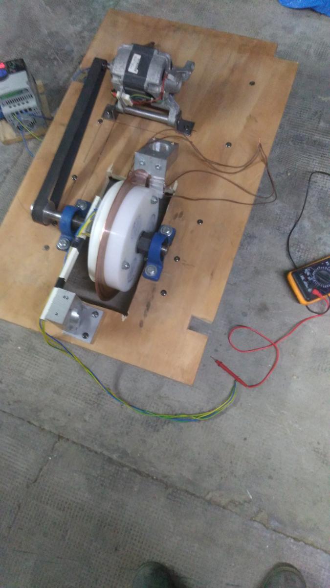

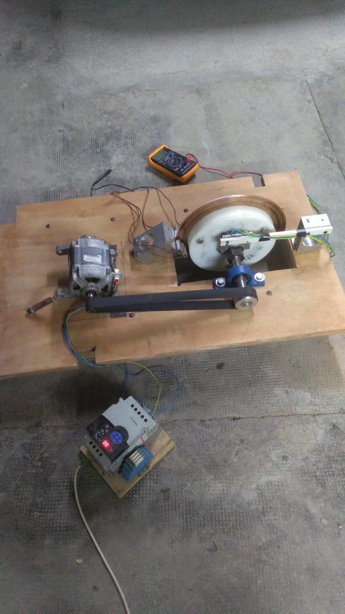

                    • good morning guys, sorry if I allow myself, I know that this is another topic, but I wanted to hear your opinion about it .... I tried to replicate Bruce De Palma's homopolar generator, I used a copper disk with a diameter of 33cm, and 6 cylindrical 52n rare earth magnets measuring 6cm x 3cm, mounted in pairs on both sides of the disc and inserted in those nylons plates that you see in the photos to keep them united and integral with the disc of rotating copper, I turned it into rotation at 2800 rpm, I used 4 carbon brushes on the 2 inch diameter copper shaft and 4 brushes on the periphery of the disc, but the result was very disappointing, as you can see from the photos , not only the very low voltage, but the serious thing is that the amps were almost non-existent, we are talking about 0.2-0.3 amps ..... why? does anyone have an opinion about it or should I conclude that it is another fake ....? Click image for larger version  Name:	P_20211221_175704.jpg Views:	0 Size:	98.1 KB ID:	508590 Click image for larger version  Name:	P_20211221_175719.jpg Views:	0 Size:	85.1 KB ID:	508591 Click image for larger version  Name:	P_20211221_175930.jpg Views:	0 Size:	84.5 KB ID:	508593

                      • good morning guys, sorry if I allow myself, I know that this is another question, but I wanted to hear your opinion about it .... I tried to replicate homopolar generator, I used a copper disk with a diameter of 33cm, and 6 cylindrical 52n rare earth magnets measuring 6cm x 3cm, mounted in pairs on both sides of the disc and inserted in those nylons plates that you see in the photos to keep them united and integral with the disc of rotating copper, I turned it into rotation at 2800 rpm, I used 4 carbon brushes on the 2 inch diameter copper shaft and 4 brushes on the periphery of the disc, but the result was very disappointing, as you can see from the photos , not only the very low voltage, but the serious thing is that the amps were almost non-existent, we are talking about 0.2-0.3 amps ..... why? does anyone have an opinion about it or should I conclude that it is another fake ....?

                        • Originally posted by Memphis View Post
                          Looks like a motor and generator to me. You are welcome here. I never built this one so we will need to see what others know about this project

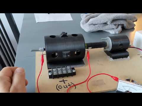

                          • thanks Bro, these are 3 videos about the project
                                Hi Memphis,
                                interesting project. Nice prototype.
                                Are your magnets arranged unipolar or N-S-N-S-N-S around the disc? How thick is the disc? Air gap (distance between magnet faces)?
                                Describe the brushes please. Where did they come from?
