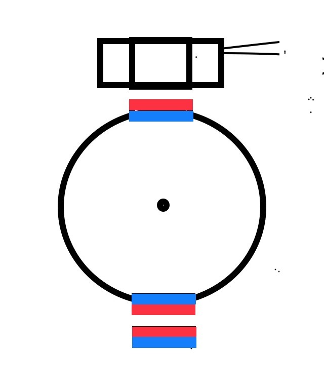

                        • after weeks of considering how to make a rotor, i remembered that i only need a 2 magnet rotor to experiment with the hybrid stator concept in pic 1.

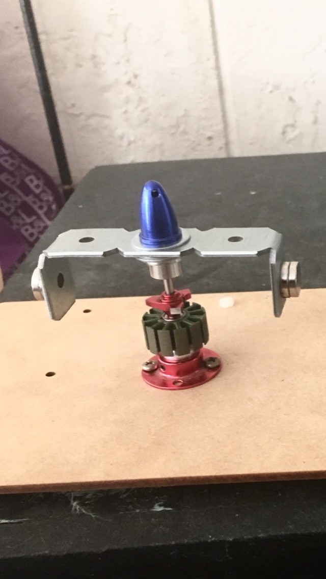

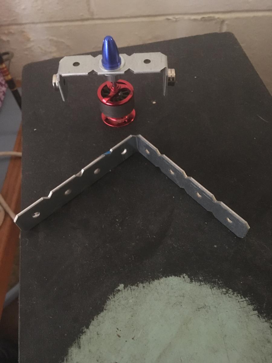

                          i give you the bunnings solution. it looks feasible to have more than 2 magnets and if they got a central hole would be pretty secure bolted on.
                          and that spins free and easy on a RC hobby motor with its integral bearings and the cogging is deleted by removing the neos and the outer drum. pic 3. i can’t upload a video of it.

                          • If this is your rotor I would stay under 1000 rpm's assuming (I can not see) that those magnets have a hole in them and a bolt is used to mount them to this bent piece of metal. Vibration could be quite high. Nice blue motor. Do you have a coil in mind? Here is the proper tolerance for safety. This rotor is good for 400 rpm.
