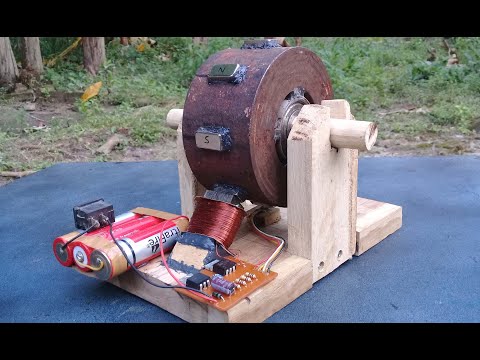

          • it’s alive. it’s just a basic pulse motor at this stage but runs ok. the drive coil has a ferrite core that attracts the rotor magnets on approach then it energises and repels the rotor magnets after tdc.
            me frequency meter says it’s currently topping out at 65 hz so 2 magnet stacks on the rotor makes 32.5 rps x 60=1950 rpm at 12 v input. with a 9 cm diameter that makes 33 km/h at the perimeter/magnets currently.
            i’m thinkin i want a bifilar coil( easier to recycle spike energy), and a larger one than the little choke i got on it.

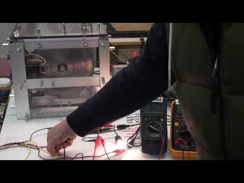

                • Not a perpetual motion device.Only an infinite efficient machine.
                  Also here Thane talk about how output of this generator coil is 400hz and would need to be changed to a 60hz. Yes you would or you would not know how much power you have unit this power can be properly measured with these meters.

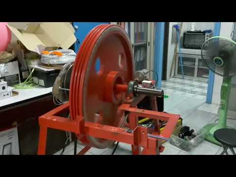

                  • Мы продолжаем следить за автором из Индонезии по созданию ротовертера с маховиком.
                    https://youtu.be/a4tjUN5Cu0U
                    Material and analysis supplemented with new calculations
                    https://rakatskiy.blogspot.com/2021/...ee-energy.html
                    The author reduced the cross-section of the stator iron yoke, reduced the cross-section of the winding wire from 0.5 mm to 0.35 mm in diameter. The main thing is to increase the number of turns of one coil to 100 turns. 16 coils of 100 turns of wire with a diameter of 0.35 mm. Approximate cross-section of the core is 30 x 10 mm, the length of the coil is 80 mm * 100 = 8000 mm (8 meters). 8 meters * 16 coils = 128 meters total phase length Determine the resistance and current capabilities. Phase resistance 128 meters * 0.177 Ohm = 22.66 Ohm. The maximum possible throughput current of the conductor is 0.99 Amperes. The maximum EMF of a phase is 32 volts. We can calculate the possible maximum pulse current. I = E-U / R + r = (32V - 12.3V) / (22.66 Ohm + 0.02 Ohm) = 0.87 A The average current will be half less than 0.87 A * 0.5 = 0.44 A That is, the average phase power for charging battarey with a voltage of 12.3 V will be: W = UI = 12.3V * 0.44A = 5.41W Power consumption of PUSH-PULA at idle speed: P = UI = 12.3 V * 0.492 A = 6.0 W. Conclusion: The author came very close to the equilibrium of the system and the possibility of self-propelled.
