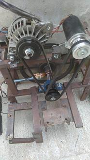

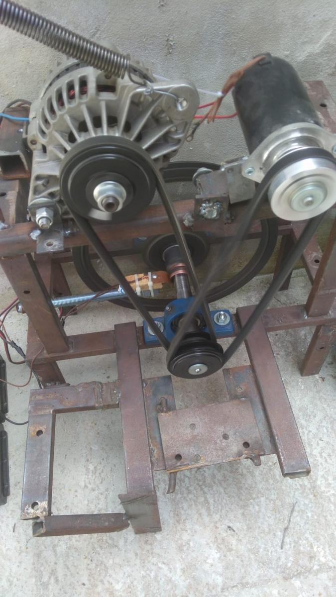

        • Memphis,
          Look at the design of your device. You have a lot of mass that you are trying to accelerate from a dead stop to the full motor rpm. The startup power requirements are too high and your motor does not have enough power to do that quickly, so no electrical circuit is going to fix that.
          The belt and pulley system you have is a power robber. The belts themselves absorb power just from flexing and the shaft bearing side load it takes for those belts to engage the pulleys is high.
          You should to reduce those loads as much as you can (chains and sprockets or toothed belts and pulleys or ?) and use some type of clutch so you can bring your motor up to speed quickly and then slowly apply power to the rotating assembly to get it up to speed.
          A loose motor belt with a tension pulley you can manually engage might do the job, and a small flywheel attached at the motor shaft might help.
          Cadman
          edit: I assumed those are v-belts, it's hard to tell. Regardless, you need to get the motor up to speed and slowly apply power to the rotating assembly.
          • VID-20220528-WA0001.mp4.zip Cadman,
            I know that I have a lot of mass and therefore a lot of inertia at the start, but being the motor from 500w to 24v, and having calibrated the pulleys in a suitable way, it has no difficulty in picking up the motor speed, also because in the initial part of the start the alternator is disconnected and therefore the effort is minimal, within the reach of that motor (which for skeptics is a 24v - 500watt- brushless) Instead of carbon brushes I have now used a thin copper rubbing plate which seems to go better. The problem is that now, since it was a motor not for continuous duty, but max 5 minutes, during the various tests it overheated and now it no longer shows signs of life, it must probably be the electronic circuit that controls the reversal of the magnetic field. of the brushless, I will try to repair it otherwise I will take another one, but this time for continuous service.

              • That thing is banging. OMG and losing or wasting power from all the friction. Cadman is right a slipping the pulley for start up. Regardless of the name plate of the motor you are calling your motor, brushless, and yet it runs straight off the battery. That don't make sense.
                A brushless dc motor has 3 wires or 3 phases and a sensor. You have 2 wires so it is not a conventional brushless motor.
                It strikes me as a starter motor and you removed the rotor winding and brushes. When you removed the rotor windings was it like the alternator winding? This will help us to determine what motor you have without a name plate.

                            It does not appear to be a BLDC nor have any information on the label stating that. The website for Hydronit does not mention the use of BLDC and products pictured there appear to be typical brush DC motors.
                            To operate your motor, you simply hook up 2 wires to the battery, correct? That is a big clue that it is a brush type DC motor. A brushless motor (BLDC) with 2 wires would need an electronic controller inside the motor housing. That is seldom done in the size and type of motor you have, a hydraulic pump drive unit for automotive/truck/industrial applications.
                            The nameplate indicates that motor is rated for intermittent duty of 5 minutes or 15% on-time which is unlikely to stabilize thermally at any continuous load.
                            • I am mistaken, they sold me the motor as brushless, but now that I have disassembled it I have been able to see that it is actually a permanent magnet motor mounted on the stator, now I will look for the fault, otherwise I will take one truly brushless three-phase together with a wpm regulator and I solve the problem.
