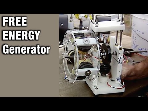

        in the down time I have been testing the coil output with rotors on BOTH ends of the coil. The output is DIFFERENT, as are the operating electronics. If I ever build another setup, it will be….
        Plate with adjustable opposition magnets - rotor - six coils - rotor six coils - rotor - plate with opposition magnets. It can be run as just a generator or as a motor and generator at the same time. If run as motor and generator at the same time, you don’t need the opposition magnets, so that’s probably the best use of resources.

          It sure is nice to gawk at such a pretty piece of plastic. Isn't that amazing what money can buy? I'm jealous. That is the most precision rotor and box you have had yet. This new guy did you right.
          What is the output per coil of the dually? 100w , 200w or haven't you got that far yet?
          How can you do away with all those extra magnets? huh?
          • The previous rotor was 1 3/4" thick. We drilled a 5/8 hole all the way through the rotor. Then on each side of the rotor we widened that hole to 3/4" diameter, but only drilled the new holes 3/4" deep. That left a 1/4" thick piece of plastic in the middle that only had a 5/8" diameter hole drilled in it. A 5/8 x 1/4" magnet was placed in this smaller hole and a 3/4 x 3/4" magnet was put on each side of it. All three magnets were magnetically connected to each other, so none could be easily removed from the rotor, and they certainly didn't come out just from spinning it. To remove one of the 3/4 by 3/4 magnets, you have to break its bond with the 5/8" magnet, which could easily be pulled out of its hole, except that it is attached to the other 3/4" diameter magnet on the OTHER side that you can't pull through the 5/8 hole.
            The new rotor has a single 1" x 1" magnet in a 1" thick rotor. Magnets are glued in, and held in place by a set screw. Far fewer magnets. 1/3 to be exact. But 1" x 1" instead of 3/4 x 3/4. Not as secure as the other method, but since the magnet will be attracted to cores on BOTH sides of it, I am hoping it will remain in place and not come out.
