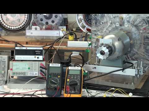

    • thanks Bistander, the magnets are arranged to attract each other, NS NS NS with the 2.5mm thick copper disc in the middle, I tried to rotate the disc at both 1400rpm and 2800rpm, but the result is almost the same , the increase is minimal.
      • Bro, from the video it seems to me that the meter is set to amps, it is only 0.5A

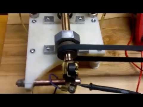

            https://youtu.be/kSRMORAoY8k
            That's a pretty neat 12 pole synchronous PMAC dynamo. Memphis is working with a Faraday disc, homopolar, DC dynamo. Note the multipolar unit rotates the magnets adjacent to the stationary copper disc. Memphis rotates both the magnets and copper disc, essentially having no stator, except for the brushes.
            Faraday's Paradox. Interesting. Look it up.

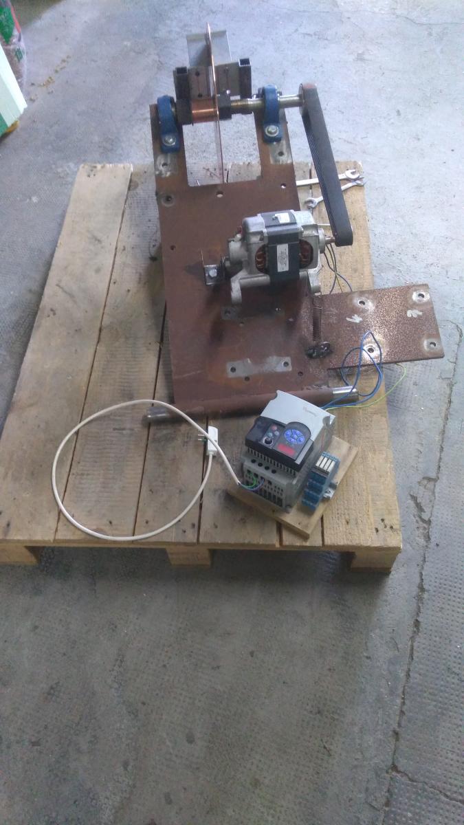

            • P_20211127_121027.jpg P_20211201_171047.jpg I also tried to spin only the copper disc, putting a single pair of fixed magnets, on aluminum supports, but the motor is not there because an excessive braking force is generated, obviously a Lenz reaction is generated. even at very low revolutions, trying to rotate the disc with your hands you feel a strong resistance. I also tried to offset the magnets, but there is always resistance, even if a little less.

                Hi Memphis,
                Yep, with those set-ups you make an eddy current brake. To get the unipolar (or homopolar) DC generator you need a 'uniform' magnetic field covering the entire disc area.

                  • Thanks Bistander, ... so to work the homopolar generator the magnets must remain fixed or turn with the copper disk? ... I saw that in the De Palma experiment the machine built by them had the magnets on the rotor together with the disk of copper, and they were all spinning together, and that's what I tried to replicate but without useful results, nothing to do with the De Palma generator.There are 4 brushes for each pole, of the carbon type which are used for electric wheels measuring 16x6mm.
                    • Originally posted by Memphis View Post
                      " so to work the homopolar generator the magnets must remain fixed or turn with the copper disk?"
                      Yes.
                      First you need to generate voltage. Requires complete flux coverage, uniform and unidirectional, over copper disc.
                      To get high current, you need very low resistance electric circuit. Carbon brushes offer too high resistance. Use very low resistance everywhere. Brushes especially. Try straight copper metal at first. Will be low resistance but poor wear. Once working look into high copper content metal graphite brushes.

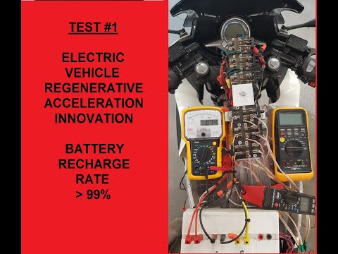

                      • Driving Time Duration = 16 minutes. Ebike Speed = 29 km/hr EV "distance travelled" = approximately 7.7 km. INITIAL EV battery voltage = 74 Volts FINAL EV battery voltage = 73.9 Volts Battery Voltage Consumption = 1 mV Ebike Recharge Rate = 99%
                        Normally the ebike's battery voltage always drops slowly even in Regenerative Acceleration Mode - due to generator coil core losses.
                        However the ideal combination of ReGen-X Quantum Motor coils and ReGenX Generator coils produced a solid 16 minutes of continuous running at 29 km/hr and the battery voltage did not drop and stayed at 67 Volts and it looked like it was going to increase to 68 Volts.
                        It took me 10 minutes of waiting to see what the battery voltage would do before I realized I ought to pick up the video camera and record what was going on...
                        • Fake news BroMickeyLier:
                          In the 6 minutes of the video, the battery goes down from 67.0 to 66.5V. And the 10.5A on the amp meter is the charging current to the battery. Thanes conveniently doesn't measure what the current from the battery to the motor is. This is a very easy measurement to do and should immediately show if the battery charges or discharges overall.
                          And btw this is an old video that was already commented on extensively by bistander and myself.
                          Happy New Year. Hopefully next year you will post some true stories. Have you considered going to work for the fake media?
                            Whose math is that? Initial minus final = 74V - 73.9V = 0.1V drop = 100mV less than what he started with. What is "1 mV? What is 99%? Nothing recharged. The 74 & 73.9V must be battery open circuit potential figures. During the wheel spinning the meter was reading 67.7V. Note 67.7V is less than battery open circuit voltage (74V), so the battery is discharging at 10.4A. So for his 16 minute air ride he used about 3 Ah. If it had a 30 Ah battery, then 10% of the charge was consumed spinning the wheel in air. Zero kilometers traveled. All energy was wasted. No recharge occurred.
                            BS. It was not "running at 29 km/hr". It was stationary. Zero km/hr. And he switched meter scales midway thru the 6 minutes to show 3 significant digits. During the last half of the vid you can see the meter reading fall from 67.7 down to 67.5V. A few 67.4 figures flicker towards the end.
                            Why doesn't he put it on the road. It's only been like what? 4 years? Or at minimum, put the rear wheel on a load Dyno to get realistic load currents. And get some reasonable travel speeds. Who wants a 29km/hr motorbike?
                            But I guess that is the point. Thane, like Turion will never do a legitimate public test because they both know they've got nothing but lies.
