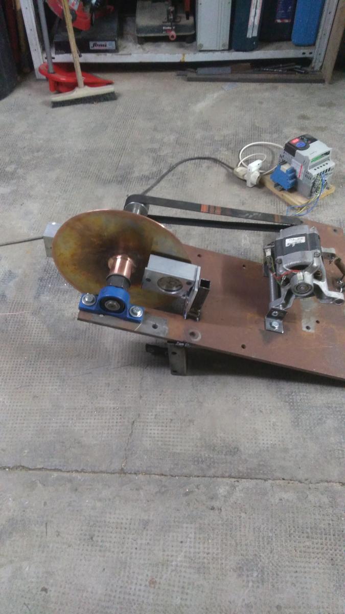

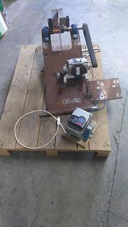

    Originally posted by Memphis View Post
    [a Lenz reaction is generated. even at very low revolutions, trying to rotate the disc with your hands you feel a strong resistance. I also tried to offset the magnets, but there is always resistance, even if a little less.
ID:	508628 Click image for larger version
ID:	508629 I also tried to spin only the copper disc, putting a single pair of fixed magnets, on aluminum supports, but the motor is not there because an excessive braking force is generated, obviously a Lenz reaction is generated. even at very low revolutions, trying to rotate the disc with your hands you feel a strong resistance. I also tried to offset the magnets, but there is always resistance, even if a little less.
    Hi Memphis,
    Yep, with those set-ups you make an eddy current brake. To get the unipolar (or homopolar) DC generator you need a 'uniform' magnetic field covering the entire disc area.
  • Memphis
