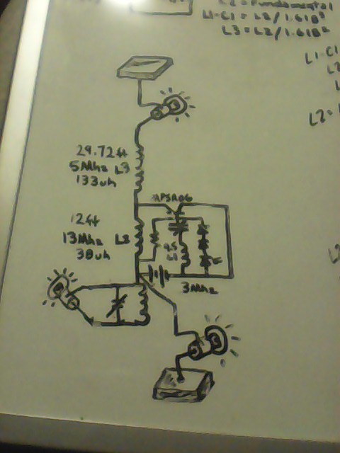

    Relating to the single wire energy.... kind of a cross between Dr. Stiffler and Mr. Dollard with a frequency differential of Phi....
    The coils are wound on a 2.5" PVC tube ( 2.7 od ), pretty quick and simple nothing elaborate...
    This one will light 4 watt 120 volt bulbs off the ends and a low voltage bulb on the tank - input requirement is 30-50ma at 12 volt - bulbs are not super bright but it's a great learning tool without a lot of expense or time.
    Also a video I posted some years back of a single wire to a standard junction box with an aluminum block as the capacitive storage https://www.youtube.com/watch?v=864FTN-KeQg

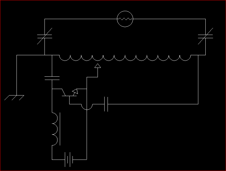

    Relating to the hairpin, a circuit I played with in the past with some interesting results...
    The main power circuit (battery circuit) is isolated from the resonant coil so it can be made to operate quite efficiently. The resonant circuit functions on the radiant impulse generated when the transistor is turned off.
    Timing is taken from the high side of the resonant coil which presents a problem and needs to be controlled to some degree. The transistor is an MJE18008 which is rated at 8 amps - 1000 volts and handles it fairly well. I've run the high side well over 2000 volts without any major problems.
    I use a pair of air variable 2000 volt 1000pf caps to adjust the load. The high side adjusts voltage, low side adjusts current. Both have to be set to the lowest capacitance to start the system then adjusted for maximum current/voltage through the bulb.
    The resonant coil is made using bare copper wire - no magnet wire or PVC insulation - 80 turns 15ga on a 3" form wound as a bifilar using rope or string that is about the same width as the wire. The rope simply insulates the windings and maintains proper spacing. The bare wire allows for tuning adjustments. The impulse cap can be experimented with, start with a 0.1uf the timing cap in the range of 250-400pf depending on ending variables - lower is better - adjustable caps are helpful to control current into the base of the transistor. As current builds up in the resonant coil so does the current on the base
    The impulse coil is 40 turns of 20ga magnet wire wound on a 3/8" x 4" ferrite rod. Good earth ground is a must.
    I'm sure there are things I've forgotten and/or take for granted as general knowledge. Lastly, this is NOT overunity, it simply takes advantage of existing ground currents.

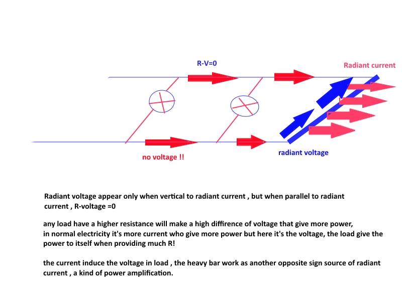

    just an idea about hairpin circuit , i think it can be understood when thinking about the real geometry of cold electricity !

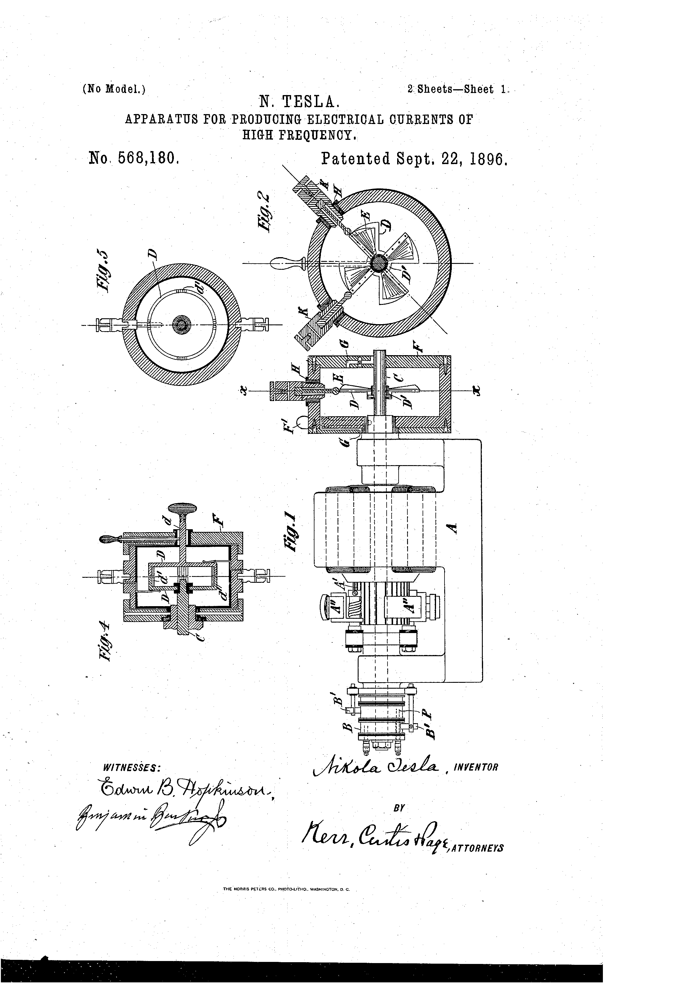

    Fascinating circuit, fascinating concept. Concepts which can and have been expanded on, by the inventor himself or one with the proper understanding. One such advancement was provided by the inventor himself, it can be viewed here:
    http://patentimages.storage.googleap...US568180-0.png
    With this second image I am reminded of the apparatus depicted in the "Apparatus and Method of Conversion". The AC/DC machine.....
    This is an important topic, I hope you all dig as deep as you can. I found a few of my answers after it was understood that the hairpin and variants on that concept had a practical application in electromechanical devices, didn't have to contemplate long, its in black and white....
