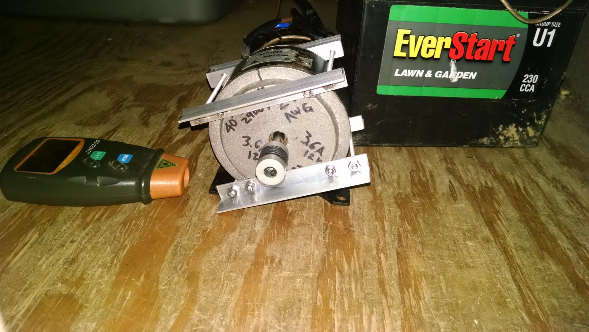

    desa, et all,
    I took the 4 bolts out and drilled through the screw holes with a drill slightly smaller than the thread ID. Then from the back, I drilled out the small hole down to the threads with a drill slightly larger than the bolt threads. Then I screwed new bolts from the inside out the back so that I could attach bars across the back that allow all-thread to span from front to back to hold the motor together. (see pic) If not tightened, it allows a very wide range of adjustment.
    My motor with 40' of 30AWG on each side runs great between 3014 rpm at 1.25A to 5095 rpm at 5A. I didn't push it beyond that.
    I also needed to get the coils away from the bearing on the other motor after winding it. I found that using 24AWG magnet wire to tie it back, worked great. (see pic)
    These are great little motors.
    Enjoy,
    Bob

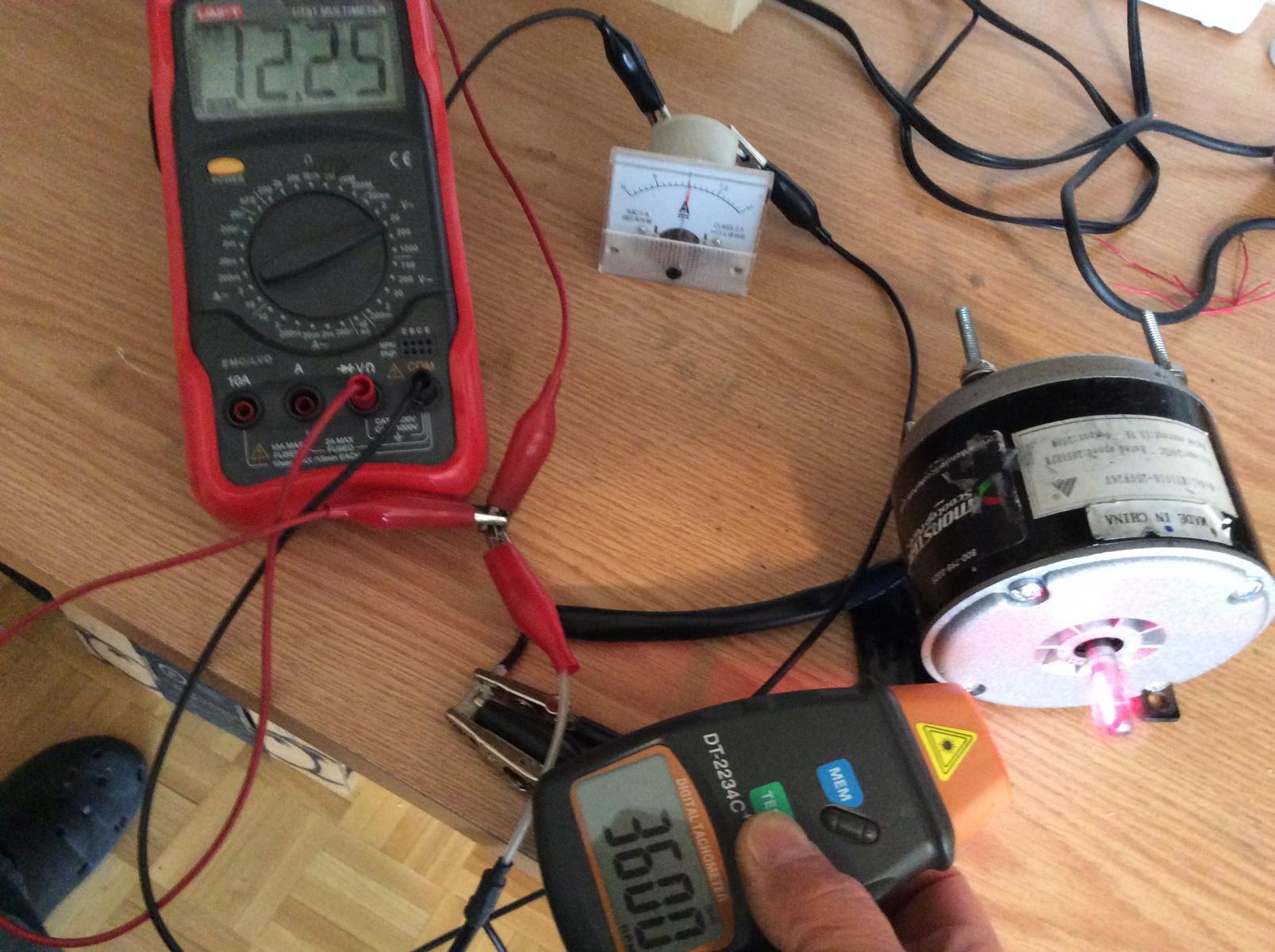

    Here is little update on the motor.. As the brushes settle on the commutator amps drow is also settling down. At present it runs happily at 12.22 W. 300 mili amps less than my best run before. Only missing component is my batteries and that is coming soon. Thank you all for sharing. Wistiti that is fantastic, happy for you.

  • desa
    replied
    Yes Matt.
    At 12.7V and 1.3A it is 3600 rpm. This puppy paks some tork. As I loade it by hand it is inposible to stop. All I manage to bring it up the amps to 1.7 before my hand starts to burn.
    Thank you very much.
    David.
