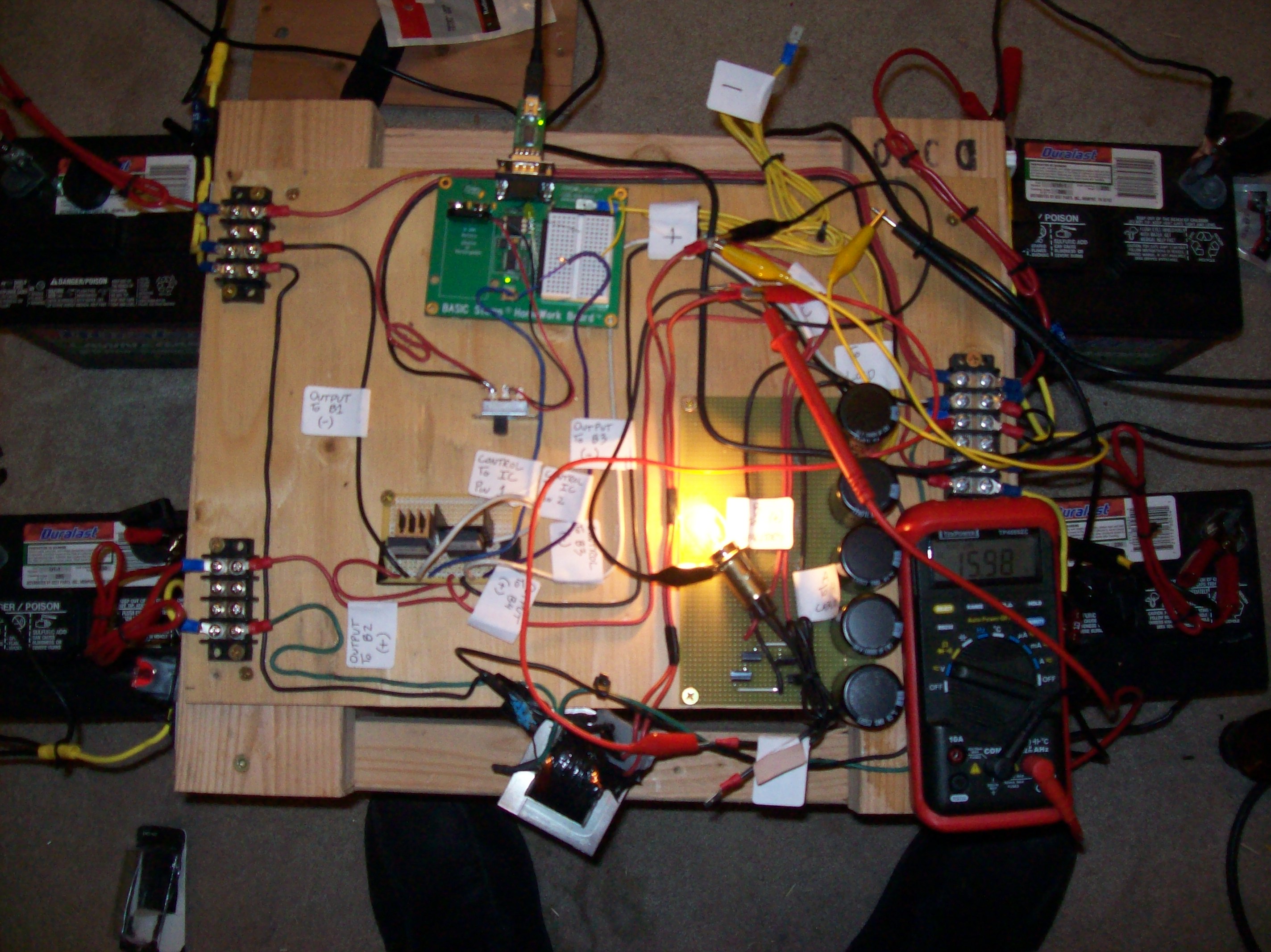

    Yay!
    Good news!
    I got my switch up and running. I put some heat sinks on my chips and am running 10 amp fuses. It wasn't really neccesary though because the chips aren't even getting warm. The only time the 5 amp fuses were blowing was during the safety testing and I had 2 second long pulsewidths.
    Anyways so nowI get the best voltage out of the transformer at a pulseout of 5100- which is 10,200 microseconds or about 10 milliseconds. Is this in the ballpark of what everyone else is getting?
    Secondly, The AC voltage I'm getting out of the battery is about 17 volts with no load connected. At first I thought it would be higher because you get 12 volt peaks in each direction so I figured AC would be around 24 volts or more considering the output winding is 20% longer. But then I remembered meters don't measure peak to peak they measure RMS so 17 sounds about right. Is that what you guys are getting too?
    I have yet to actually start load testing times, but will start that soon. Attached is a pic of my setup

    Finished build, now troubleshooting
    Hi Caroll,
    I finished my build of the tesla switch as per matt's specs in the pdf. I performed all the preliminary tests on the safety check list of the pdf and passed fine. The switches are working perfectly with the stamp and I have continuity at all points I am supposed to. I put 5 amp fuses on the negative side of all 4 batteries, that's the max current my ssr's are supposed to have. The problem is as soon as I hook up the transformer, the fuses for the bottom two batteries blow pretty quickly. I've already checked for a short in the windings and I don't have one. The windings each have about a half ohm of resistance so for 12 volts running through there I see why the fuses are blowing. What would you suggest?
    Thanks for your help!
