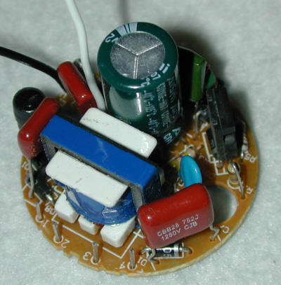

          now I am use capacitors obtained from CFL ballast .
          4 * 1250 v = 5000 v with total 1.3 nF for L1 coil

                    • Originally posted by Eng.raied View Post
                      You're right
                      [ATTACH]11254[/ATTACH]
                      I am using capacitors with selfhealing, in devices i am working on it is important factor. pls check it. hope i will help you to choose a good one.
                      http://www.epcos.com/web/generator/W...nformation.pdf
                      Maximum peak current
                      = C (du/dt)max
