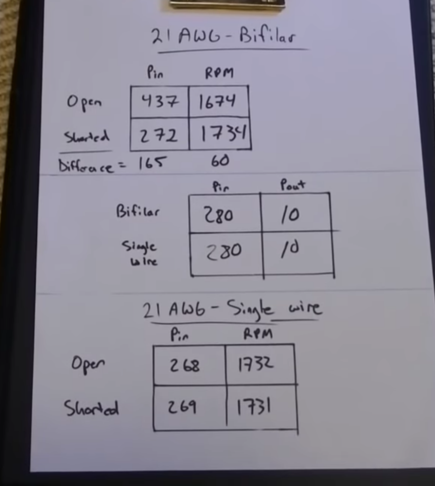

              Debunker proves you wrong.
              Input required for bifilar coil is 437 watts.
              Input required for standard coil is 268 watts.
              Both at no load (disconnected) just prior to delivering equivalent load (10 watts).
              169 watts extra is required to drive the generator when the bifilar coil is on the core compared to the standard coil on the core, both coils disconnected. But when loaded to the same output, both coils require the same input power (280watts).
              The bifilar (or RegenX) coil performs no better that the standard coil when under the same load.
              When the bifilar (or RegenX) coil runs disconnected it causes extra power to be drawn. This extra power ceases when the load is connected.
              That extra power when disconnected is a prime example of why it is invalid to call equilibrium "zero" for any power or efficiency calculations. Contrary to your make-believe reference, there is no EE standard or procedure using such convoluted logic.
              The fact that a bifilar coil exhibits this peculiar behavior is due to the higher than normal inductance of the windings causing a resonance at certain frequencies. It won't develop any extra useful power. Rather it has shown to be quite wasteful of power in certain conditions.
              Regardless of what type of coil windings are used, machine efficiency is always ( useful real power out) / (total power in). And that ratio never exceeds unity. Look it up in the EE handbook.

                • Were we not speaking about the performance of the coil? The post from you has nothing to do with coils.
                  You make claims about coil performance. Back it up. You say you have tests. Show it, clearly with tabulated results/data as done in the debunker video.
