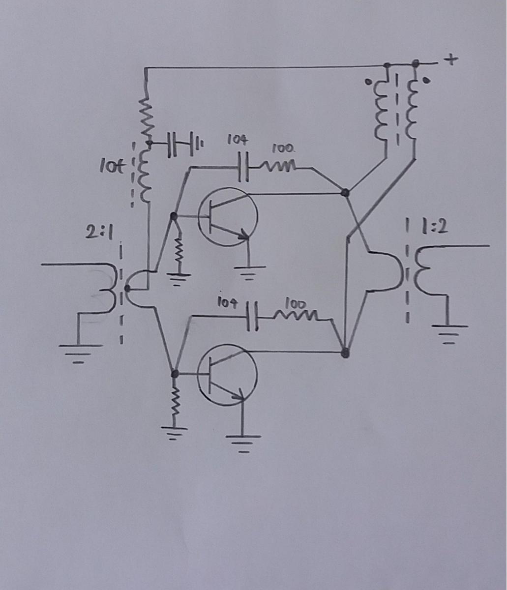

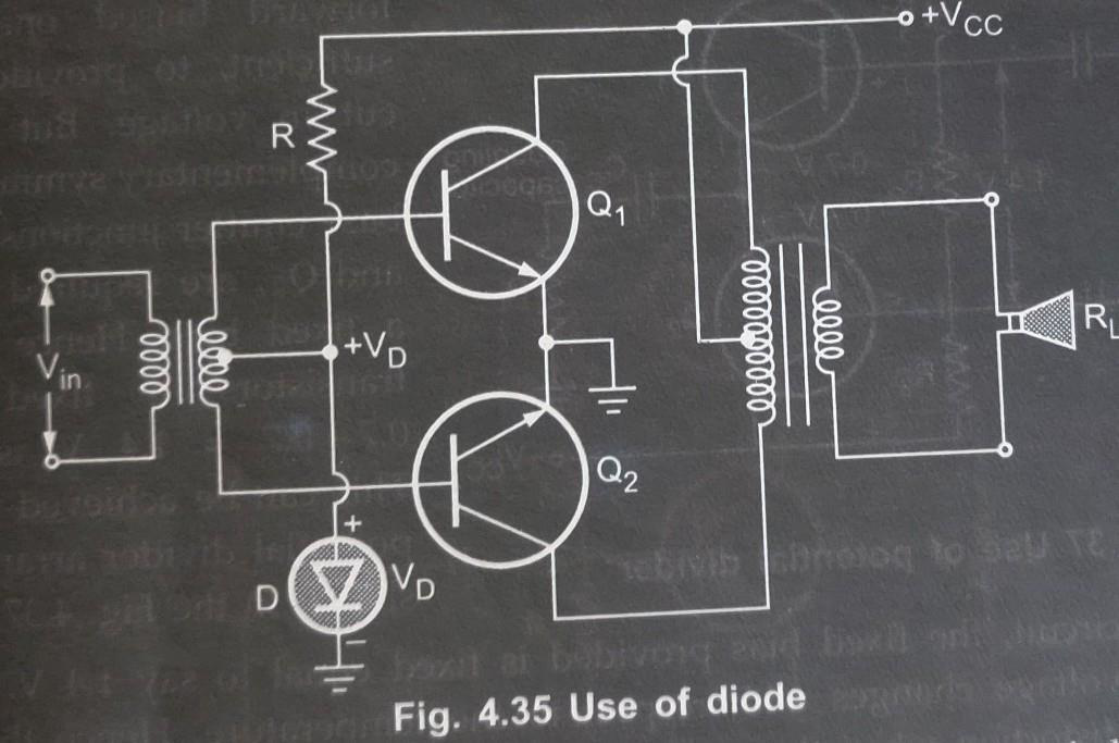

as far as the transistors being connected to half of the output transformer,
yes, that is how they are doing it,
the one transistor gets the top of the output wave and the other transistor gets the bottom of the wave.
you need to bias them so that the transition near 0V is clean and not glitched.
is that what you were asking ?
I can answer questions for a long time, so ask away.
feel free to copy and paste questions if I missed something (and I likely did miss something)
