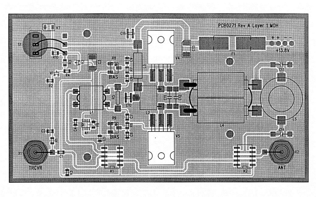

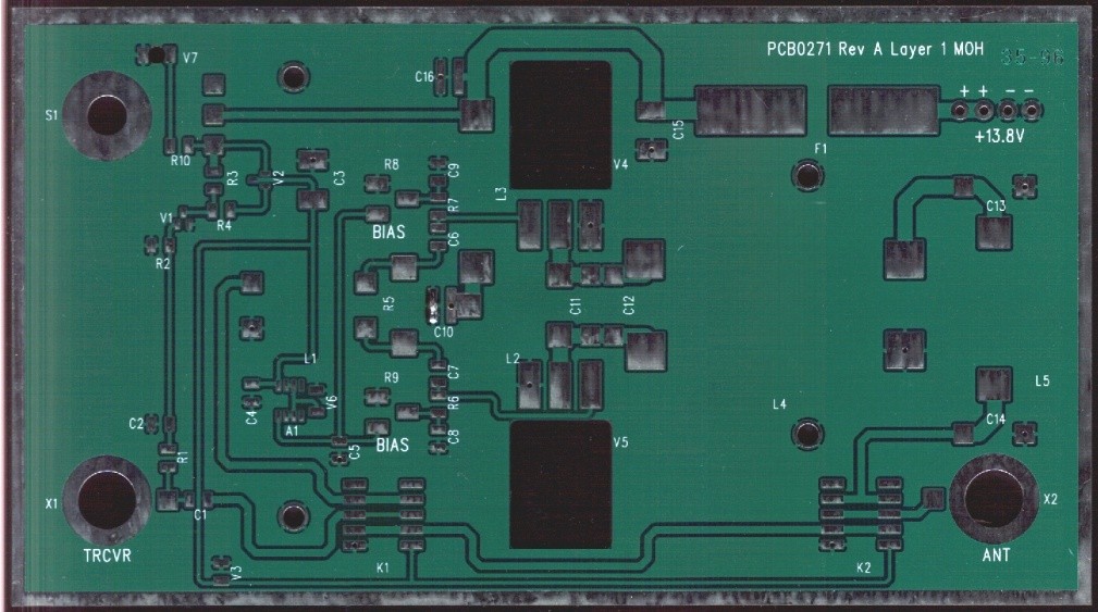

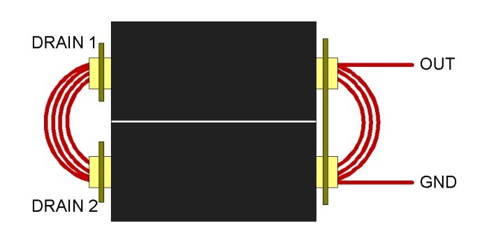

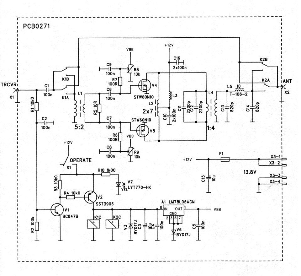

        here is one example.
        filters and setup/tuning are also needed to complete this, but I want to know if this makes sense to you so far.
        and you can change the mosfets for ones you like if you are running lower power.
        what kind of source are you driving this with ? (power level and impedance would be handy info)
        this setup is assuming that you are needing it to turn off to receive. if you are transmitting only then it can be simpler.
        I got this off of the web somewhere I forgot, so sorry for not identifying my source.

          I know this design. I have it. It does make sense but I would take the relays out and the two transistors leaving only the IC. I hate relays and transistors in these designs. It complicates the schematic and I'am not planning to become a radioamateur.

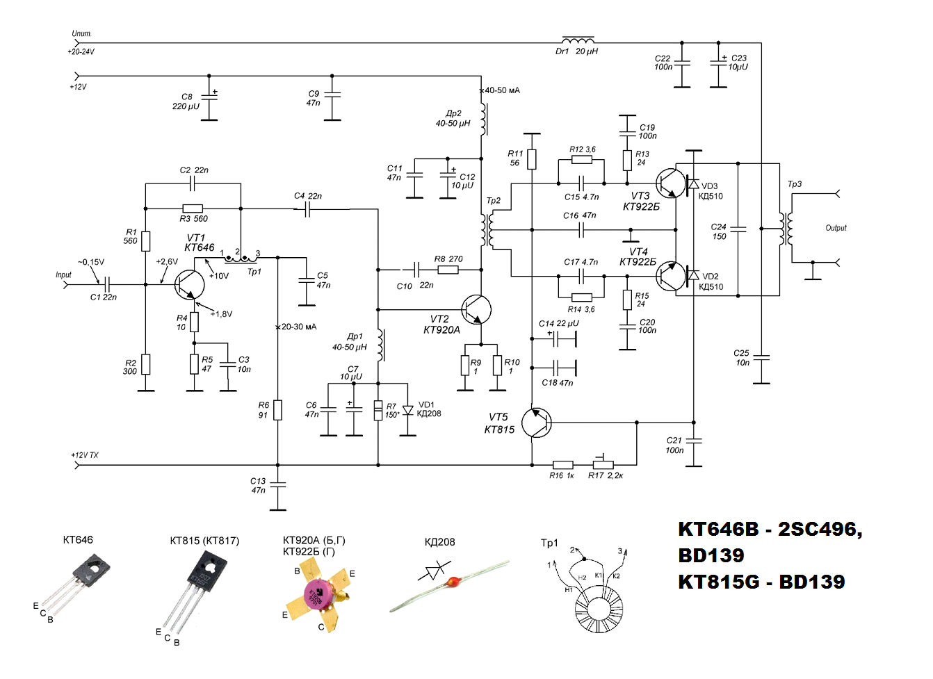

          To drive this I have a signal generator with a maximum of 20Vpp. I will build an amplifier from a russian schematic. This amplifier gives few watts (3-5W).
          Here is the schematic diagram. I'am referring only to the first half. It's power transistor is a 2T920A or KT920A. 5W Should be enough for many amplifiers. The one in my image can be supplied with a voltage of 0.1 to 0.3Vpp. It is very sensitive. I just tested it on the oscilloscope and it sure can amplify all the way to 24MHz, only that my oscilloscope can go as far as 20MHz so the measurement is quite unreliable to say the least. Clean sine wave, that is my point.

                the schematic and transistor you posted is a regular transistor and not a mosfet,
                the impeadance of them is much harder to figure out, and the circuitry to drive them is more complex.
                and you need multiple stages of amplification to get to your final power.

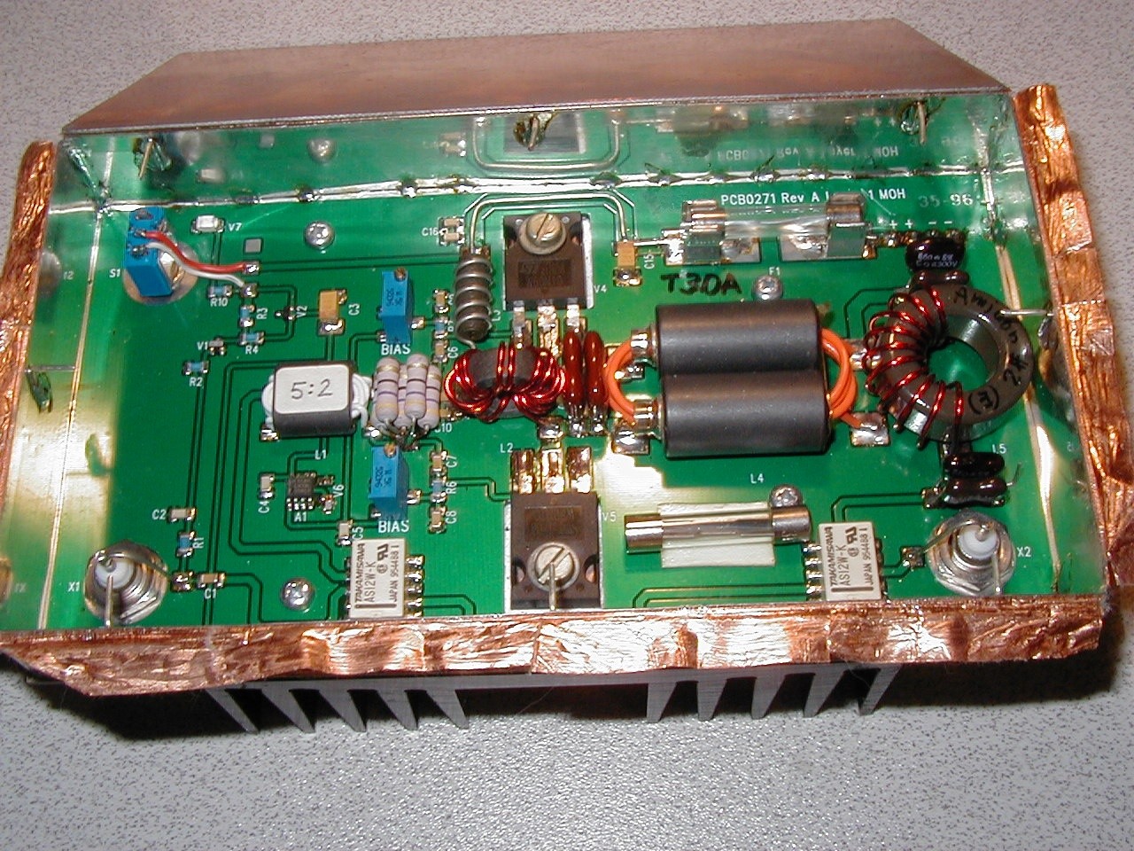

                    I have used the formula for Capacitive reactance. The calculations make sense indeed. For a certain amplifier, the output transformer ratio is good. It is broadband really. I have already built it. Let me show you:
                    Tomorrow I shall take a look at the input ratio as well.

                      Concerning the above design, the ratios for the input and output transformers are as specified in the design papers.
                      Zin= 1/2pi*14,350,000Hz*0.000.000.0028F= 1/0.252= 3.97Ohm| sqr(50Ohm/3.97Ohm)= 3.55 so 4:1 ratio
                      Zout= 1/2pi*14,350,000Hz*0.000.000.000.78F= 1/0.07= 14.28| sqr(50Ohm/14.28)= 1.87 so 1:2 ratio
                      This is because the amplifier was design to work in the 20m band.
