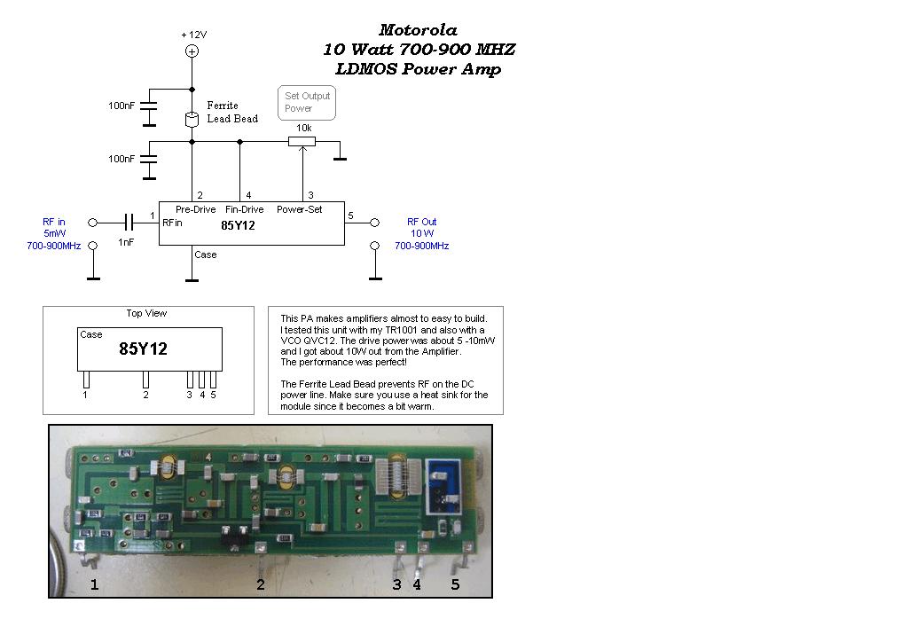

    Gary
    Do not connect the voltage/ power controller as shown in the schematic for that power amp of Motorola. You have to use a Voltage control chip LM317 and RF decoupling of a choke and two caps, one 100mf electrolytic and the other 100nf ceramic, the choke anything from 10mH to 100mH.
    Mike
    Leave a comment:
  • Michael John Nunnerley
    replied
    Hi Gary
    I will try to answer your questions
    1 The PCB is bouble sided and the ground plain is the bottom but also the parts not used on the top side, try looking up PCB design for RF on the net
    2 If you are using Two VCO's then I suggest you use two PCB's, if only one VCO and a trippler and doubler for the other frequency then you could use one board with decoupling on the power lines etc.
    3 yes
    4 top of PCB and linked with various holes through the board to the ground plane
    5 Yes 50 ohm coax if you have VCO and amp as N or BNC etc type connectors. If you have surface PCB mounting then the connections would have to be 50 ohm stripline on the PCB.
    6 Look at 5, ref 50 ohm strip line
    7 I have not had time to look at the data sheet
    8 Yes choke and capacitor RF decoupling on the positive side
    9 Coax at wave lengths is normal practice but if you have a good VSWR then there should be no radiation from the coax, it can be as short as you like.
    10 Wideband SWR meter
    11 Does not matter the length as said before.
    12 You should keep the output the same on both frequencies eg. 10w + 10w
    Mike
