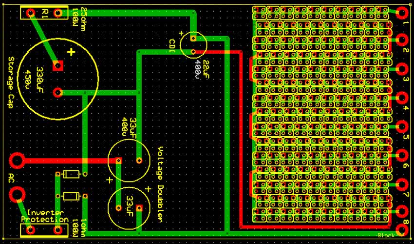

                      • Hi Guys,
                        I am designing a Vexus PCB and have taken many of the different ideas and combined them. Here is my current layout. Any recommendations or advice is greatly welcomed.
                        It may be a little hard to tell what all is on the board so I will try and describe it:
                        First there is 80K volt protection. Each diode has a 500k ohm resistor to prevent cascading failure should a diode go bad.
                        There is a 1 ohm 100w Caddock resister to protect the inverter. Also R1 is a Caddock resister. This will require either a large heat sink or use of a metal case with the resistors mounted to it.
                        Not shown in this revision is the ability to use different CDI caps (C1). My latest revision has holes for a 10, 22, 33, or 47uF cap.
                        I was also thinking of having the option of either a voltage doubler or quadrupler.
                        Once concern that I have is the voltage drop across all the diodes.
                        So what do you think?
