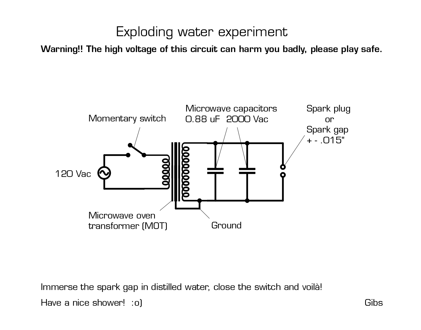

From what I see it looks like you are very close to have this working, very impressive.
If you don't mind I would like to present some questions and comments regarding issues presented in some of the latter posts.
Are you using fast recovery diodes, this is important especially for the bridge to have fast transient response.
If charging speed is an issue why not use a cap per spark plug with its own isolation charging diode off the bridge
Is the isolation trasformer just to keep the inverter isolated from the hi voltage section or is it being used as a common mode choke, the drawing is not clear on that. A toroidal common mode choke would greatly reduce transients from backing up to the inverter while still providing the current needs of the charging circuit.
Have you concidered using transistors or FET's to switch the plasma phase of the arc?
Would a custom sparkplug with two isolated (from the chassis) electrodes be useful in controlling the plasma arc to a higher degree?
Just throwing some ideas around. If I am way off base tell me and i will cool my jets
