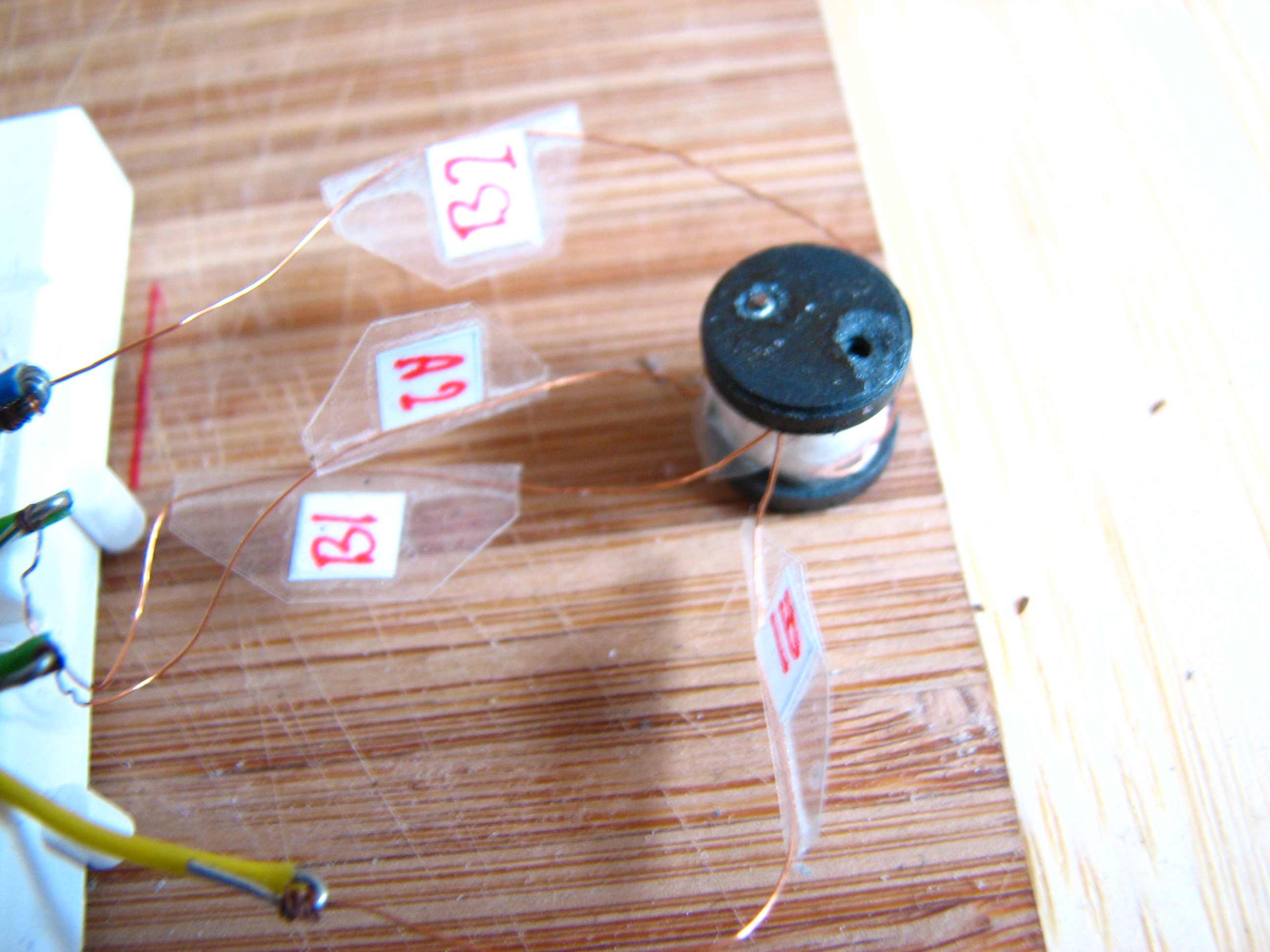

        And how many turns and what diameter wire did you put onto the PVC tube in the middle? Is that your L3?
        the core of the conrad spool is about 1.5mm, and my tube is about 1.3mm so i just placed enough turns on it to fit in the conrad spool core (i cant really remember how many turns but i think its about 100/200turns mayb even 300) the thickness looks like 0.2mm, or 0.25mm (i got it out of an old adaptor)
        for L4 (joule thief, the mini inverter) i used the 0.20 and 0.15mm
        on a 1cm high ferrite core, core is about 3mm, and i used about 46 turns to make it full (and i think inverters mostly use about 20/30 turns right ?)
        i hope that i gave you enough info

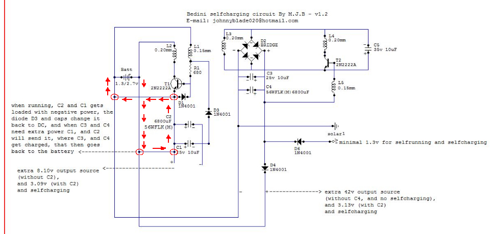

        • selfcharging Bedini works - new circuit
          Hi All,
          My Sphere has been doing good on my new circuit.
          it an selfcharging and it works. i started this morning on 1.3v and solar
          after 3 hours my battery of 1.30v was 1.37v (but thing is, you must disconnect your mutlimeter for it to work best)
          i cant measure the amps while it runs on solar and 1.3v battery(my multimeter draws to much amps whereby my sphere stops to turn)
          but i gues its about 2ma or 3ma
          im also now using the the extra negative source from C2 and C1, to charge the caps C3 and C4 with converted negative power (is this Radiant energy ?)
          when the amps gets to low on the caps C3, C4 the caps C2, C1 will charge the caps C3 and C4.
          when there is no source or solar to run the sphere it will run itself, for about 6 seconds
          the solar also helps to load up the caps C3 and C4
          wihout selfcharging, the voltage on caps C3 and C4 is about 40 to 42v
          on the extra negative source caps C1, C2 there is a voltage of about 8.04v
          i have added my circuit, and sofare it works
          but remember to disconnect your multimeters cause that will make it hot charge in a way, when no meter(s) it connected it will charge in pulses
          also dont run any test LEDS on your circuit, when running on low amps
          cause it will really slow down the loading process, and the sphere does turn slower
          ill be makin a vid and some pictures with all kinds of measurement tests
          but for now i can only show you my circuit that im using now and that works for me
          the coil of L4 and L5 is 47turns of 0.20mm and 0.15mm on a small ferrite bead, and its acting as a small voltage amplifier

            • Hi All,
              @Xenomorph: thnx for the notice of my circuit whereby i did not draw the line good enough, so changed the line so it will be better to show.
              but sofare im using the negative wire and hooking up things in series thats makes it positive in the end
              below is the correction circuit

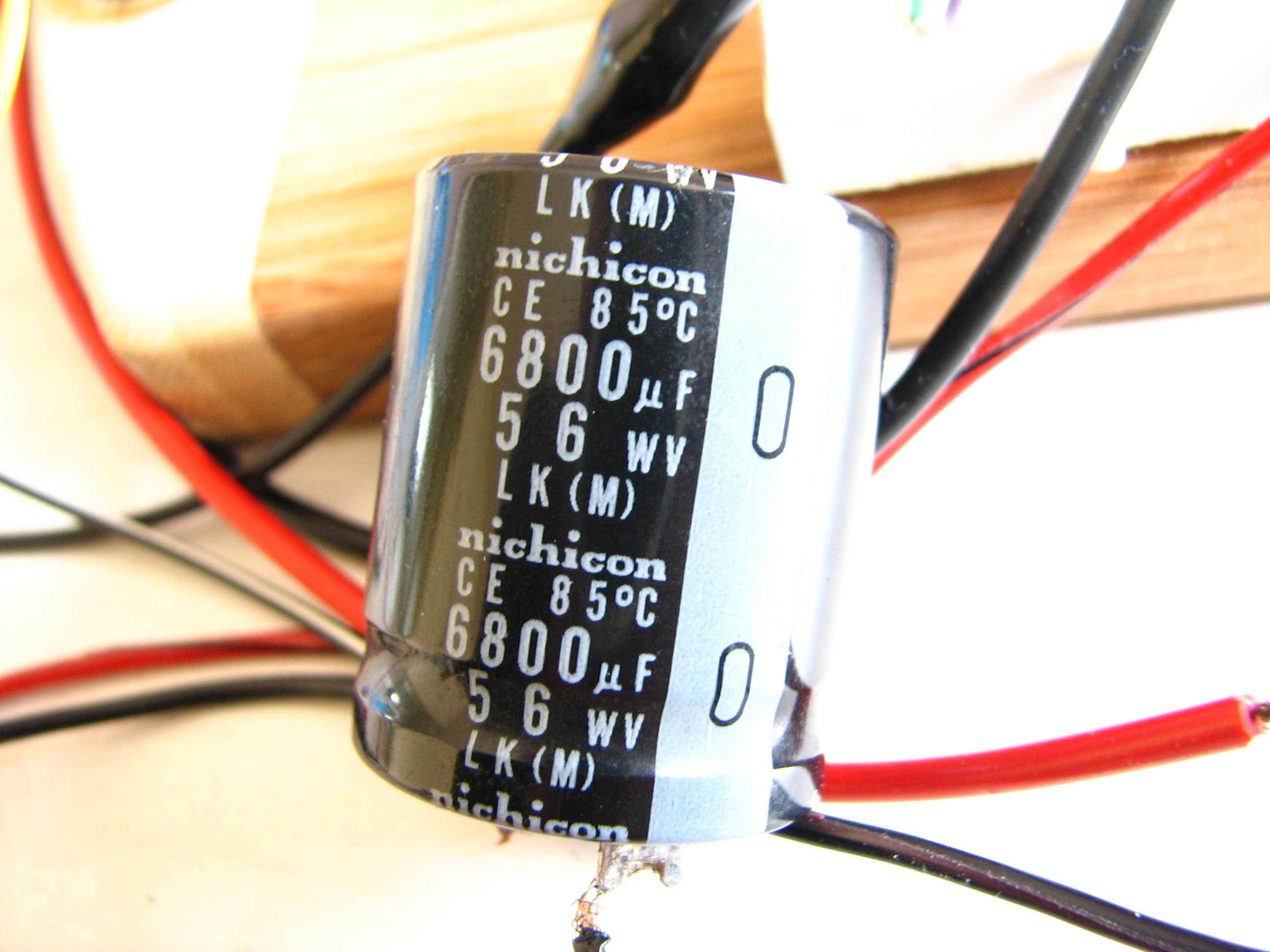

                  Can you tell me what voltage that 6800 uF cap has.
                  All my 4000+ uF caps are huge, i have not seen such a cap on your board anywhere. I wonder what model that is?

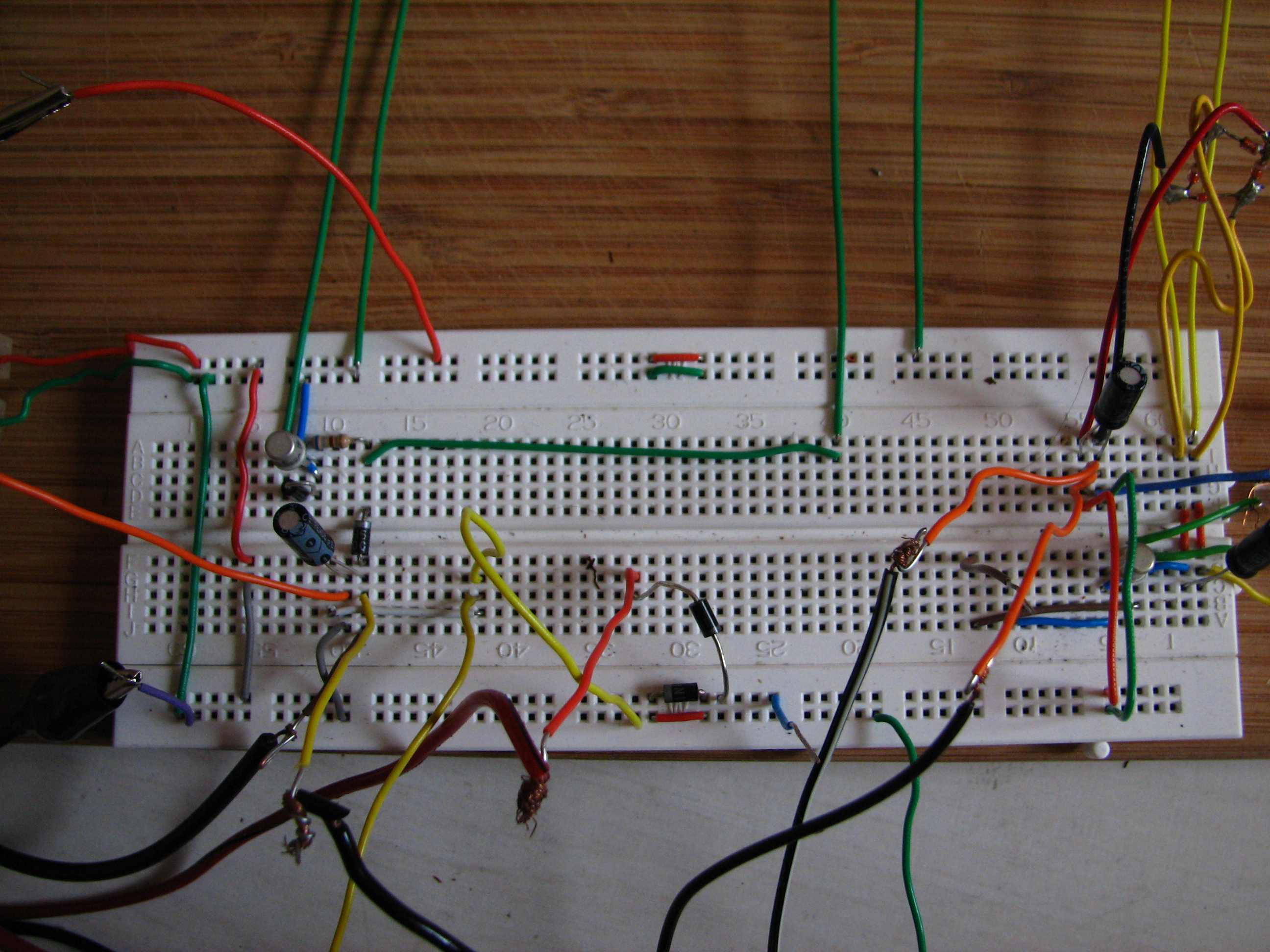

                    i have also added an extra image of the big cap that i use for Xenomorph
                    and of the circuit
                    Youtube does not allow me to reupload that other movie of 3 minutes
                    and i dont know why they shorten it
                    if i can do some tests for you on my circuit, let me know
                    [quote=Xenomorph;59703] That schematic is certainly better.
                    Its all good Xenomorph, im also new to this circuit drawings, cause im just only trying to draw how i made my circuit, its not like im first making a circuit drawing, i just keep on testing and measuring things
                    It amazes me that after removing the transistor from the feedback line, that your sphere is not massively slowed down by Lenz drag as there is a direct and constant galvanic connection to the battery.
                    what do you mean with "Removing the transistor", wich one ?
                    I will have the chance to analyze this better after i build it i guess
                    on drawing it looks like some complex circuit to me, while on the board its real simple, and easy to manage
                    i tested the negative cause my led was burning brighter hooking it up from negative to positive, while other way arroun the led power was less, thats how i came up on storing and.or reusing that power.
                    and when loading a cap in negative, you can take the output as positive
                    so that also makes it a little easier (Damn i wish i could do this like in Coding C# and atleast use IF Else statements in my circuit on how to handle power, and i dont want to use my basic stamp for this, otherwise it will be more advanced for a simple project )
                    my sony amplifier blew up few months ago and i kept it, so lately i took all the caps out of it, i dont know the voltage (maybe the 56 says something to anybody or maybe 50v since all caps in my amplifier where 50v) but i wrote all details on the circuit drawing
                    , but all small caps like the 25v, and 35v both 10uF i got with my basic stamp board, and they really help boosting and fast charging
                    Maybe ill just replace that )
                    for as far as i know, by testing, all bigger uF's shows lower voltage and good current, but takes long to load. when i want fast loads and fast reuse i use the smaller uF's and sofare the 25/35v 10uf are best for me

                            • Hi All,
                              im still bussy with my bedini marathon, and here is the vid
                              YouTube - One magnet No Bearing Bedini motor Selfcharging solar JB part 6 day 4
                              now its day 4, and non rechargeable batteries are on 2.64v
                              the caps are always loaded stable.
                              im going to test some new coils inc a tiny christmassball coil with aluminium foil and another tube coil.
                              @JonnDavro: No thnx my pleasure - it would be nice to see your main big rotor in the middle with like 10 tube sphere's with coil arround it
                              ill bet you will get allot out of it. i will also try to see if i can get/make a bigger coil pure for testing
                              @Xenomorph: how is your project doing cant wait to see yr vids
                              to everybody, keep up the great work
                              Greets JB

                              • So this is almost an official magnetic vortex machine... Cool!
                                Just wound a trifilar coil for use in one magnet rotor motor... Are we still using iron cores for main coil or is it all air core now? I was planning on taking the 3rd winding to radiant-pulse some CFL's, or at very least run a LED board. I think Lidmotor tried something like this, or was it you Xeno?
                                Hmm come to think about it, might be better to use a car coil in parallel for the CFL.
                                What do you think will burn out if I use a big 12 volt battery as source? Might need that power to drive the ignition coil, but I should give the low voltage option a try first.
                                For the solar, I have 2 6v panels at 35 mA. Do you think it would be better to use 12V 35mA or 6v 70mA ? 12 v is faster rotor, but might drop under load, while 6v would be more stable? Hmm.
