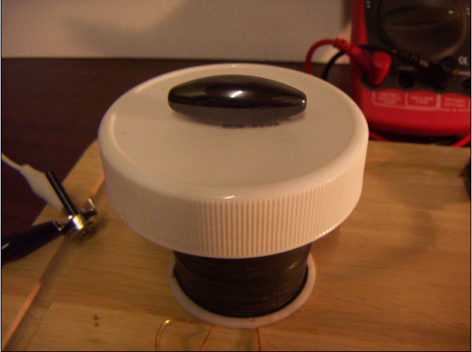

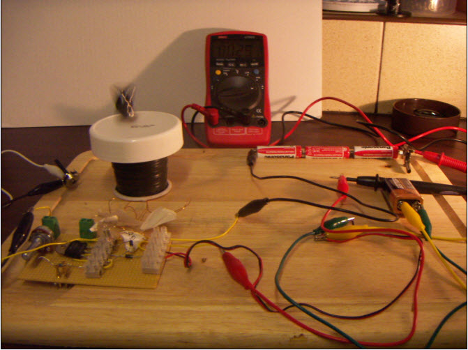

Hi.I saw a video on utube recently off a Bedini motor that only used 1 magnet and found it interesting so here is my version.

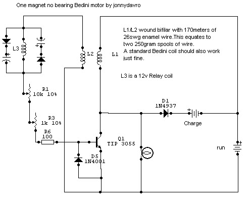

It is a standard Bedini circuit with a bifilar coil and core.The coil sits upright and i place a platic lid from a coffee jar on top.For a rotor i use one off those crazy magnets which are usually sold in pairs and make a loud noise when they attract each other.I have had the motor running today on 3 depleated 1,5v batteries which gave me 4.2v and once its going you can knock it down to 2 batteries.The combined voltage off my 2 batteries was 2.6v and it will start on 2 good ones.It will use 30mA on 3 batteries and and 17mA on 2.
This motor spins really fast at this low voltage and i have also run it off my joule thief and small solar panel and i even tried it on a 12v car battery and it sounded like a jet engine so i am going to stay with low voltage for the moment.
It will charge batteries but i have no imformation for you on this yet as i have been playing with it all day and having fun,it would make a really neat toy.
Here are some pictures off it and a video.
