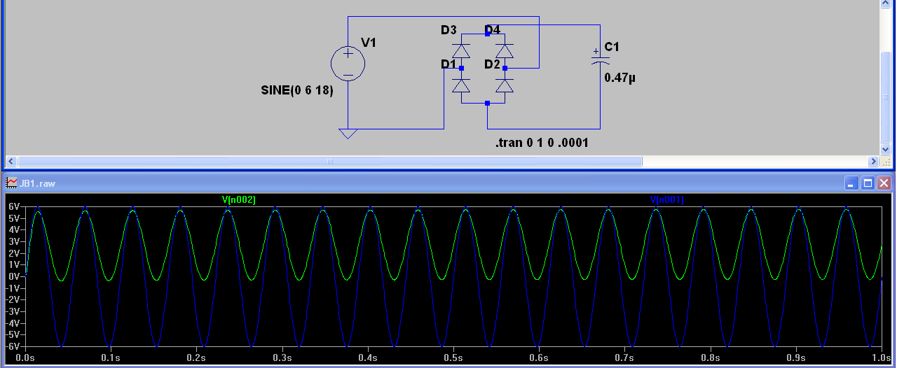

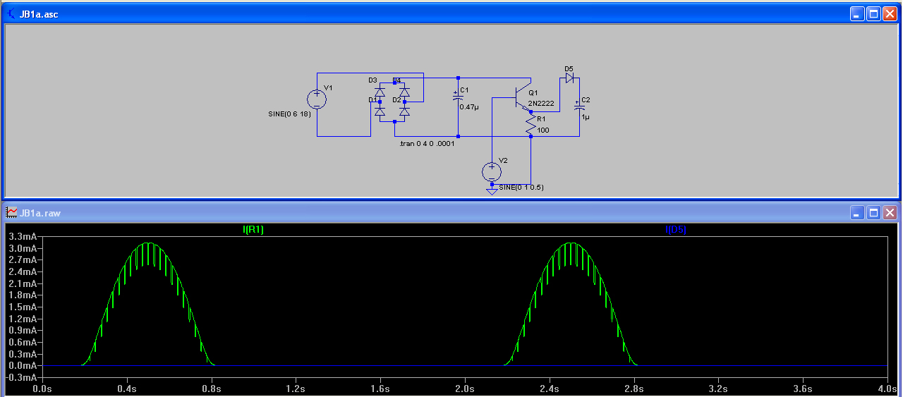

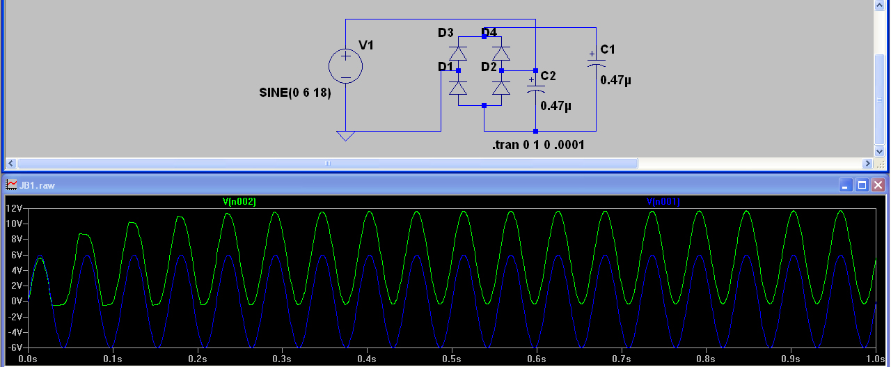

        • @JohnnBlade:
          I might have been confused by your unconventional way of drawing the circuit (No offense, why not to draw it like that? , f*** conventions hehe)
          It is hard for me to rotate your circuit by 90 degrees in my mind.
          The thing that i have meant is that i am quite sure that your cap charge will simply shortcurrent through the resistor which is high
          and the blue graph is the current through the diode into the battery (nanoampere or close to zero).
          But who knows if there is a radiant component making it trough somehow
          anyway. The simulator to my knowledge doesnt take radiant energy into account.
          Just from the cheer circuit analysis, no current is going through the diodeOptocoupler discharge circuit

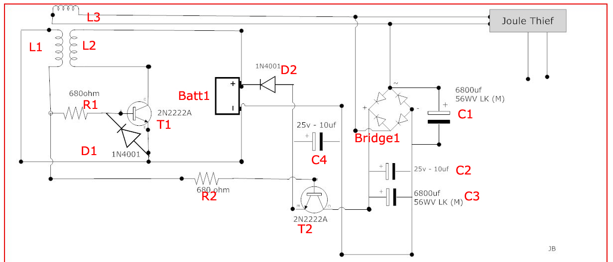

                  • Can we agree on naming the components like i suggest in the attachment?
                    It is unambiguous that way.
                    Then what you mean would be :
                    when i tested the 2e transistor (T2) , without connecting anything to the base
                    i got no reading on my meter, but when i hooked up 1 wire from the receiving coil (L3) , i got a reading of 1.5v. before the 2e transistor (T2) the voltage is about 3.3v so its like half is being passed through

                      i will do my best, since im kinda new to circuits, i only have my old knowlegde of circuit from like 15 years back im a pro C# developer now
                      So you connected one wire of L3 to the base of T2 ?
                      no i connected 1 wire from L1 with resistor R2 to the base of T2
                      Which voltage of about 3.3 v are you talking about (where was that measured) ?
                      i measured that after the bridge1, and after C2, and C3
                      when i disconnect C3 i get a swinging voltage of 2.8 to 3.3v
                      when connecting C3 i get a stable voltage of about 2.9v and climbing
                      when i disconnect my mutlimeter
                      The problematic thing of transistor usage of T2 is that you are hooking the positive potential of the battery to the emitter.
                      im just seeing it as an switch, and tried this hookup
                      As you can see with T1 the negative potential is at the emitter.
                      when i measure the power on the base of T2 its 0.02v
                      and on the emitter of T2 there is a voltage of about 1.47v thnx to the cap C4
                      when i remove the cap C4 i get 0.02v again
                      is it possible that the volts going to the collector of T2
                      open up the T2 and lets some volts go through, cause at the emitter of T2 is a voltage of 1.5v
                      but if that fires at exactly the point of time when you want it to, you know that better.
                      One thing is clear, that if you DO get a voltage onto C4 it must come from C3 and C2, because D2 prevents the battery to charge C4.
                      i will do some more tests to whats really going on there
                      It remains highly interesting if you manage to get a charge onto the battery that way.
                      For the time T2 is open you will have a Lenz drag, but maybe the short transistor cycle makes it hardly noticable which would be a good thing
                      I have had good experiences with timed discharges off pickup coils to minimize the drag that way.
                      Good luck,
                      Xenomorph

                            @JohnnBlade:
                            Okay i misunderstood which coil you meant.
                            Well that surprises me, L1 will then have to have a peak of battery voltage + 0.4 Volt minimum when it swings in the positive region.
                            I have never measured anything higher than 1 Volt in the primary coil. So how many thousands of turns do you have on the primary coil?
                            power? Against which potential did you measure these points? Against the ground (battery negative) ? Voltage is measured between two points, i am not sure which is the second point here, since a transistor has 3 connections.
                            The only thing that drives the transistor is the base current WHEN the condition is met that the base emitter diode is conducting which happens at around 0.4-0.6 Volts. Since we are dealing with fast voltage fluctuations you would need a oscilloscope to measure the base-emitter peak voltages.
                            What is your battery voltage? 1.5 V ?

                                @Xenomorph:
                                i measured this by hooking the minus of the meter to the minus of the battery, and the plus from the end of L1 and in steps till i reached the base of T2
                                i used 105mtr of 0.20mm kopper wire for L2, and 0.15mm 105mtr for L1 from Conrad
                                - i did not count how many turns but i think 1 turn is about 8/9cm (damn, i just calculated, and if im not wrong thats about 1312,5 turns - i think im wrong ?)
                                from minus of batt1 to the beginning of R1 - 11.2mv
                                from minus of batt1 to the beginning of R2 - 11.2mv
                                from minus of batt1 to the base of T2 i get - 1.77v moving up and down till 1.83v
                                when i measure from the (-) pole on the Bridge1 (with the minus from my meter) to the collector leg of T2 i measured 2.9v stable (inc solar)
                                and from - pole on bridge1 to the beginning of D2 i measured 2.89v 2.9v
                                and when i stop my sphere/rotor, the voltages drops all the way to 0v
                                since yesterday my battery has not gone below 2.57v
                                i saw it wanting to go up to 2.58 but i gues after changing some things it went down to a stable 2.57 - its 2 x AA rechargeable batteries 2500mah each at 1.2v
                                when i used normal batteries i saw the volts drop allot faster, and that is without charging and same was also for my rechargeable batteries
                                now im also using solar to fill the caps, and hopefully boost some amps
                                and now im waiting sun to go down, so i can see what effect that has
                                the circuit diagram i added is what im running now
                                and its all just a rough test, of the way i would think it maybe could work
                                i will keep on testing
                                Greets JB
