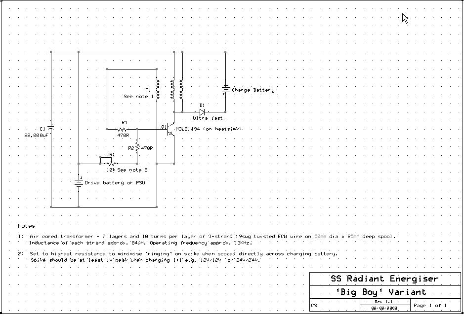

            Hi all,
            i just loaded the solid state charger with a conditioned 7aH battery. On
            the input was a TINY 1.3aH battery.
            The start voltage on the 7ah was 12.57 volts
            The start voltage on the 1.3ah was 12.96 Volts
            I put the 1.3 aH battery as the input on the solid state, and tuned
            the pot right down i could tell the draw, i heard the ringing on the
            tri filla coil., so i know some thing was going in.
            I put the 7aH battery on charge and left to it on to see what happened.
            The 7Ah battery charged to nearly 13.30 volts, the 1.3ah lost it after
            nearly 40 minutes to zero.
            I loaded the 7ah on a fixed resistor at the c20 rate, the battery held
            charge from 12.89 to 12.69 Volts (original was 12.57).
            There you go, a 1.3aH battery can charge a 7aH CONDITIONED battery.
            Here is the snap more to come.
            At the front you can see the Tiny 1.3ah hour 12 volt battery, in the
            middle is Clives solid state i posted a while back, at the end is the
            7aH battery showing the charge.
            video coming , ill do the test again.
            Ash
            My Q for Peter is, can a 1.7aH battery charge a 7aH battery conventionally COLD?

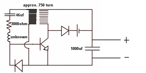

                Some early results with solid state charger with solar panel.
                first I'll say a bit about the batteries I'm using.
                they are 12v 1.3ah sealed lead acid batteries that I use for small experiments.
                One is completely dead... I have been using it for about 5 months on a replication of Plengo's "Running and LED forever" and lit an LED at about half brightness for that time. The batttery is completely dead (reads less than a volt under load) though it still lit the led.
                anyway... I was using another battery for the experiment before that and left it running for several days until the battery dropped below 6 volts and I chickened out cos I didn't want to kill the battery
                about a week later I restarted the experiment with the other battery and left it running. The battery that had dropped below 6 volts has been sitting doing nothing (hadn't been recharged) for almost 6 months. This is the battery I am charging in the following set up.
                I first began experimenting with solid state by comparing how high the coil could charge a capacitor with various resistor values. as bench marks I recorded:
                1000ohm : 225v charge while drawing 100ma
                3000ohm : 204v charge while drawing 75ma
                I then thought to give my trusty choke coil a try! I had already soldered the rest of the circuit together so couldn't take out the 3000 ohm resistor but when I added the choke in series the results were as follows:
                232v charge while drawing 50ma!
                These amp draws were from an analogue meter.
                So I left the choke in and hooked up the setup to my little solar panel to see how well it could charge the old battery.
                Dissappointingly, the solar panel would only charge the 1000uf capacitor to 1 volt and drew less than 5ma (it doesn't recieve direct sun light).
                The neon won't light with the charging battery detached but I can confirm it is oscillating using an am radio. Suprisingly high frequency.
                I hooked up the old battery and left it going all day yesterday. and you can imagine my suprise when it went from 6.35volts resting to 7.84volts resting in less than 6 hours!
                I have to admit, that I still don't know how much energy is actually in the battery because it could be in poor condition though this seems to be an incredible leap in voltage with such a tiny input!
                Dont get too excited yet because this is all very recent so I need to do more tests, but first I want to see if it can fully charge this battery.
                Will let you know!
