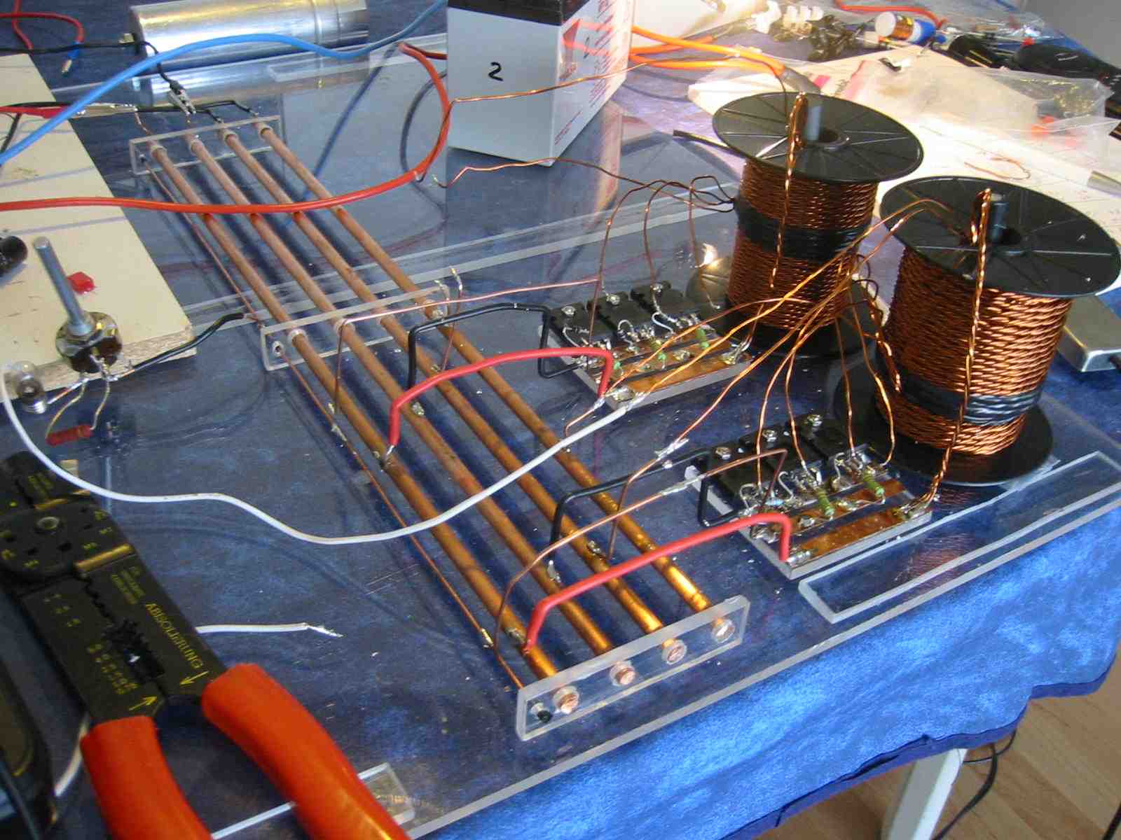

I started experimenting with John's technology about half a year ago and at some point I started concentrating on the solid state energizer and am trying to get ..there. I've recently built a new working platform to experiment with single to multicoil setups but is expandable to about 10 multicoils as soon as I figure out wich one is the best of all possible combinations (I attached a pic by the way). In the beginning I thought to simply hook single solidstate circuits in parallel. then I started making some tests with different setups, cap-pulsing, single coil output diode, multicoil output diodes, output with recovery coils, etc... Also after having been working on a multicoil setup with cap pulsing for quite a while, I got much better results with a normal SG multicoil setup with output diodes charging the batts rather than one recovery-bridge cap. Might be because of the lower impedance on the output. Still working on it..so many things to test!
The other day I noticed something new, I was driving only one transistor out of the three hooked to the multicoil, the trigger and base diode were also detached from those two. So while I was running basically off a single setup I accidentally connected the output diode to the output diode of one
of the not running transistors. I could hear the freq go down a bit, like if you lower the trigger pot to increase power (and current draw). But guess what, the input current dropped, while i could measure an increase on the voltmeter on the charging output batt. So I hooked up the third output diode of the also not triggered transistor and the results got even better!
So from an electrical point of view I was driving a single setup and had two "recovery" windings with a single diode each added to it wich gave more output power and took less input current. I always thought that more than one recovery coil wouldn't gain anything..?
I also tried to link the three outputs before the diode, wich didn' give the same results.
Any help or hint to get to the best recipe is welcome!

Thank you for reporting your finding that multiple windings with individual diodes produces more output. The reason that it doesn't work when the coils are paralleled BEFORE the diode is that the energy in one coil tends to discharge INTO the other coil and vis versa. The diodes prevent this from happening, and the energy recovered from both coils can then be summed.
Exactly WHY there is more energy to recover in this arrangement is not known by me. This is simply an experimental result you are reporting. It sounds very encouraging, and I hope others try to duplicate the finding.
One possible explanation is this. John Bedini has been saying for a long time that these devices draw energy in from the environment. Your experimental set-up and finding may be significant evidence in support of this idea.
Also, as to what is "the best recipe?", WHO KNOWS! You state you have a 10 strand multi-coil. Try hooking one strand up as the oscillator and the other 9 strands as extra pick-ups with separate diodes. Keep summing them, one at a time, to see where the benefit ends. That way, you can tell us!

thanks for the encouragement, It's actually two 4-strand multicoils, and I'm planning on expanding up to 10 multicoils. The first one has 5 strands because of the trigger. I have 3 transisitors on each coil, the fourth wire was initially planned for cap pulsing recovery, but I got more out of it with an output diode. Even on a single setup I noticed that output diode charges faster. I don't know why. Do you? Also what is the advantage of a fwbr vs single diode? The pulses are positive anyway no?
About the diode recoveries, I put ammeters on input and output, and for each setup I tuned the pot for the same input current to see wich one would give the most benefit on the output. With one transistor working I added one recovery and could see a distinct benefit, nr two added a bit less and nr 3 very little. Then I tried two transistors, the first recoveries added less vs the single setup. Comparing all the setups, firing all three transistors with no recovery seemed to be what gave the best output vs input curent. Maybe just adding transistors is still best, but I have to repeat this test with switches instead of soldering and de-soldering so many times.
I know ammeters don't measure the radiant part but the byproduct, so do you think the way I measured this is ok?
