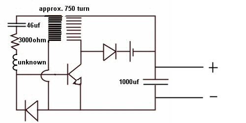

Some early results with solid state charger with solar panel.
first I'll say a bit about the batteries I'm using.
they are 12v 1.3ah sealed lead acid batteries that I use for small experiments.
One is completely dead... I have been using it for about 5 months on a replication of Plengo's "Running and LED forever" and lit an LED at about half brightness for that time. The batttery is completely dead (reads less than a volt under load) though it still lit the led.
anyway... I was using another battery for the experiment before that and left it running for several days until the battery dropped below 6 volts and I chickened out cos I didn't want to kill the battery
about a week later I restarted the experiment with the other battery and left it running. The battery that had dropped below 6 volts has been sitting doing nothing (hadn't been recharged) for almost 6 months. This is the battery I am charging in the following set up.
I first began experimenting with solid state by comparing how high the coil could charge a capacitor with various resistor values. as bench marks I recorded:
1000ohm : 225v charge while drawing 100ma
3000ohm : 204v charge while drawing 75ma
I then thought to give my trusty choke coil a try!
I had already soldered the rest of the circuit together so couldn't take out the 3000 ohm resistor but when I added the choke in series the results were as follows:
232v charge while drawing 50ma!
These amp draws were from an analogue meter.
So I left the choke in and hooked up the setup to my little solar panel to see how well it could charge the old battery.
Dissappointingly, the solar panel would only charge the 1000uf capacitor to 1 volt and drew less than 5ma (it doesn't recieve direct sun light).
The neon won't light with the charging battery detached but I can confirm it is oscillating using an am radio. Suprisingly high frequency.
I hooked up the old battery and left it going all day yesterday. and you can imagine my suprise when it went from 6.35volts resting to 7.84volts resting in less than 6 hours!
I have to admit, that I still don't know how much energy is actually in the battery because it could be in poor condition though this seems to be an incredible leap in voltage with such a tiny input!
Dont get too excited yet because this is all very recent so I need to do more tests, but first I want to see if it can fully charge this battery.
Will let you know!

Jacqui , Mart just to clarify , all windings are the same guage and the power transistor / transistors are located between the coil and neg. the other end of the coil winding is the pos. supply or run battery , it's just a coil in series with a DC chopper the output is a tap with diode just between the coil and the transistor collector . This idea is a JB cct without the spining magnet trigger etc. Jacqui .See my experiments here...
So basically
What you are doing is adding a couple of caps and I higher resistor in the trigger coil section... to the SSG. I did this for a while with a 5K pot. With low voltages it did great but it did seem to heat up my resistor, But I did not have caps in the circuit as you do...Originally posted by Sephiroth View PostMoved here from the SSG thread.

lol... I did notice the caps
There isn't any heat even with the 12v supply, though that will be because it has such a low draw. I'm just suprised it ocsillates at all with only 1/200 watt input! Let alone charge a 12v battery.
Edit : did I say 1/20 of a watt? I meant 1/200 of a watt!Last edited by Sephiroth; 06-18-2008, 05:58 AM.
