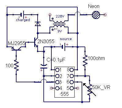

Originally posted by Sephiroth
The voltage at the capacitor is observed at around 170-200 volts without load. As soon as I connect the charging bettery then the voltage get dropped to around 1-2 volts above the battery voltage.
Mostly today I will source the capacitors having 5000 mfd or above then will test the same.
