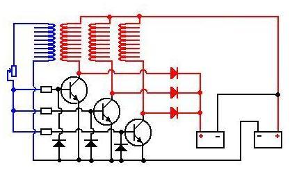

    I got a tri-flier wire wrapped in a single spool. First, I was using the third wire to a rectifier to a battery/capacitor. NOW, I am trying to use it as a power wire, as in a Master/Slave coil setup, whenever I hook the third wire to the circuit the AMP's Double and the motor starting getting heavy until it comes to a complete stop. When I try to reverse the wire hookup as in changing the polarity, It does not work.
    The core I was using is 1/2 metal rod. I purchased some weilding rods to replace the core.
    Any input/comment would be greatly appreciated.
    Also, I am using the 22 gauge as the Trigger and 19 gauge as the Power. 900 turns for all.
    Hi uusedman,
    You have to adjust the trigger circuit resistor value every time you add another power wind. It's probably been said before, but you sould be aiming for around 250mA per transistor (for MJL21194 type), so that's 750mA total input current for the three.
    Hope this helps,
    Steve.

    Yes, same circuit however, 1 slave.
    I am always having fun with this. Had to take a break from the Rotary Attraction Motor. Want to first build a reputable Bedini before moving to the Lindemann Motor.
  • tjnlsn255
    Hi Uusedman....
    Are you using this circuit?
    Are we still having fun?
    Todd

    I need HELP! and confused.

    Hi guys
    Finally got a spool of wire and built my ssg as close to spec as I could.
    quadfilar coil 22 awg wire 125ft. almost 400 winds
    1 trigger
    3 power
    I can now push my batteries up over 14+v so have started conditioning them correctly.
    My only question is
    I'm down to less than 300 ohms to eliminate the self oscilation and probally 80% of the time when I hook up power it starts on it's own.
    I started out around 700+ ohms with the 25ma light in the circuit also. It's nice not having to spin it up all the time but should I lower the resistance more?
    It's pulling 750ma draw witch maybe low for a 3 power coil machine?
    will have another spool of wire in a week or so. Already have the other parts on hand. then I can add another power coil with 4 windings.
    thnaks ww
