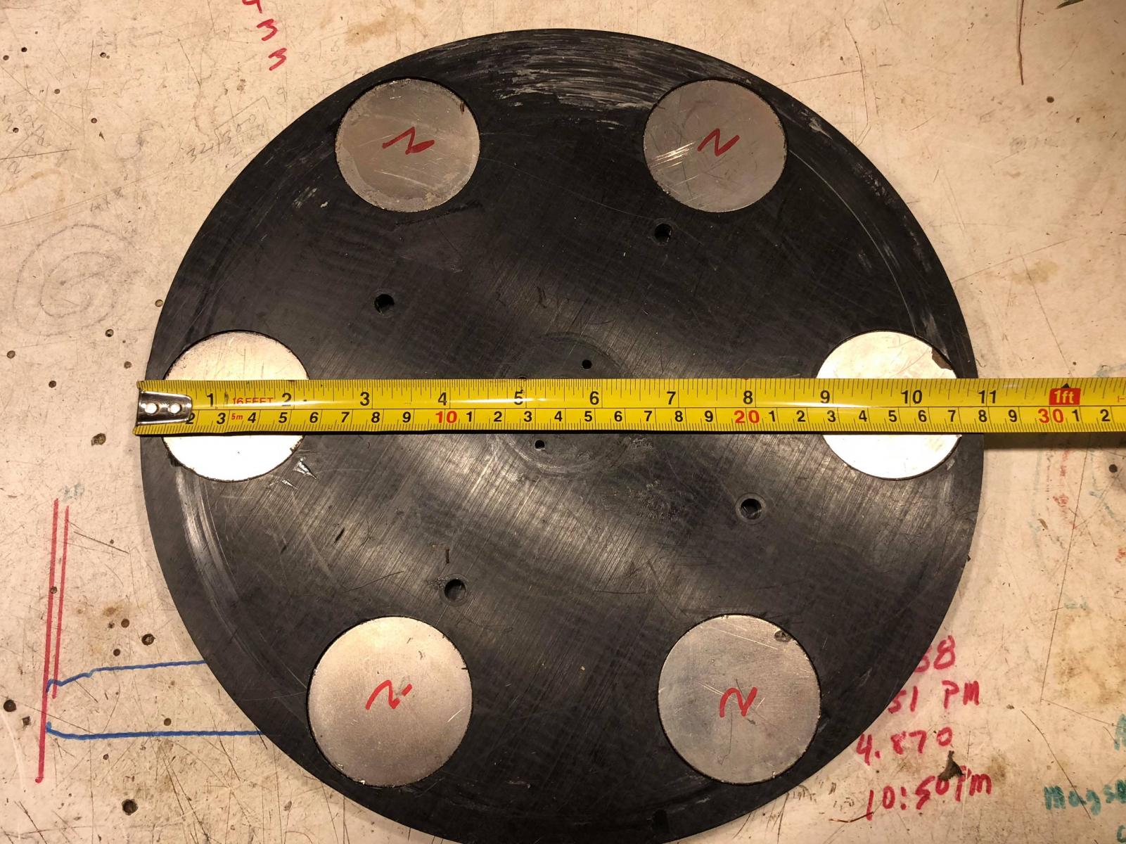

    EDIT: Sorry, I forgot to ask. This 8" rotor should be the outer rotor size or magnets centre?
    Lukasz,
    Does my last posted picture answer your question? Forgive me for not understanding your question. I'm a little thick in the head sometimes.
    wantomake

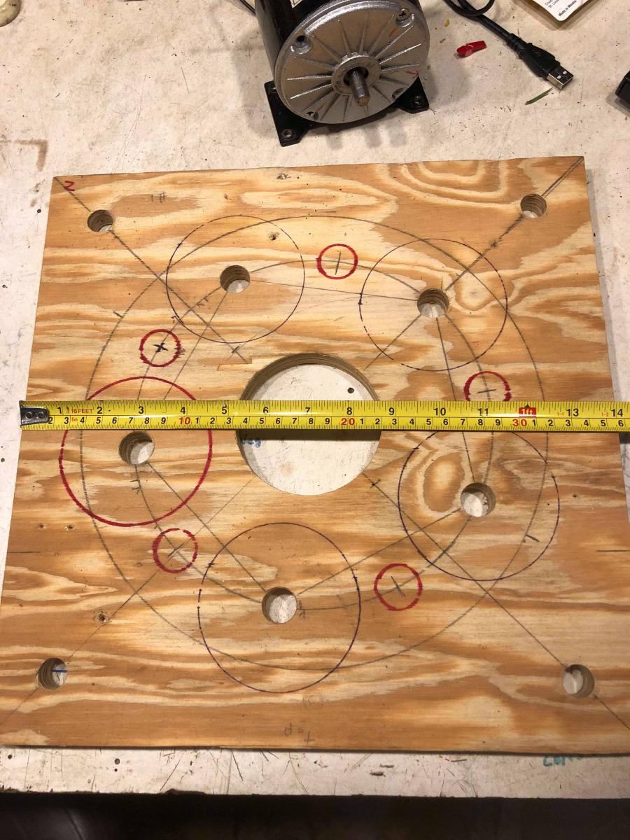

    Today and tomorrow will be good cool weather and chance for me to get some generator building time.
    I'm using 3/4" plywood as stators holding the coils in place. The plan is 5 coils on north side of the rotor (with 6 x 2" x 1/4" mags) plus 5 coils on south side. Total of ten coils. I think the plywood 2'x4'x3/4"was $16.88 each. I got 3 of them.
ID:	461748Click image for larger version
    The larger circles will be cut out to make it easier to install/remove coils. The smaller red circles is for something else. I will replace the wooden dowels I used with aluminum rods or bolts with the pvc spacers.
    Still need to order another spool of magnetic wire for next coil.
    More to come as money and life allows.
    Dave, Is there any other way to stop the wabble of rotor without extra side rotors? I've not much room for them.
    wantomake
