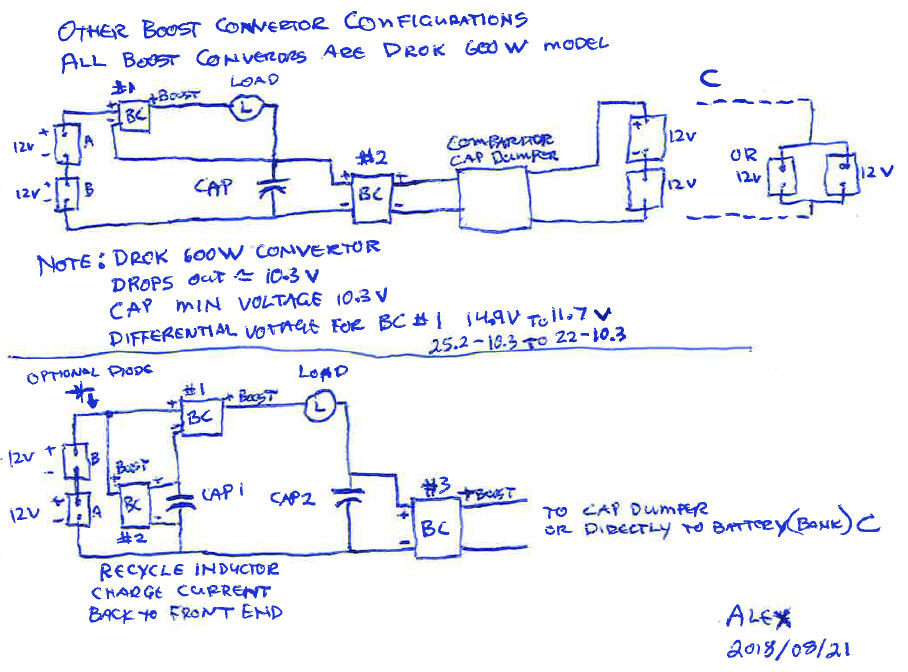

    My Goal was to address the differential voltages and simplify the battery rotation scheme by only switching between 2 or 3 24v banks. Also to determine how much (if any) of the losses in the system could be made up for by the boost convertor + cap dumper arrangement.
    The boost voltage to the load could be set to a constant 14.9v or higher. It could also be set lower but the load would start out at the max differential voltage minus the output diode voltage drop until battery A+B drops below the boost convertor set point.
    The cap in series with the load maintained a steady 10.3v due to the fact the chipset of the boost convertor connected across the cap would cease to function when the source voltage drops to 10.3 volts. I took advantage of that operating characteristic to maintain a higher voltage differential.
    I did this some time ago but can't find my test notes so this is from memory.
    The comparator cap dumper peak voltage/dump frequency could be adjusted easily for maximum charging rate of battery (bank) C. I had best results by setting the comparator for only a few volts above battery C with several discharges/sec. That was what my batteries (in the shape they were in) seemed to like best.
    In Peter Lindeman's SG Beyond presentation, for some reason he didn't include or forgot to mention battery charge/discharge efficiencies as part of the losses in the system. He only mentioned wire/coil resistances and voltage drops across transistors and diodes as the minimal electrical losses that needed to be overcome. He indirectly inferred the DC generator waveform of the constant current followed by a spike would address the charge efficiency of the battery in the charge position.
    The boost convertor in concert with the comparator cap dumper boosts the charge efficiency of battery C on the basis of Teslas method of conversion in my opinion. IE, converting a low voltage low current source into high voltage high current impulses to produce a gain.
    Recycling the inductor charging current from the negative leg of BC #1 in the second config extends the run time of batteries A and B.
    If your load can tolerate the full differential range of 14.9v to 11.7v, you could omit BC #1. Using a cap in series with the load provides a higher voltage differential for the load/ boost convertor + load to work with.
    I make no claims on the COP of this arrangement. It would need much more cycle testing than I had time to complete but the experiment looked promising. Your mileage may vary.

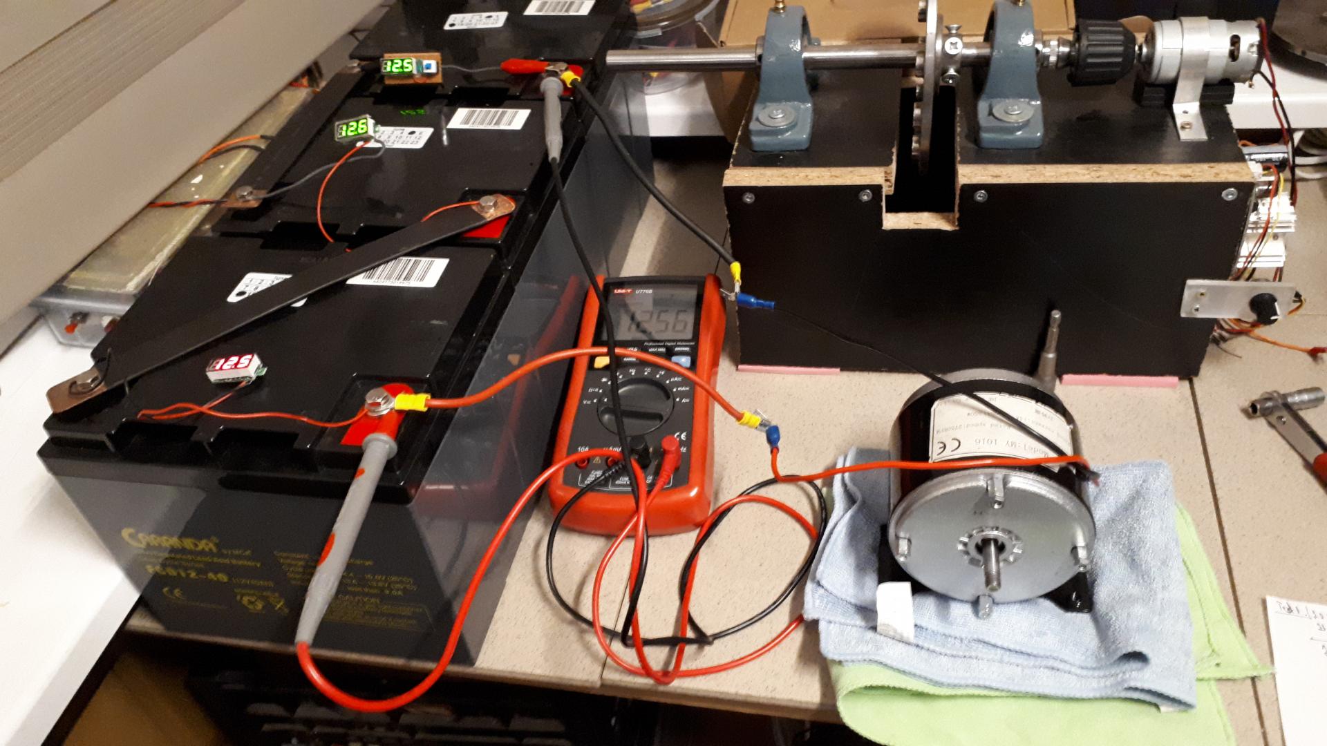

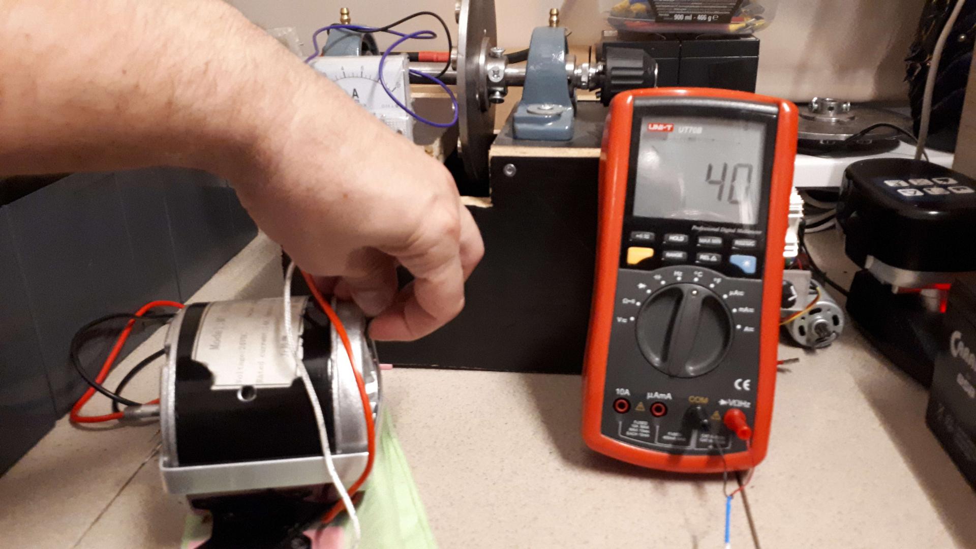

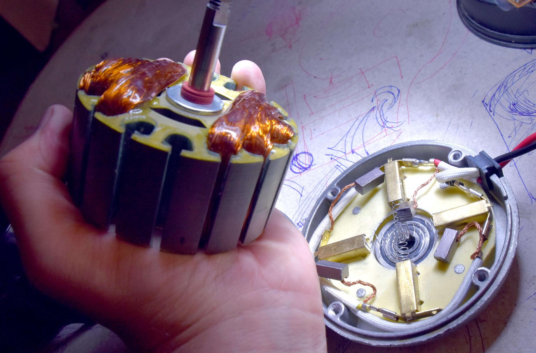

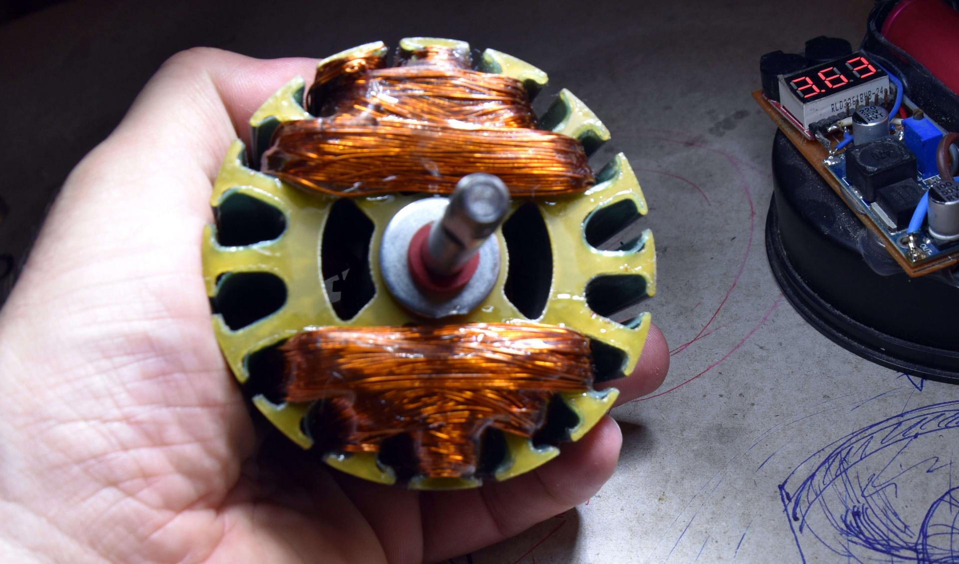

      Greetings,

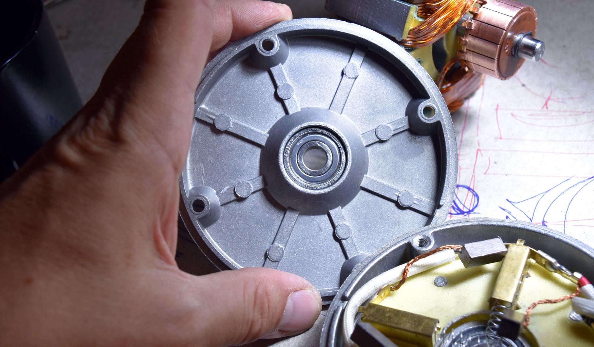

      Finally, I had the time to finish my motor winding, epoxy and balancing included. Also, I`ve changed the original bearings with brand new quality bearings. Current draw of the motor, thought, is around 3,8-4 amp at 12 -24 volt.
      Edit 1. I forgot to mention - each winding measure 0,4 Ohm, 40 turns+30 turns+30 turns, 24 AWG x 3 wires (actually 0,55 mm - between 23 and 24 AWG).
      Edit 2. After sanding the copper contacts, and switching the metallic case of the magnets holder, the current draw dropped to 2,5-2,6 amp. Unfortunately, no tacho available, so no speed measurement.
      I added, also, a movie with test nr. 2 of the motor, HERE
      I think the current draw can be improved even more.
      Edit 3. First test was for one hour, and current draw decrease from 1,8 amp (14 volt differential) to 1,7 amp (12,5 volt differential). VERY INTERESTING - Batt 1 and 2 was 12,7 volt and Batt 3 was 12,1 volt, and all setup run for at least 30 minutes very steady, ALL batts at 12,5 volt. Too bad I had to shut down the motor, IT WAS VERY HOT... I have to find a way to remove the heat from the motor.

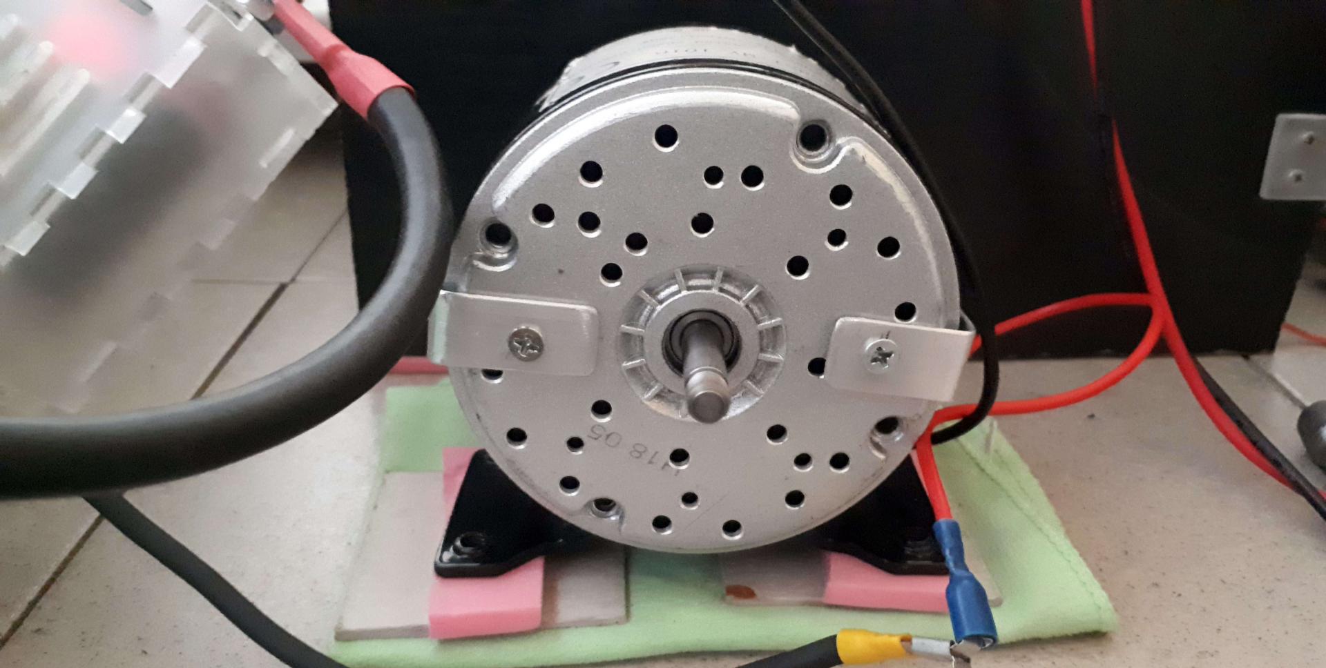

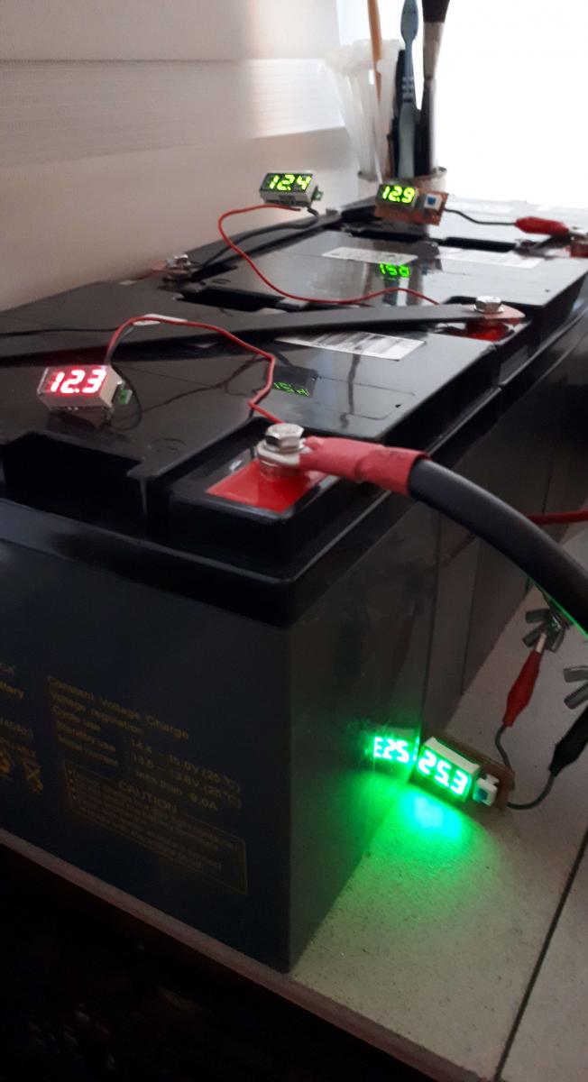

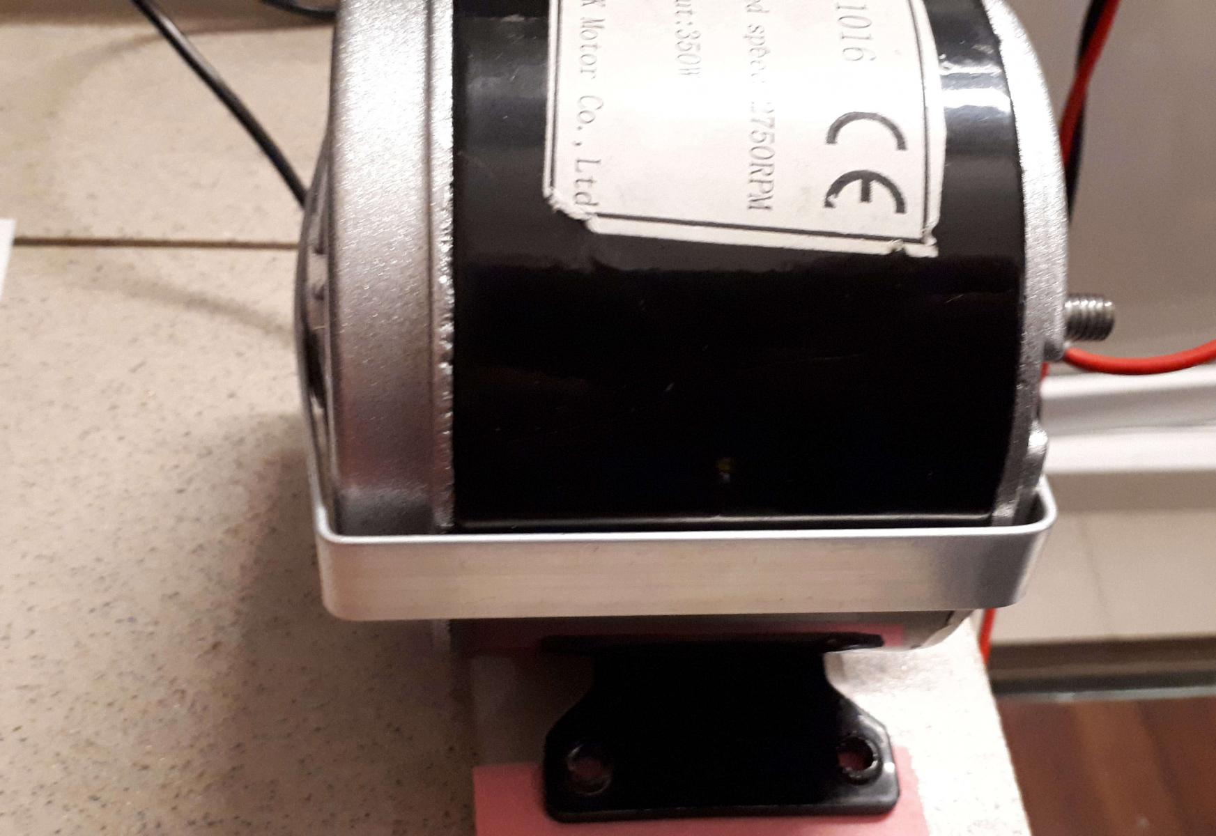

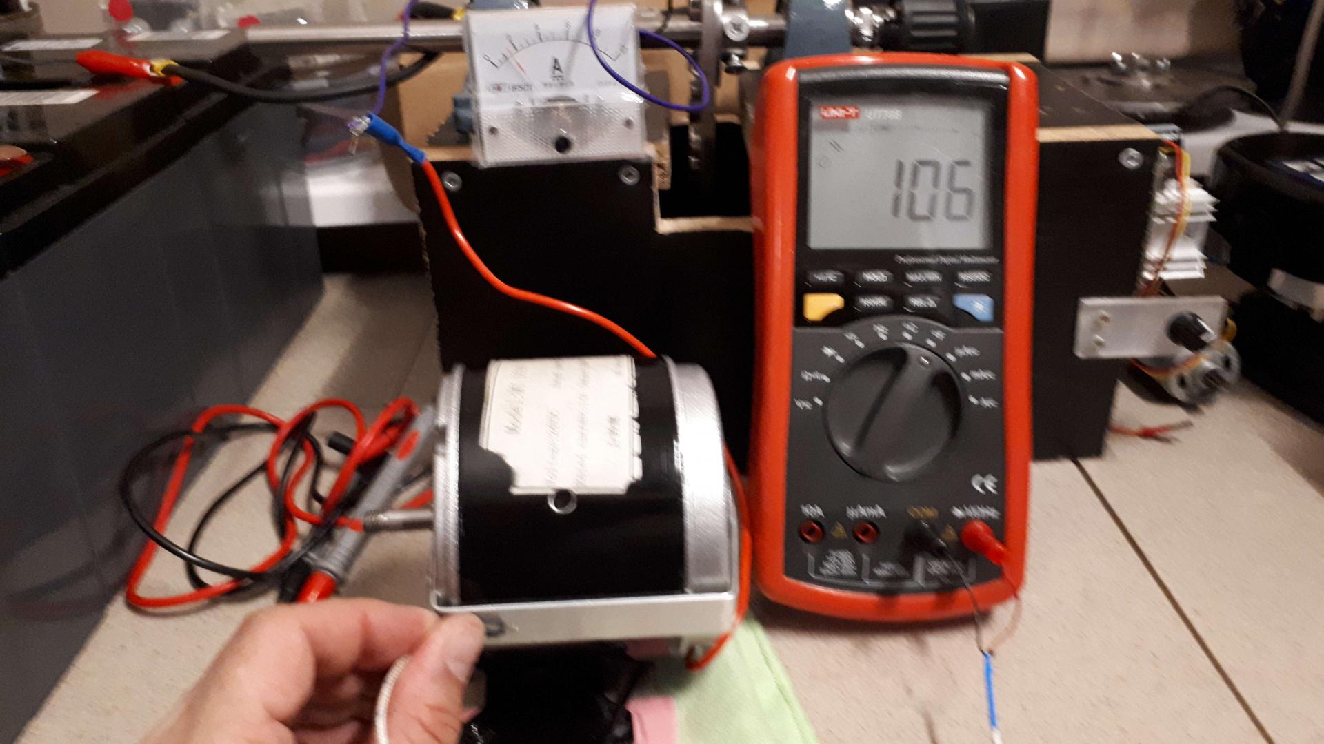

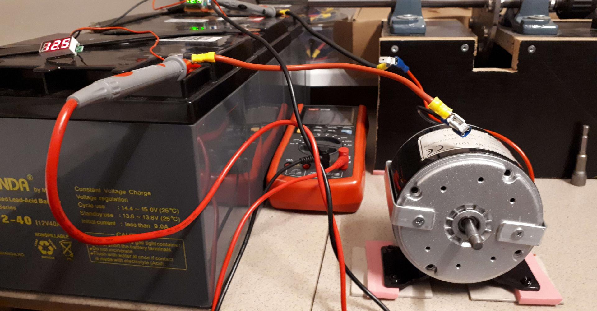

                        • Just a quick update: I thought it would be interesting to try to find a way to eliminate the heat, so in the pictures are the results... and a short movie, HERE
                          After a 15 minutes test with motor hooked up at 24 volts, MY1016 is quite hot, but still operational - before, it was very hot at only 12 volt, also, after 15 min.
                          Edit 1. After 30 min, it looks like the backplate it's going really hot, also, the both holes from sides generate warm air, so I think this may be the best quick solution to prevent overheating, or to prolong running time. Actually, the spacing between all 4 magnets allow to make 4 holes, even bigger than mine, and the magnets, including the plastic holder, can be removed to make the ventilation holes.
                          Edit 2. After running very hot one hour at 24 volt, I decided to test the motor at only 12 volts differential (no booster) on 3BGS.
                          So the motor is running for almost 2 hours, and the last hour is running cooler than previous tests on 12 volts - so I think this mod can be used on 12 volts. For 24 volts, I think the case need more holes between magnets. Some foto with temperatures added, this post in Fahrenheit degrees.

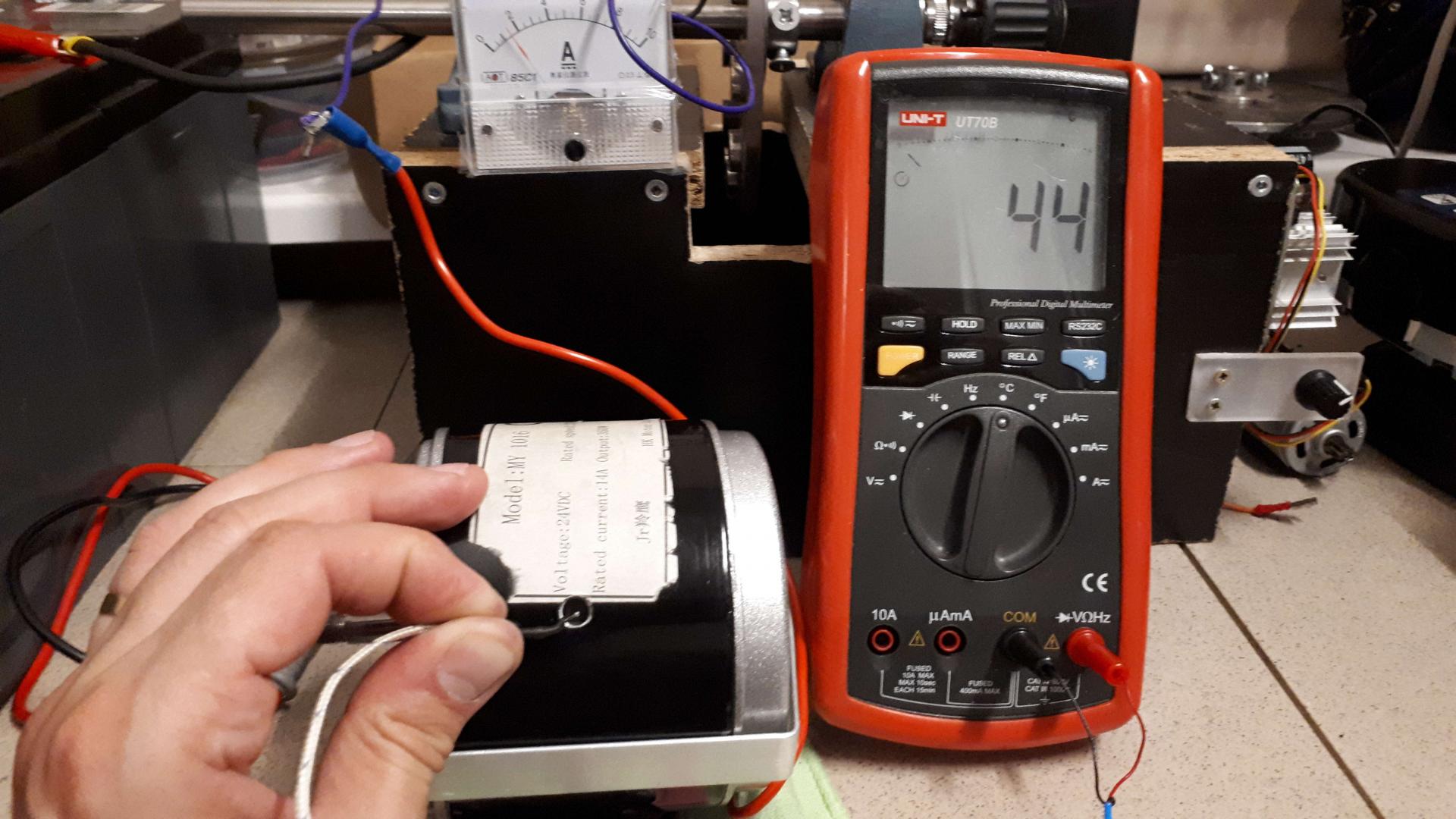

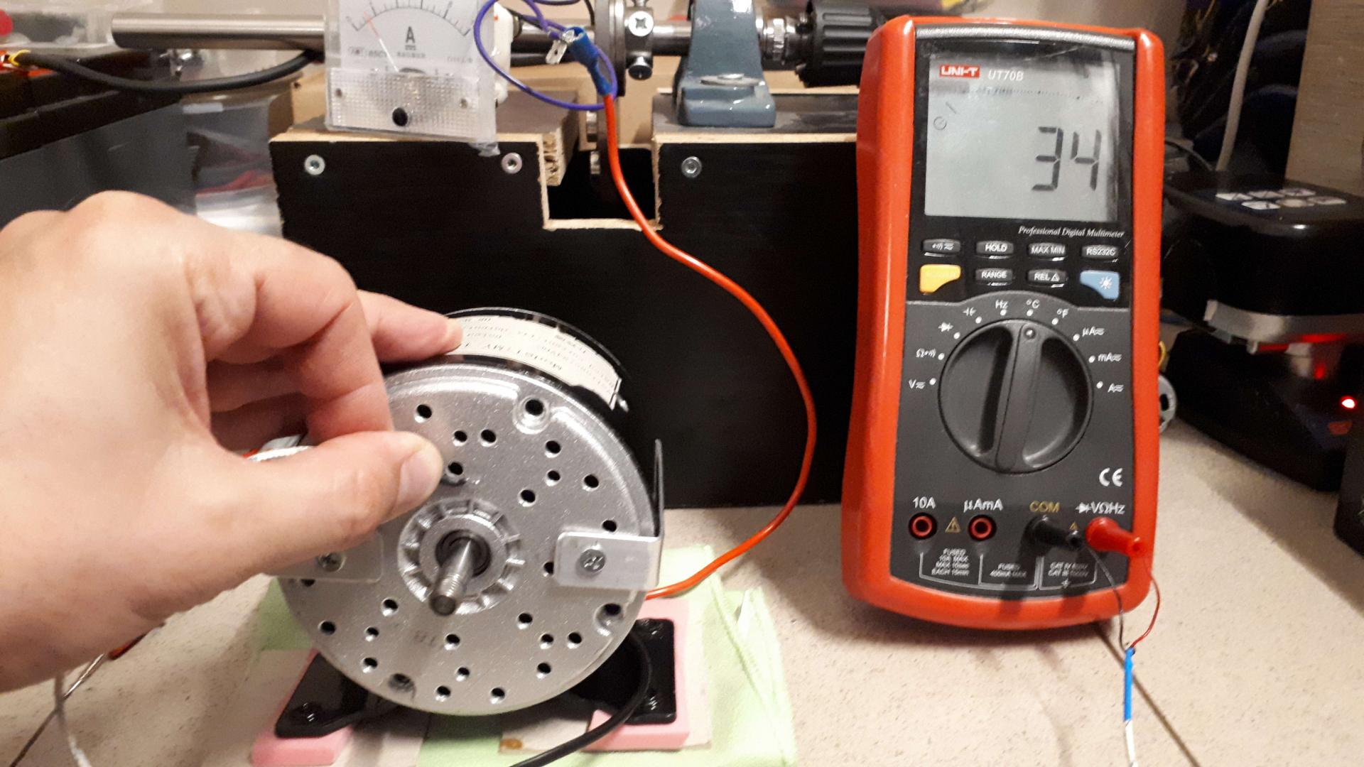

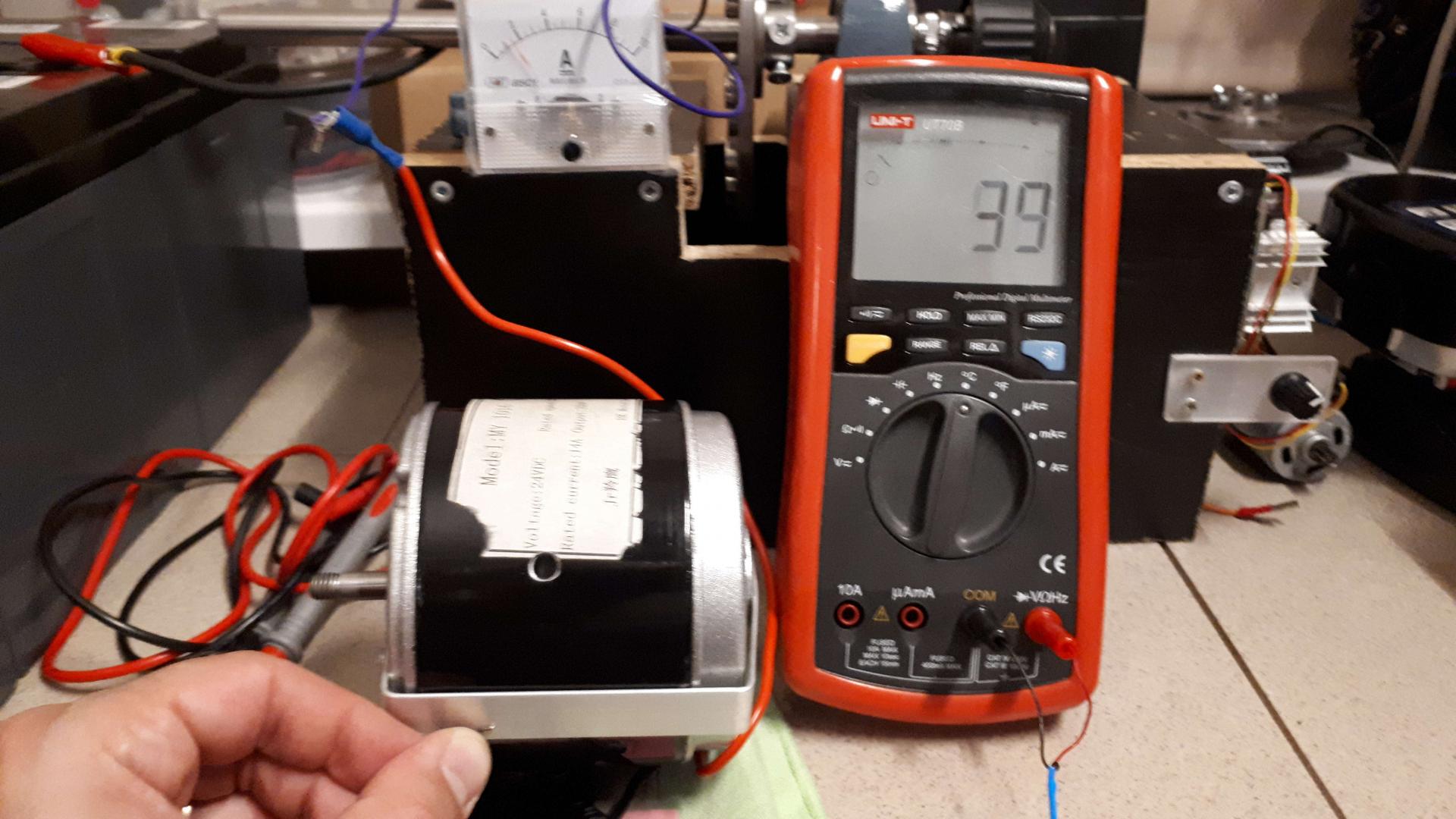

                          • Other pictures, this time in Celsius degrees. The biggest temperatures can be observed in the 4-th picture, with sensor on side hole. Pictures taken at cca 2,4 running time hours.
                            Very quiet in here...
                            L.E. Anyway, the motor was running for 4 hours continuously, last 3 hours on 12 volts, and the temperature of the MY1016 is constant, the motor is only warm, as can be seen in pictures.
                            For 24 volts or for using on big loads, though, some suplimentar ventilation holes must be done on sides. I would make bigger holes, also, on the back plate, because this is warmer than frontplate.
