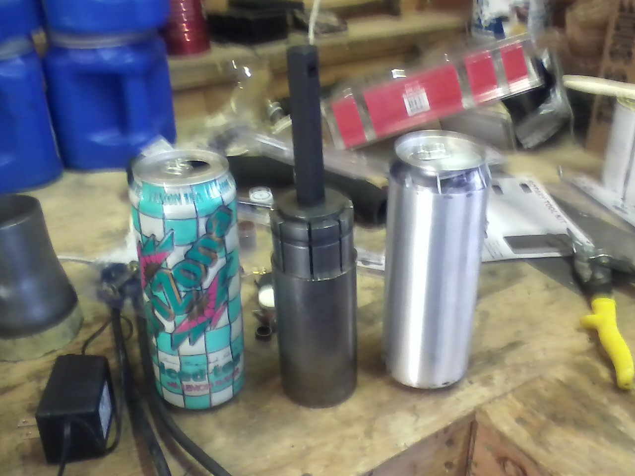

                            Today I am starting the Savic build.
                            My technique for sanding ,leave the can full,,, buff with 180 emery ,build up a nice sweat ...Open can have a nice drink!!
                            Can dimensions
                            Diameter 72.8 MM
                            Usable length 180 MM
                            Slovenia the reason I switched to the Can ??
                            The professor is building too.........
                            So my ring height will be 10 MM? my gap 2.52??
                            I posted a pic of your pipe/ring spreader !![Heh Heh]
                            Mine is 3.5 hrs away at home !! [3 days out]
                            I guess I'll go make a 2.52 ring x 10 MM height
                            Chet

                            • 2011 11.11 am EDT
                              Nice
                              Chet
