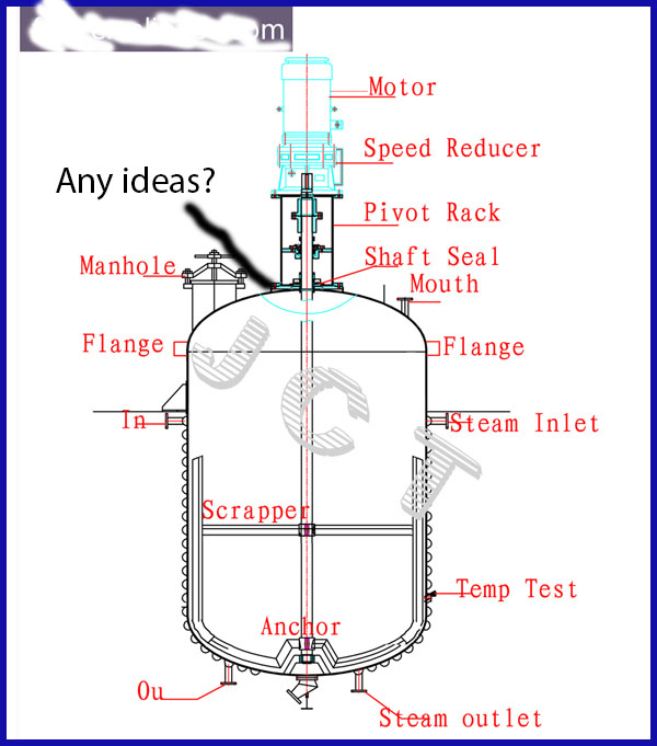

There are many ideas on the Internet, but few actually work.....safely at least. There are many so called Manufacturers out there that have very little real world experience in Pyrolysis. They simply make plants and the Buyers think they are therefore buying something that works. But that is not always the case.Originally posted by chacowako View PostHi has anyone had experience with a Mixer OR is a mixer really necessary?
I am building a 300liter retort per day. I already have my small scale prototype working (2liter per hour) and going to scale up my issue is with the mixer. Anyone could suggest a good way to do it?
It is very very difficult to get a perfect seal when working with the temperatures and the vapors we are dealing with. I played with several ideas, but could not get anything to work effectively and continuously. All the tries ended up with leaks and the need for replacement with each use. Plus just thnk about how hot that motor would get sitting above the retort and the retort being heated to 400degC. I doubt the motor would last long.
I am sure that if money was no issue, it could be done, but that goes beyond what this site is all about.Last edited by wheels; 01-28-2015, 09:48 PM.

No experience but I believe a mixer would help the feedstock boil more calmly something a bit like Boiling chips/Anti bumping granulesOriginally posted by chacowako View PostHi has anyone had experience with a Mixer OR is a mixer really necessary?
My thought is that because there is next to no pressure in the retort, the shaft could be sealed with a simplified DIY version of a Mechanical seal

I tried a mechanical seal as well, but then I am working with the most nasty of plastics and I can't accept even the slightest leak of gasses as those gasses are highly toxic and corrosive, not to mention not wanting any oxygen to ever creep back in. The acid levels are extremely high, so any metals (brass etc) that work as a seal in any other application, do not work with acids at 400 to 500degC. I have considered a carbon face type seal, but have not gone further, due to time being taken up in other area's at the mo. Once fully back into the Pyrolysis part when I get back from Auckland, I will be trying several ideas.Originally posted by Excalibur View PostNo experience but I believe a mixer would help the feedstock boil more calmly something a bit like Boiling chips/Anti bumping granules

The idea of having a stirring device was two fold. Firstly was actually to solve a problem of the Carbon caking in the bottom of the retort and keeping it moving was to aid in a way of automatically removing by a small port at the bottom. But this has to be done with extreme caution, because the last thing anyone wants is for oxygen to be introduced at the bottom of the retort. It results in a loud ringing in ears and possibly Sunday afternoon harp practice on a cloud somewhere.
The other thing the idea was to aid, was keeping the plastic stirred to aid in a faster and more even melt. Plastic is a great heat insulator and keeping it moving ensures the heat is able to flow evenly and quickly through the entire retort full of plastic.
As mentioned, the turning of the retort was yet another idea, but it posses an even bigger issue of seal. The thing is, the larger and more efficient we want a plant to become, the more complex a system becomes and the result is ever increasing dangers and difficulties to overcome.
