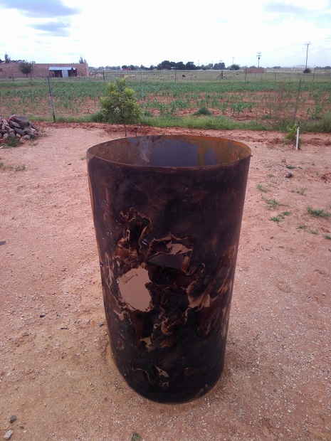

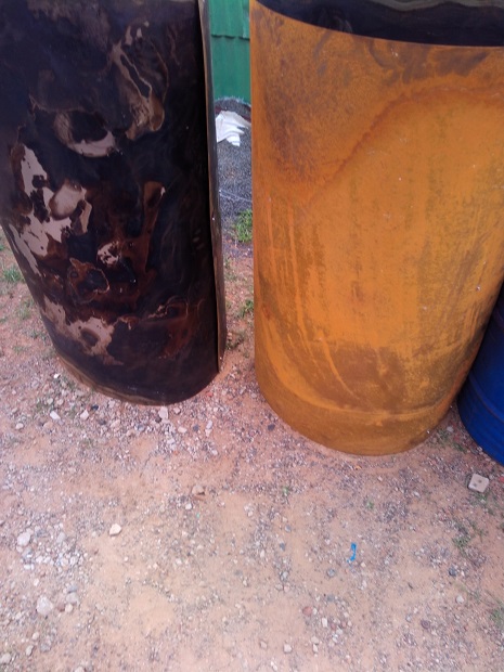

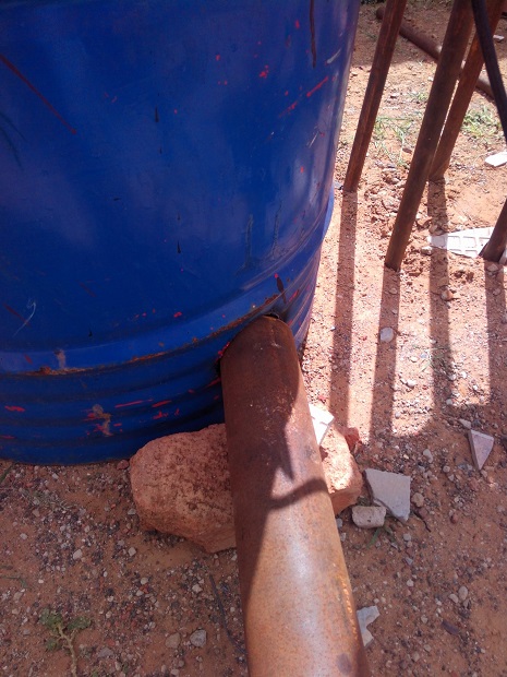

It is good to get pics of failures too. Nothing is really a failure as long as we learn from the experience. This is a good way to go to share with others, what works and what not, what to watch out for. How thick was the steel you used on the ducting?

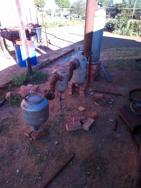

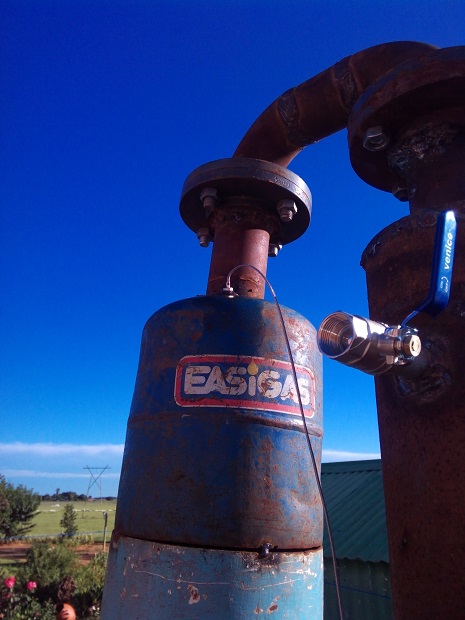

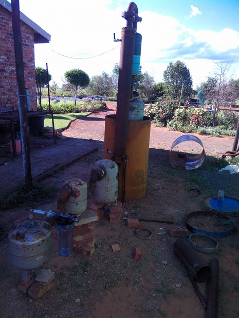

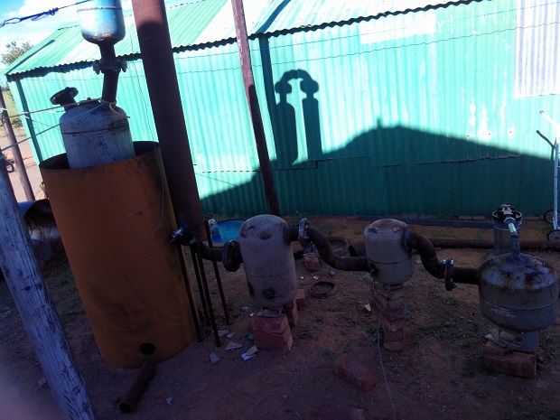

I looked at your gas jar and decided that I will do something similar for the gas storage. Is it necessary to have the water tank open, won`t a water level work just as well to inform you where the gas level is in your storage tanks?

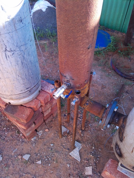

I was wondering this afternoon, how much water do you use in your heat exchange to cool down your gas? I`m installing the water inlets and outlets at the moment on the heat exchanger and thought about what type of reservoir I will need to cool the system down. Do you have heat gauges on your heat exchanger also?

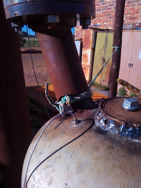

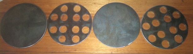

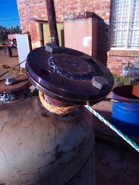

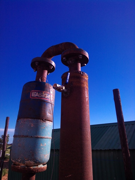

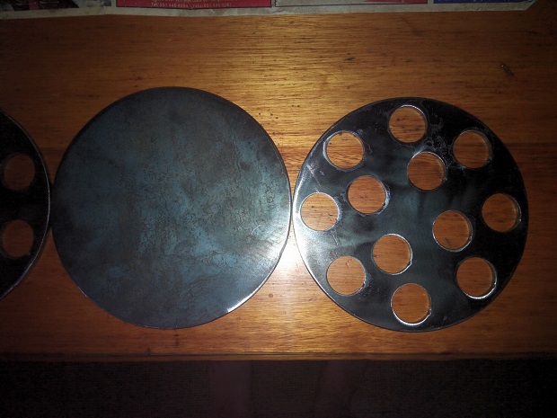

I found this afternoon while welding the top flanges on the retort for where I will feed the raw material that it looks like the flanges warped a bit from the heat. It does not completely sit tight against each other.Most probably because I`m not really that good of a welder.
For my next project I will take all the parts to be welded by engineering works.
