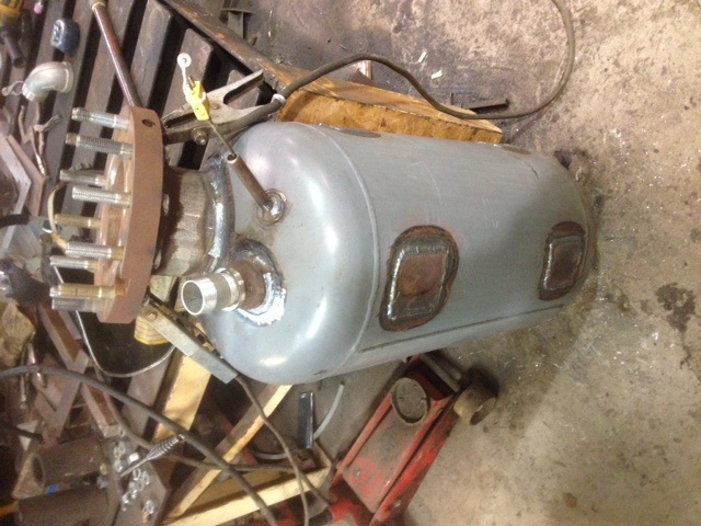

Hello all, finally started my unit
Here are some pics of the beginnings of my unit. Unfortunately I missed Jetijs presentation of what plastics yield and types. I would be very interested in seeing it. If its at all possible I would appreciate it very much. I own a metal recycling facility just outside of Ottawa Ontario Canada. Anyone from this area should be able to figure out who I am just by looking at my user name but if you would like to email me that's fine too. My email is [email protected] the pictures you are looking at are of a prototype unit. Once I have experimented enough I will be using a 1000 lbs propane tank stood up. I plan to heat it with 4-6 gun burners from furnaces and use the oil produced as fuel. I would like to know if anyone near me is attempting these projects as I have almost 60 acres of equipment to harvest parts from and literally 1000's of tons of steel to work with. Anyway a big thanks to everyone on here who contributes and keep up the excellent work.
Ed
I found band heaters that were designed to fit around a 200L drum. Often band heaters can be linked back to front to make them go around a larger diameter. Any size can be ordered though from the makers.

Welcome, EdCarron, nice work, decent flange, very good. Your retort should work great as long as you get your heating and insulation right, then condensers, and a water trap, and you are good to go.Originally posted by EdCarron View PostHere are some pics of the beginnings of my unit. Unfortunately I missed Jetijs presentation of what plastics yield and types. I would be very interested in seeing it. If its at all possible I would appreciate it very much. I own a metal recycling facility just outside of Ottawa Ontario Canada. Anyone from this area should be able to figure out who I am just by looking at my user name but if you would like to email me that's fine too. My email is [email protected] the pictures you are looking at are of a prototype unit. Once I have experimented enough I will be using a 1000 lbs propane tank stood up. I plan to heat it with 4-6 gun burners from furnaces and use the oil produced as fuel. I would like to know if anyone near me is attempting these projects as I have almost 60 acres of equipment to harvest parts from and literally 1000's of tons of steel to work with. Anyway a big thanks to everyone on here who contributes and keep up the excellent work. [ATTACH]14181[/ATTACH]
Ed[ATTACH]14181[/ATTACH]I have been running various blends of waste oils and unleaded gasoline in a 1983 Chevy G-20 van with a 6.2L diesel V-8 engine, with a Stanadyne Rotary DB2 IP since Feb, 2007. I have started the engine with no difficulty and no block heater on an 80/20 (WVO/gas) blend down to 0F (-18c). I have found that by blending as little as 15% gasoline in the summer, and as much as 50% in the winter, my engine starts and runs as if it was running on diesel fuel.
