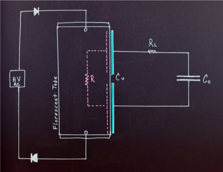

        • This is the basic diagram of the circuit. There is a resistance in the tube as well as the load. This is important to consider since when the capacitor is changing, the amount of power through this circuit loop will transfer the power in proportion to the resistance's values.
          The voltage source is assumed to be a high voltage sinusoidal AC signal. The diodes are there so that the tube lights up on the positive part of the cycle and OFF on the other part of the cycle. This is needed to allow time for the variable capacitance to completely change value.
          Should look something like the clipped signal below but the signal should be something more like a 3kV max and running around 30 kHz.
          • Silvertogold, great post, thanks! I plan on building this very soon, once I get some parts.
            • I actually wouldn't recommend anyone building this circuit until they've really gone through and gained a good understanding of how this thing should work. The reason being is that if you do, you probably won't get it "working", get frustrated and just think it's another "free energy" device dead end.
              This circuit works on some pretty basic traditional electrical principles that are fundamental. There are no "radiant spikes", "scalar waves", "voodoo meteors from Mars" or some other non quantifiable mumbo-jumbo in this circuit.
              But to get it working you've got to understand how it should operate from a traditional electrical component view. Because the design and operation of a working device takes some thought and time to do it right.
              I have not built or tested this circuit in full because I don't have the parts to do it properly and from what little I have done with an actual build, I know that it needs lots of attention to extreme high voltages.
              So understand the circuit fully before you try building it.

                            As I've stated and seen in the equations, the voltage on the static cap (if the cap is large enough) does not vary very much (less than a volt in correctly designed systems) so it could easily be replaced with a battery. Delivering a current on one cycle and being recharged on the next.
                            I guess that power converter could be an inductive device but I don't think it's the parametric variance part of the circuit. I believe it's the load component that converts the power into a more useable form - hence the term "power converter". Also he explains that the parallel circuit is connected through this power converter, this places it exactly where the load should be.
                            One thing I don't think many people get that Eric pointed out was that the unit for current (Ampere) and the unit for voltage (Volts) are not comparable in size. A fairer scale representation is that 1000V is more equivalent to 1A. So people aren't use to working with high voltages but ok with high amperages by scale.
                            I think we are seeing this with the capacitance variable machines vs inductive variance machines. People don't know exactly how to work with these high voltages.

                              I'm studying a little on this inductive variance machines as you've posted to this thread. Thanks for the information. I guess I should also review that video Eric and Peter did on that inductive machine, been a while since I saw it and that was before I had any idea about parametric variation and energy synthesis.
                              I wonder if Bedini's SSG machine is not just an inductive parametric machine? The energy is transfered from one battery to the next but as Bedini always said, the extra energy is in the turning wheel. Could that extra energy be conversion from the variable induction?

                              • I think it doesn't have to be parametric in this sense even. Take a DC-DC converter for example. One coil when shorted convert large current low voltage into spike of high voltage low current.But what if we make a little twist and create some strange coil.Bifilar,trifilar, multimulti etc.
                                The only remaining aspect is to find a way to forward all spikes in one direction , store in capacitor and discharge again into the same coil and again and again as we have hit the barrier - everything is full of moving current in one direction ... The only our enemy is Lenz law and schematic thinking.
                                Think about Tesla and snow ball running down the hill.
