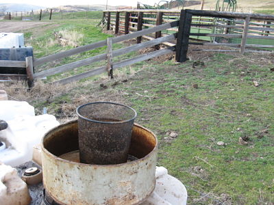

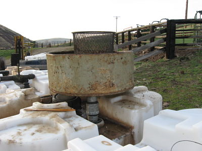

                          I thought i would take some more pics and talk here about picking up the oil and showing what I do with it once back here. I pump the oil off a 330 gallon tote I carry on the back of my truck through a filtration system I will show in the following pics. The filter system will also work with a drum instead of a tote as a drum also has 2" pipe thread in the bung. The filter is system is made up of a cattle feed bin which is nothing more then a 55 gallon barrel cut off about 16" below the top of the barrel and turned upside down bung facing down. A 2" pipe nipple is then screwed into the 2" bung at the bottom of the vessel and that is then screwed into any 2" bung in barrels or totes or any other holding tank. A wire mesh trash basket (Walmart $8.00) is then fitted with a 1/2" bolt in its base. A hole is drilled in the center of a steel cut off barrel and a 1/2" nut welded to its bottom to receive the bolt in the center of the trash bin so it can be secured down, this way it can not fall over if a pump handle and hose is attached. The oil is then pumped through this mesh and is caught in the giant funnel and directed down the hole into your holding tank.
                          This is the 1st stage of filtration to get all larger chunks and crumbs out of oil. This also makes good chicken feed as they love it.
                          The second stage is to then run the oil through it again but this time with a sack made of bridal veil material, or you can purchase paint filter sacks from most hardware paint stores...make sure the sack fits the inside of the basket...the basket is now going to serve as a rigid frame to support the sack so the sack can filter out smaller particles.
                          I filter out 330 gallons at a time so i do it in two stages as then I can usually do 330 gallons before i dump the contents of the trash mesh can. the finer mesh may have to be cleaned a few more times in this amount of oil as it will clog up faster. For less amounts of oil I would just start with stage 2 filtration and then be done with it. Like say a 50 gallon load.

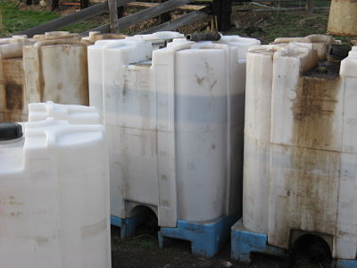

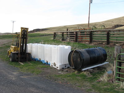

                            The pics from my previous post do not show the whole 330 gallon tote the filter setup was sitting on, just the very top.
                            What I then do is pump the contents of this tote into yet another tote so it may sit for a time and allow all the silt, heavier fats, potatoe starch and other extra fine food particles to settle out. I could have just as easily moved my filtration system to another tote, but because of the way the totes are built with a recessed 2 inch bung this is more of a hassel then it appears. If for instance it was a 55 gallon drum instead of the tote I would just move it to another drum and save the time to pump it.

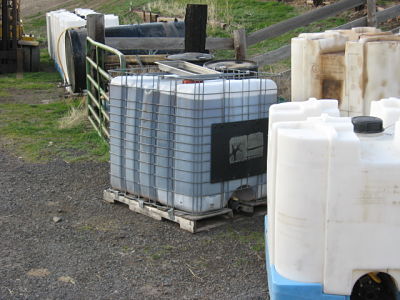

                            The attached pic shows some oil I filtered late last year around the end of October first of November or there about when the temperatures were dropping as winter was approaching. The oil seemed to be very creamy and this meant that it would not be until the temperatures would again be warmer for the separation to be more complete. This tote will no doubt have to see a week or so of 80 plus deg. F before most of the clear oil floats to the top and most of the silt can then settle out. Cold weather means the oil gets very thick. If its real thick then nothing settles but is suspended in the buttery mix. In the pic you can see the creamy oil line below the darker clear oil. This darker section will increase as the temperature rise and nights not get so cold. This pic was taken yesterday and temps still drop to the low 30's at night. Last night is was 30 deg. F, 2 deg below freezing. Day temps hit between high 50's and mid 60's. As the days get warmer the sun will shine on and through the simi-transparent totes and give me a solar heating effect in the oil, thus allowing it to further separate. Since I have plenty of time and patients and plenty of oil I am in no rush to let nature take its coarse and do the work for me. I could chose to heat it up myself and then run it through an expensive centrifuge but this is more work and more energy expended doing so, I have tried that route, Its simply easier for me to just filter it and let it set in the sun.
                            Here is the pic of the cream line and darker part of clear oil floating above it in a 330 gallon plastic tote.

                                Once the oil has set in the hot sun for a few weeks and I will see that the cream line will be about 25% of the oil above it. I will then pump it off the top making sure to not pump the silt or creamy layer with it. This is easier said then done as any suction from the pump wand will sometimes pick up some of this cream. Therefor its pumped in yet another tote or tank to let it settle some more. Attached are a few pics one showing the black steel 600 gallon tank with 2 points to connect a hose and pump to. One cam lock and ball valve is located at the very bottom of the tank and the other at about 4-5" up on the side. Notice also that the tank is on a forward incline slightly so any silt or water will migrate to the lowest part of the tank at the front where my valves are. Water will always be at the lowest point as oil always floats on water. This is true also in previous totes as they settle. If your using a bottom accessible system with ball valves like these shown at the bottom of tanks, always make sure to drain off any water before winter sets in...water in these valves can freeze and break your valves causing the oil to drain out once it warms back up. If this happens hopefully you will catch it when the creamies and silt are thick, or you will have one hell of a mess on your hands. If you spill oil remember its veggie oil and or fats and is biodegradable so unless its a huge amount its only a problem because of the mess.
                                Once this final settling stage is done I pump it into yet more totes for long term storage or to make into bio-diesel. This oil is for all intents and purposes as good as any new oil fresh pressed from oil crops to make bio-diesel out of. It may seem to be a lot of pumping but remember pumping oil is not a lot of work for me, it is for the pump, i just have to stand around and watch it to make sure nothing gets over filled or spills. NEVER LEAVE A PUMP UNATTENDED PUMPING OIL, I can not stress this enough...as soon as you do Murphy's Law sets in, I need say no more.
                                Notice also my nifty clear poly sight tube so I can view tank fluid level at a glance on the black 600 gallon tank. This also serves as a good indicator as Im pumping so I don't over fill the tank. Sight tubes of this type will react slower then your pumping, so always stop the pump when close to the top and let it adjust before adding more. This will help you save your valuable oil stock and lower your loses.
                                Here is a few more pics.
