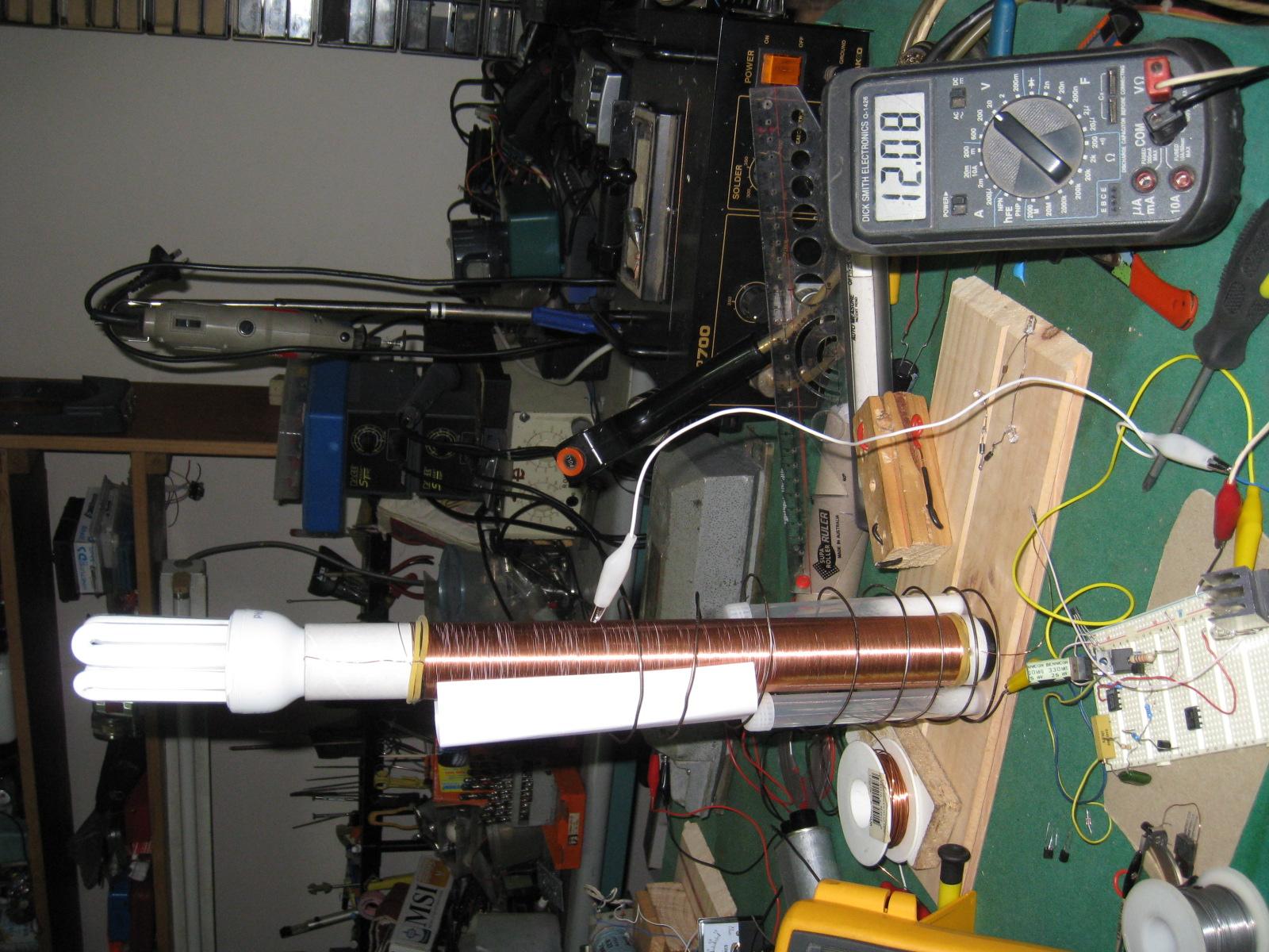

                    • Hi Guys,
                      Thanks to all for suggestions.
                      I have gone up to a TIP3055 and heatsink.
                      I have tried several diameters of L2 and settled on a 75mm 8 turn.

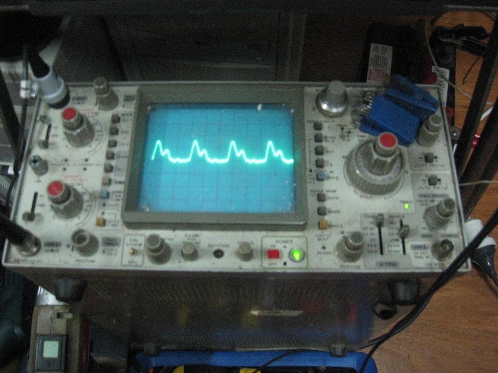

                      Our bulbs are 240v here in Australia - so I am not able to light it brightly.
                      I am yet to meaure DC current draw but running from a 12v car battery (old) voltage sits at 12.07 - 12.08.
                      My L1 is using a spool of .5mm wire and the diameter is 35mm and it stands
                      about 280mm tall.
                      Initially I found better peak voltage (via scope) when holding the compressed
                      L2 just above centre of L1.
                      I tried stretching L2 and have settled on that setup with L2 going up two thirds of L1.

                      Guys, the battery seems to have settled at 12.09 and has now been running for a couple of hours.
                      TIP3055 is warm on the heatsink but not hot.

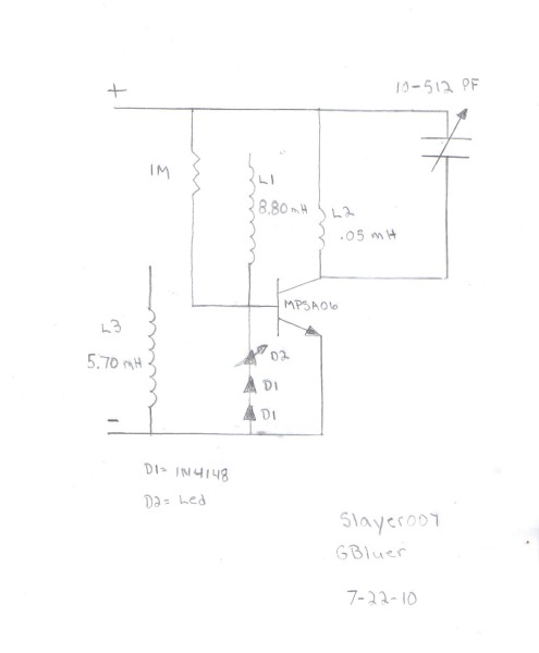

                      • For this test I added a variable capacitor across the L2 coil.
                        It's running off a 1.5v AA battery lighting 40 led's and a 14w FL.
                        Remember this the lower the voltage you use with this circuit the less current you draw.
                        Here is the video.
                        YouTube - Exiter with variable capacitor
                        • @Slayer
                          You have pobably been asked this a cazillion times but -
                          What are the dimensions of your L1 and L2 and wire gauge for both.
                          Kindest Regards, Penno
                          • Originally posted by penno64 View Post
                            @Slayer
                            This setup the L1 is 13' x 3.25' 26awg mag wire, L3 is 16' x 3.25' 23 awg mag wire.
                            L2 is a 9 turn pancake coil 21 awg plastic coated wire.
