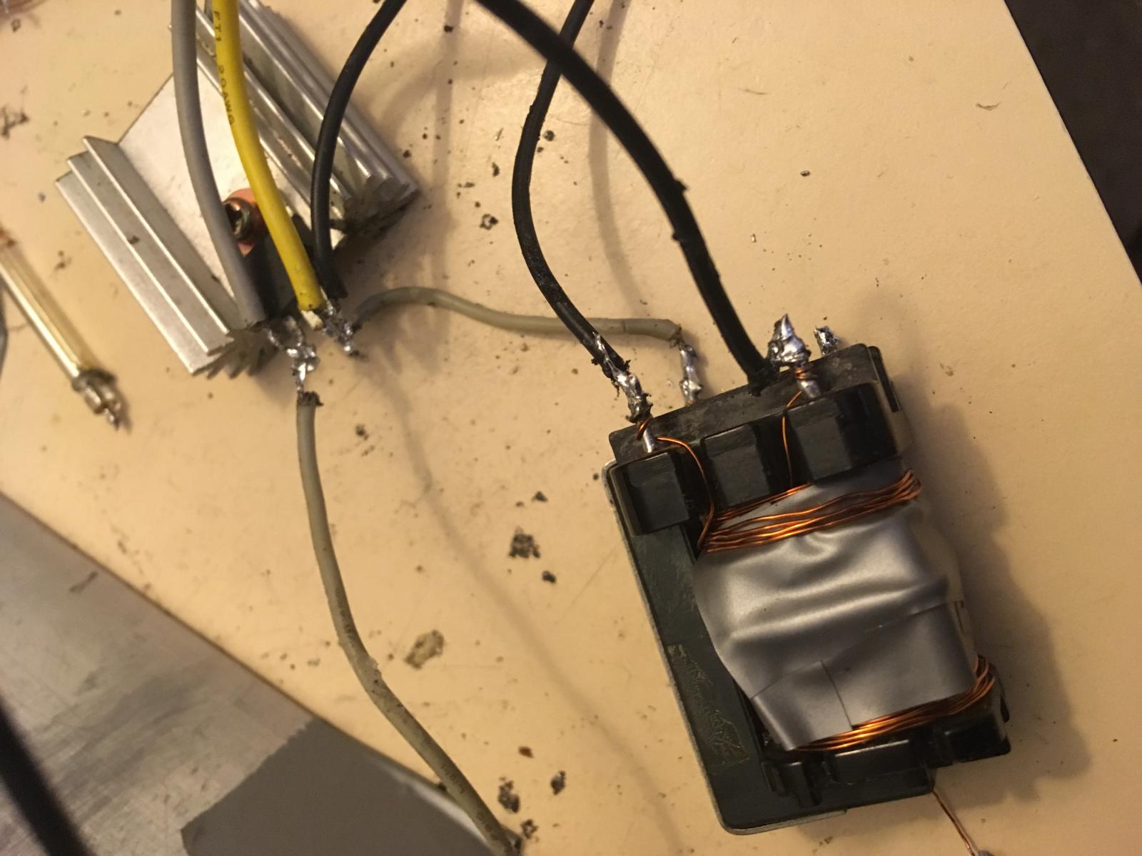

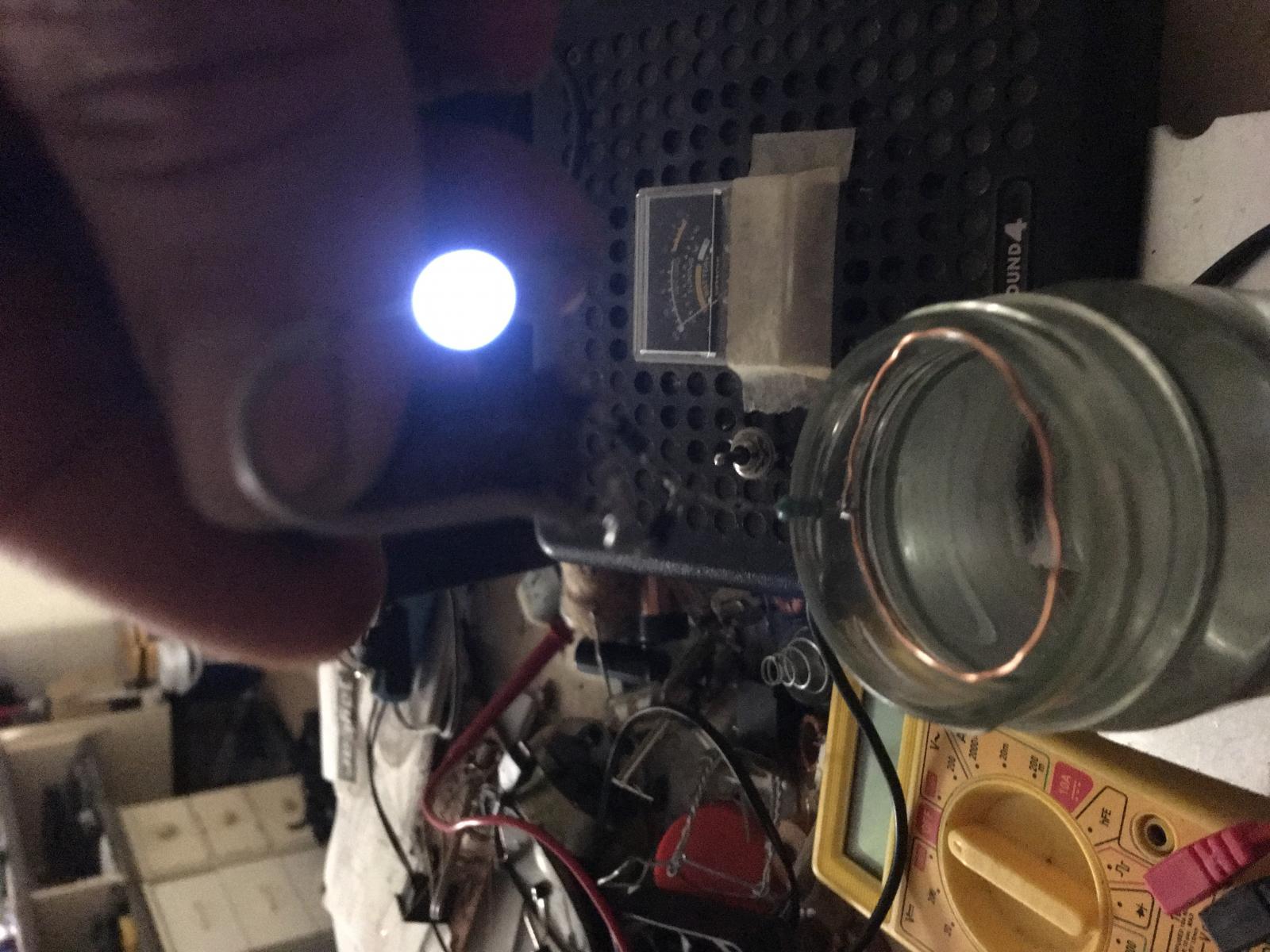

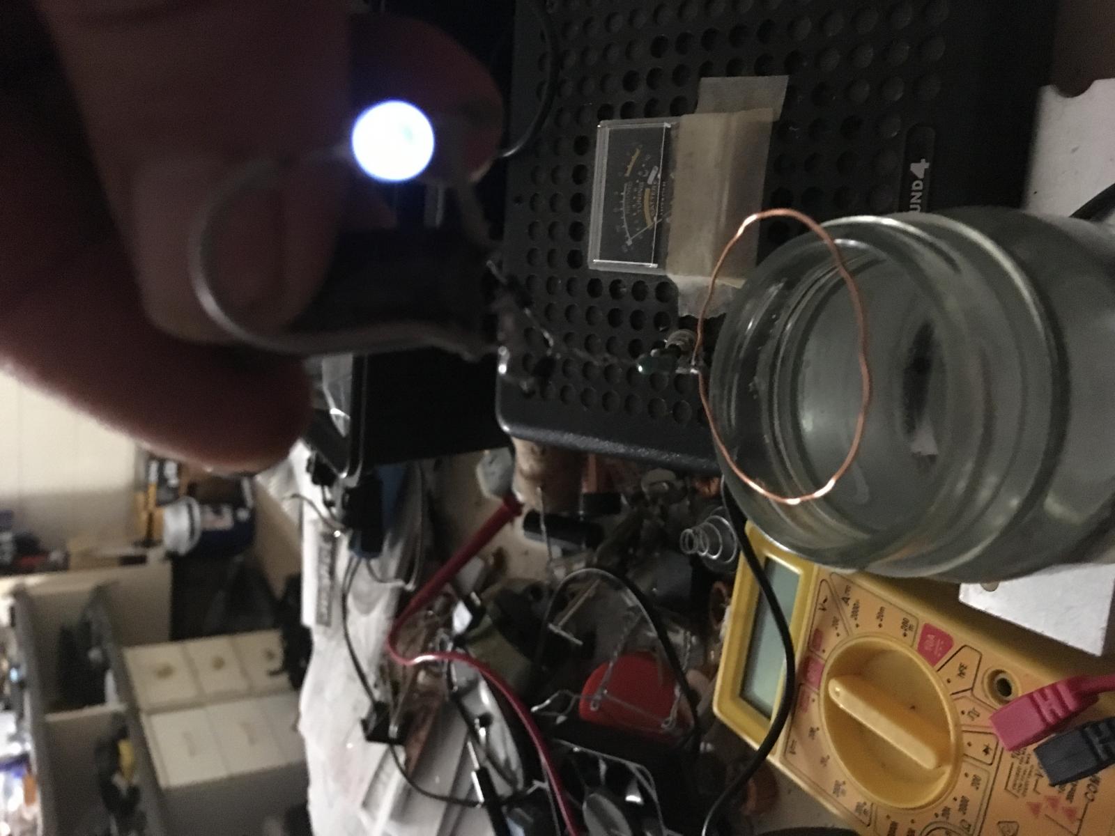

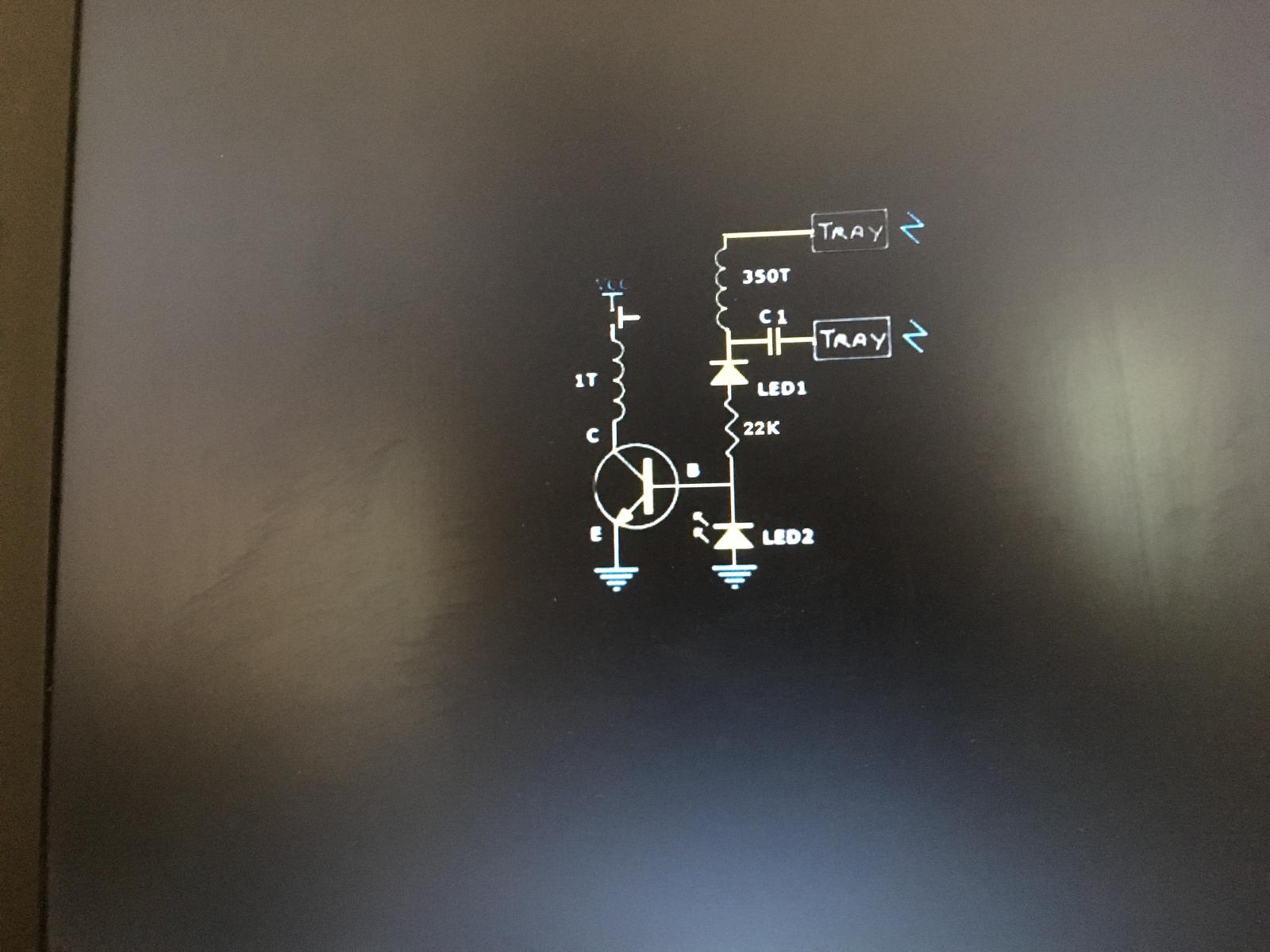

                      • Here is a rewound choke with several hundred turns of .3 mm magnet wire and 2 turns for a primary. At 3.7 v reg. With the attached circuit it is the strongest field I have seen so far, including some 12v runs. T1 is a tip 122,led1 is a bright white that doesn’t light, but still functions normally on 2.32-4.5 v dc, go figure, led2 is a dim red, c1 is 3kv 10 nf. It runs at 50 kHz.
                        — turns out there are similar kits on eBay now. Last pic. Under $4 on the slow boat from China.

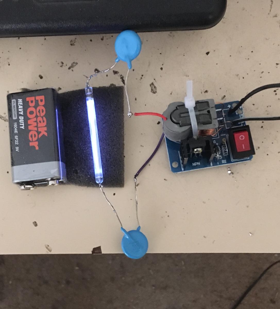

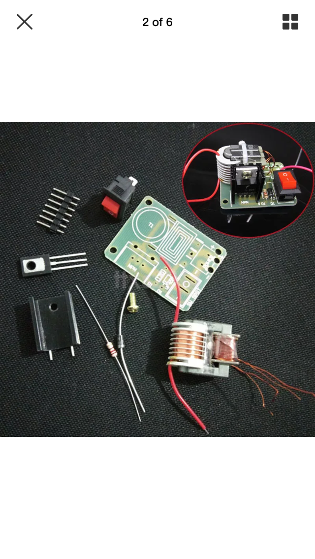

                        • Here’s my first module assembled and running. The 3 holes in the pcb for B C E needed some enlargement and the holes for the diode and resistor were closer together than neat, but it fired up first go.
                          Nice to have a floating/isolated secondary coil,instead of having high voltage in the whole circuit.

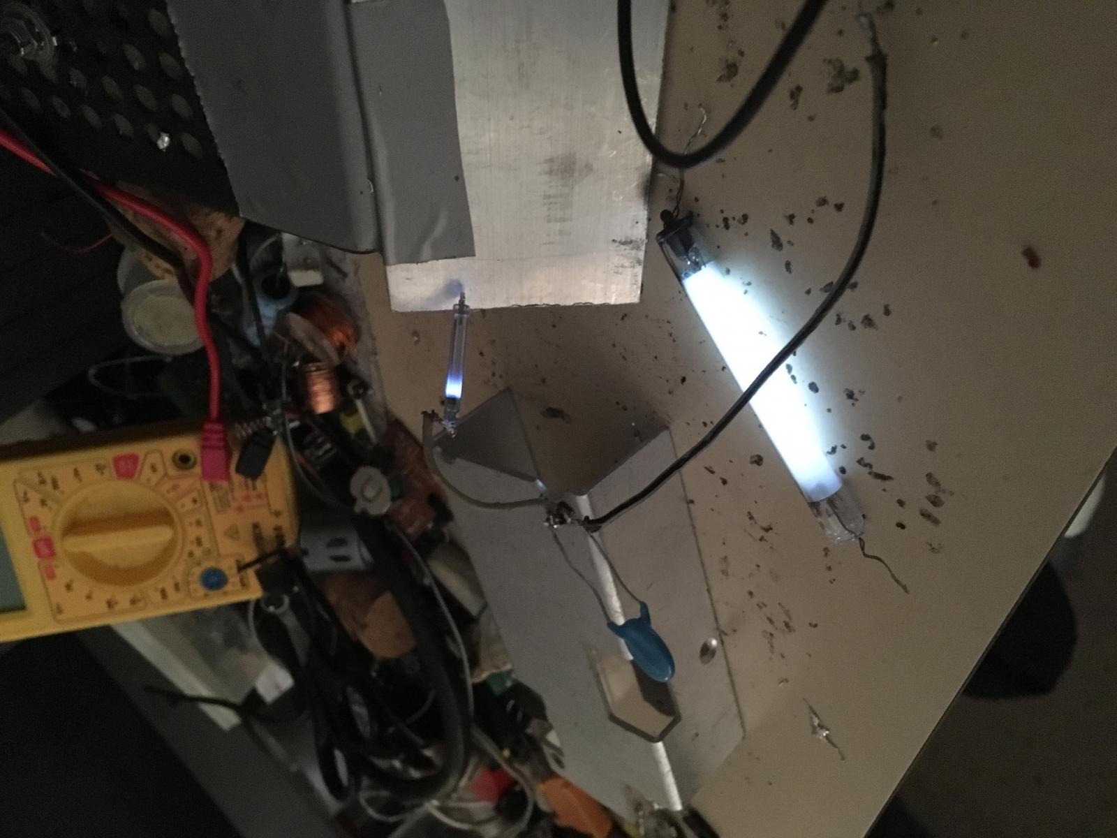

                          I’m thinking UV/safety glasses might be a good idea when xenon flash tubes are run like this.As the tube gets warm to hot.

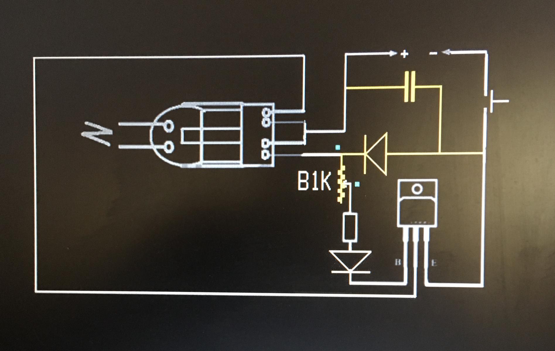

                          I added a fast recovery diode, in pic2. This sends a pulse of charging energy back into the source right after T1 switches off and the coils field collapses. The modules peak output voltage is reduced, but the xenon tube still has a steady thin arc. I have also added a low esr cap and a 1 k variable pot. To the original circuit. The cap presumably absorbs the charging pulses a bit better than a battery source would take rapid reversals. The pot Gives it adjustable output,frequency and can allow for a higher input voltage and control T1’s temp. The supplied heatsink gets hot to touch in short time. I’m waiting on a 5A panel meter to compare input and return. Ok 2 amps input and 610 ma return. It runs at 99 — 189 kHz with loads and mods I have tried so far.

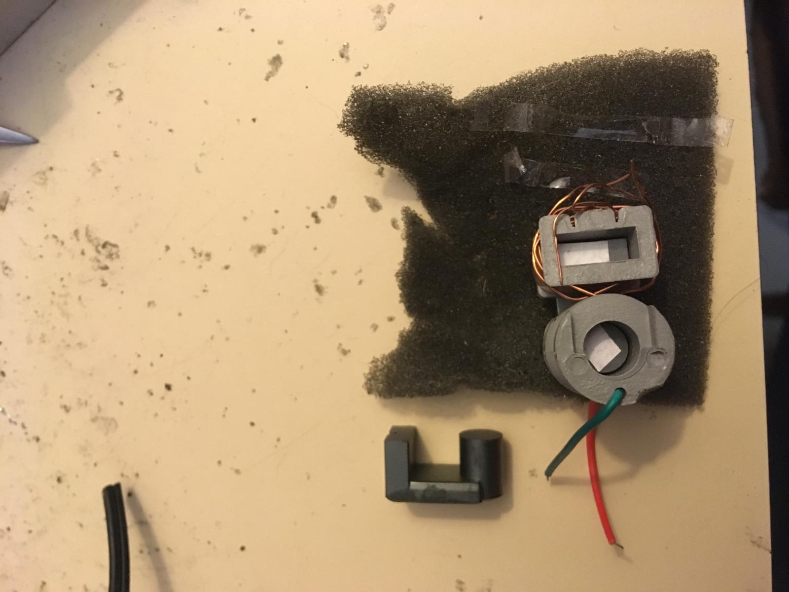

                          Looks like the secondary coil has to be potted/hot waxed or siliconed for best performance and to avoid premature failure due to arcing. The module should run silently. If it squeals, shut it down immediately and seal up the secondary coil. The core splits easily. Pic 3. The primary side has about 30 turns driven and about 35 turns for feedback. Will try 5/6 turns with a well sealed sec coil.
