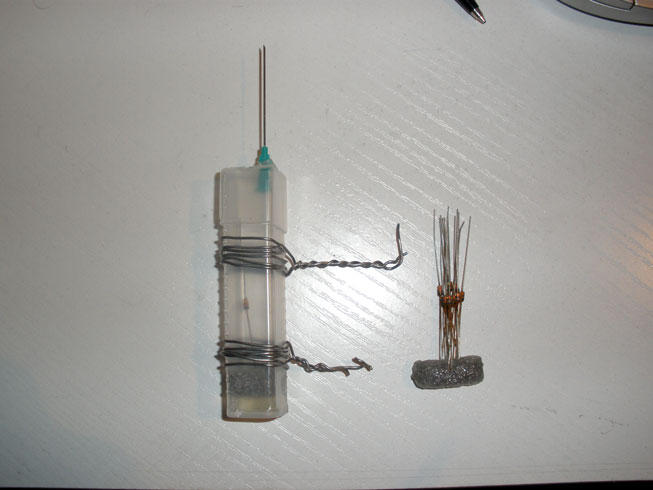

    It is good to know that we have all tried to fire this gas at the and of the needle without succes.
    i tried with 10 X 4148 and got a lot of electrolisis but no flame out of the needle.
    Yes Jonny perhaps a confine chamber is the key
    Anyway bravo and thanks for sharing
    good luck at all
    Laurent

        I worked all day trying to get something to burn and had no luck --again. There is something very strange going on here. Jonny you might be right about a "combustion chamber" being needed. Woopy my needle setup was about like yours and I got nothing to happen.
        This is the kinda thing that keeps me awake at night.

          As we work with HHO and Hydrogen in large qty (15 to 20 LPM) all day, might I suggest a few things....
          1. Put a bit of clay in the end of the needle to allow a "SMALL" bitt of pressure to build up....then pull it off and with LOTS of safety precautions, light it.
          2. Don't let the pressure build up past 15 PSI, just in case it has any oxygen in it. It WILL go BOOM!
          3. If you have any "air space" above the liquid, remember it has to displace or at the very least mix to a combustible level.
          4. One of the test we do to determine (crudely) if O2 is in the mix is to fill a ballon with the gas....if it poooofs, (yes that's is a lot of o's), then it is H2. If it has a sharp bang, it is HHO, I will see if I can put a vid together Monday to demo if needed....The point is, a ballon might be the better way to test, by letting the system fill one up, then light it. If you are getting only O2, or higher concentrations of O2, then it will simply light with a "bright" burn and ignite any surrounding plastic etc, i.e. the ballon.
          Once again, PLEASE be careful, and I am speaking from EXPERIENCE, wear ear protection as well as eye.... One day, when I want to review it again, I will release a vid (our internal cameras) of me pushing one of our systems to 20X past its limit...the blast threw me 8 feet in the air...Lost my hearing in my left ear....and when I woke up....you get the idea,...so please take care.
          Safely,
          Bob
          P.S. Didn't mean to sound like I was lecturing,...just , we need your ideas

              Hi.I may have leaped before i looked with flame experiment as i have been looking at it again this morning and it may be an arc from the needle which ignites the plastic as it is very flamable and burns with an orange flame and i can draw a 1cm arc of the needle although i think the gas contributes to the flame but i am pretty sure there must be an arc to the plastic.Sorry if i have misled anyone but i will keep trying.Jonny

                  Thanks for the excellent description on what we need to look for and the precautions required. I built a small HHO electrolyzer awhile back so I know a little about this already. That is what is so puzzeling with the "diode-in the-water electrolysis" setup. This isn't doing what it is supposed to do ---at least the way I'm doing it. I don't get the H "pop" OR an increase in burning as from O2. I don't get anything!! The only thing that I can attribute my failure to is inadequate gas production. I'm just not getting enough gas to see anything.
