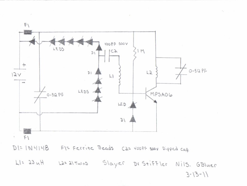

    • With this setup I have been having very good results.
      This is based off Dr Stifflers NILS setup he showed us along time ago.
      If going back to the source battery this will NOT work without the C2 capacitor.
      I have not tried different capacitors for C2 but other non polarized capacitors should work also.
      YouTube - Slayer Stiffler NILS
      • Slayer's NILS Exciter circuit
        Nice circuit @Slayer. Iwould like to replicate this circuit. Can you tell which gauge do you use for the L2 21 turns coil? What is the purpose of the ferrite beads at both poles of the power source? please.
        Thanks for the help, and I have had fun working on this circuit.

          Hello Aaron5120
          The two ferrite beeds are just there to help with the rf filtering and to help with impedance.
          You should be able to replicate this without them.
          The L2 coil is 21 turns of 21 ga. plastic coated wire.
