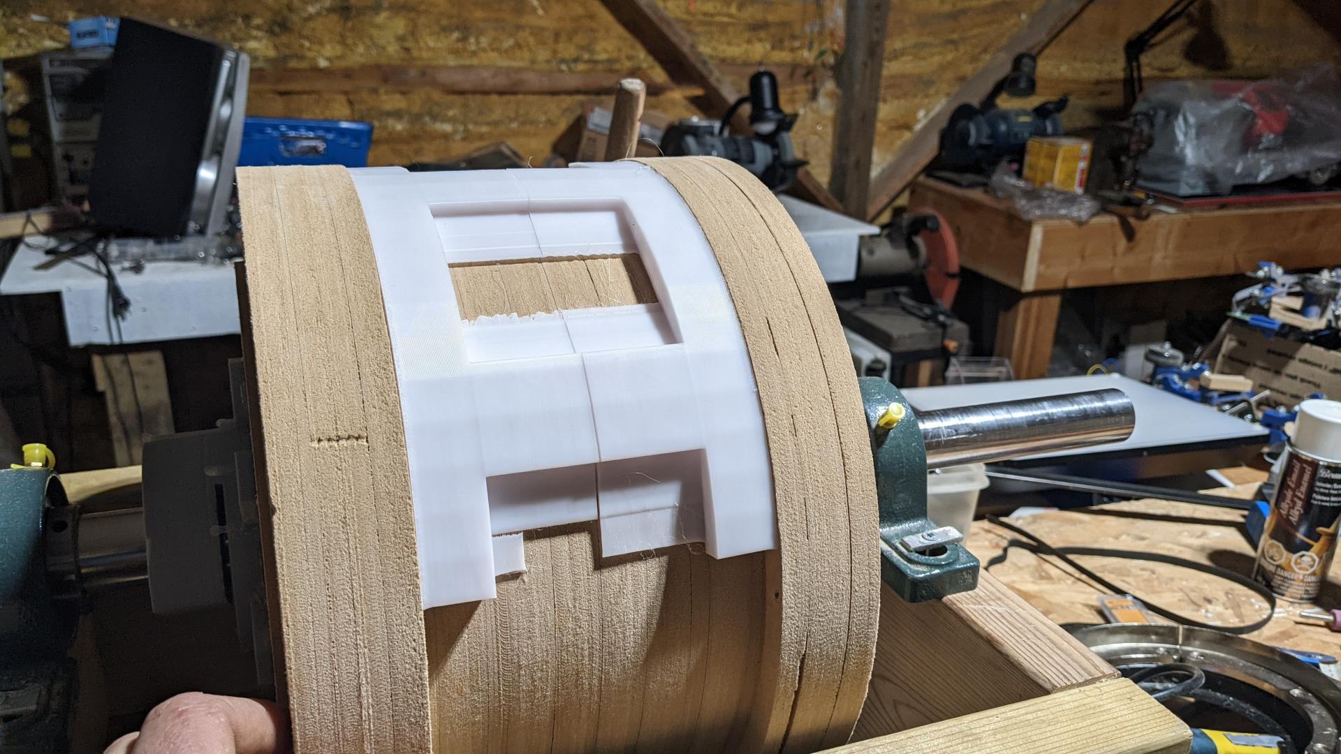

      Hi All,

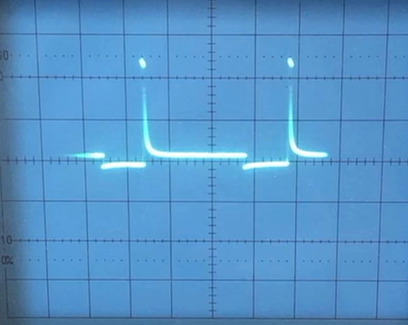

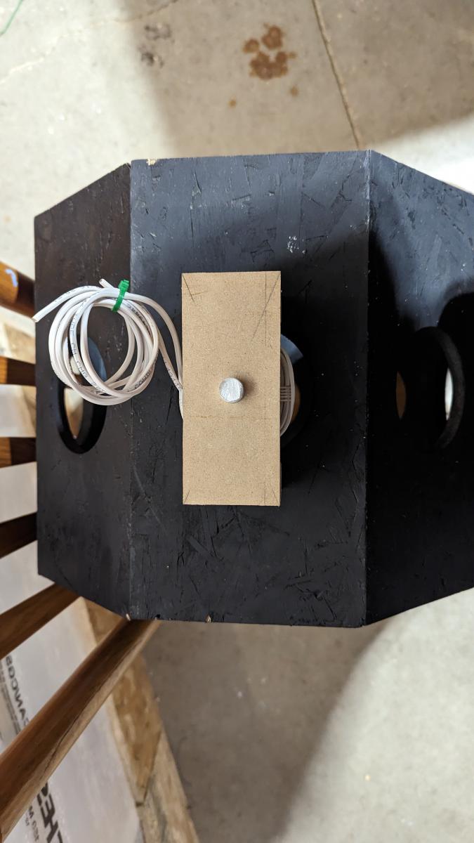

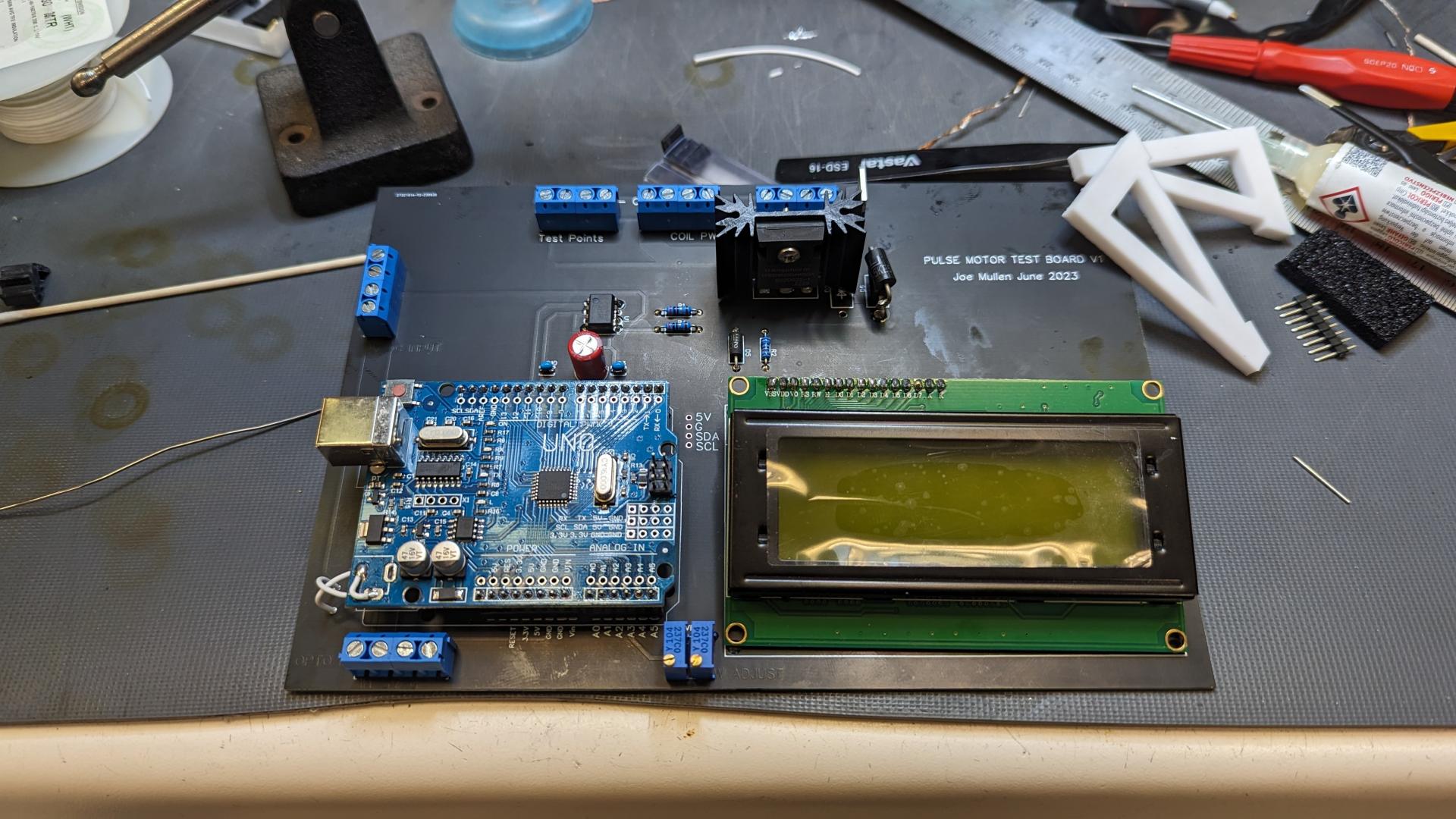

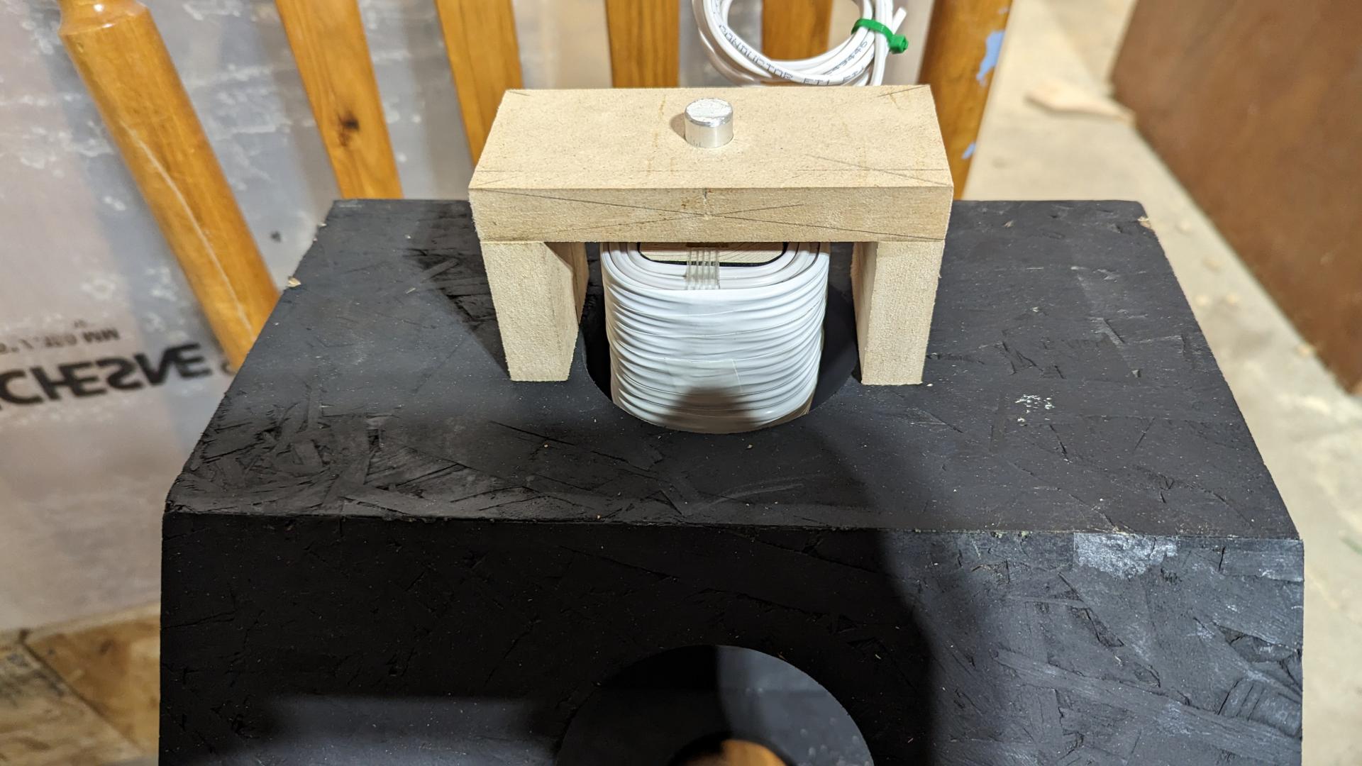

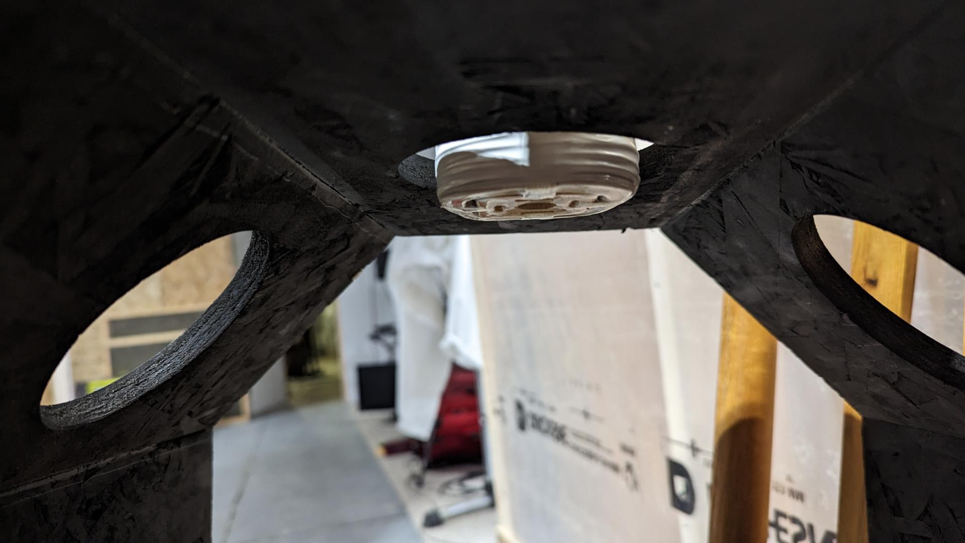

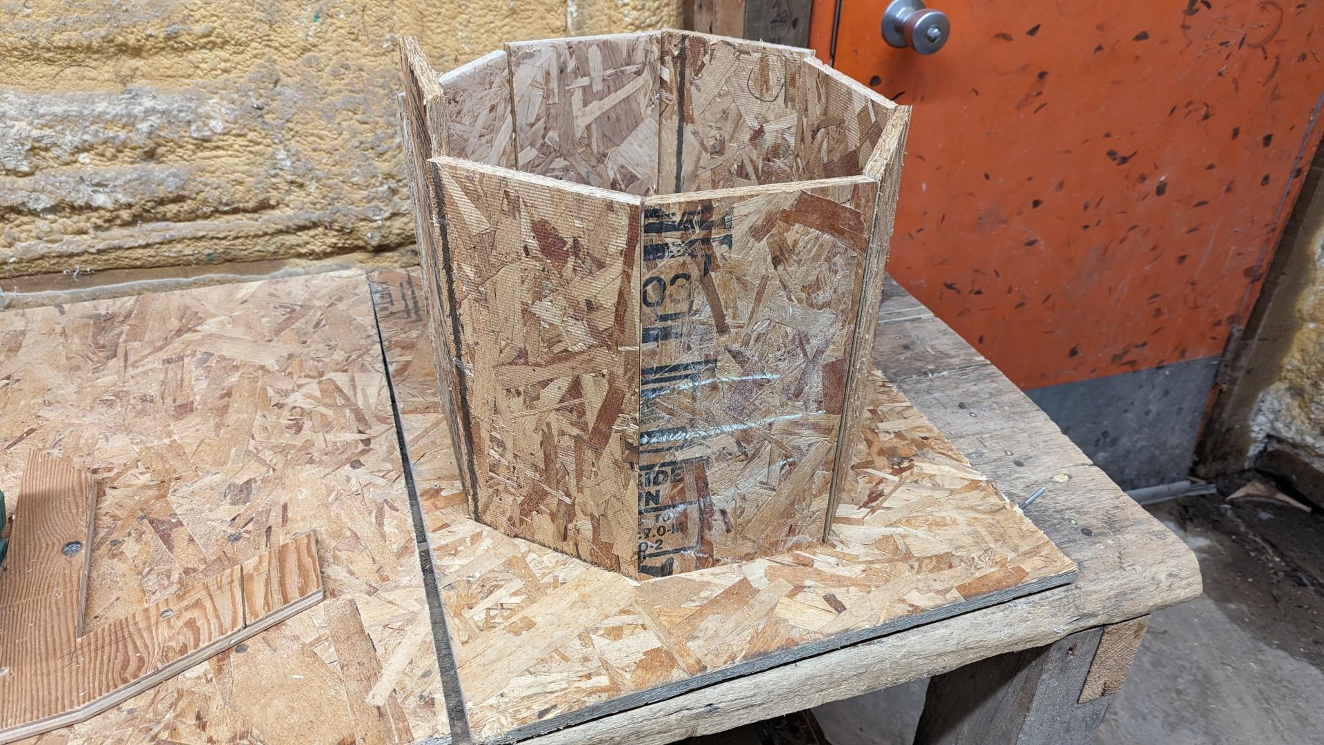

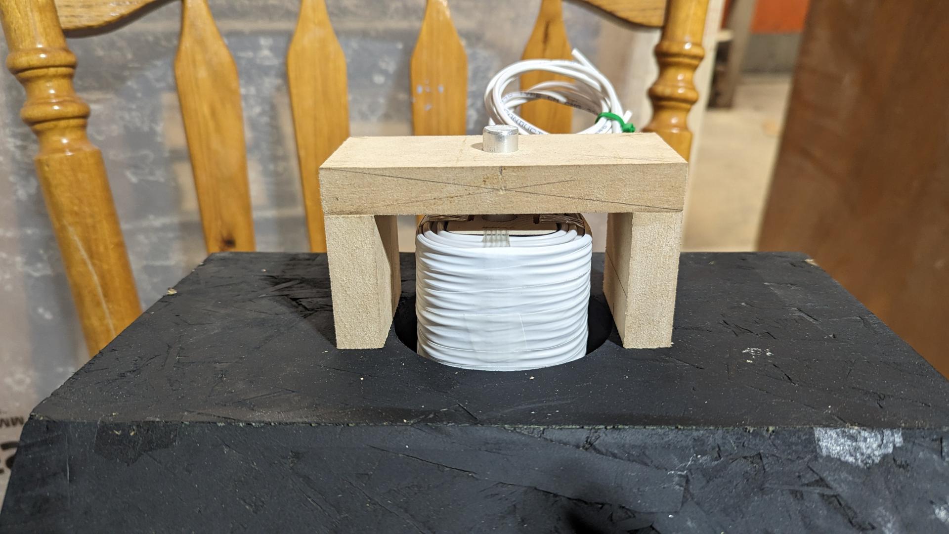

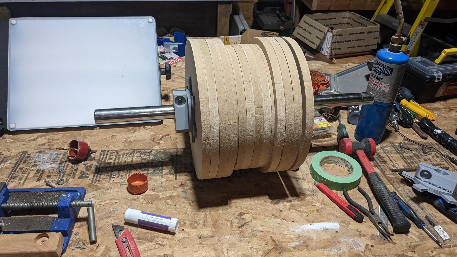

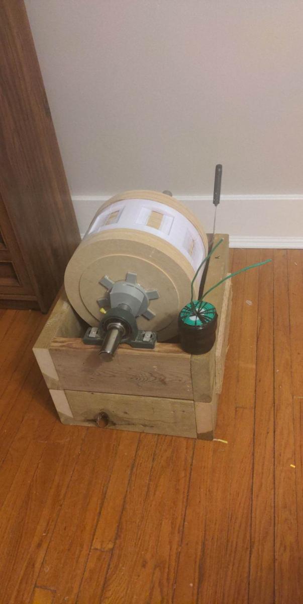

      Great work folks! I was feeling pretty lonely back in 2022 working on this lol. Aaron reached out to me to share my work so far. Here are some pics. The rotor was built from Aug 2022 to Jan 2023, since then I have been working on the switch. This year I'll be building the stator and case. This rotor is 12" dia. and 12" long. I estimate it weighs 30-40lbs. I have achieved <50ns ton and toff with 650V spikes at 24V. I am continually working on designs to push these specs even higher.

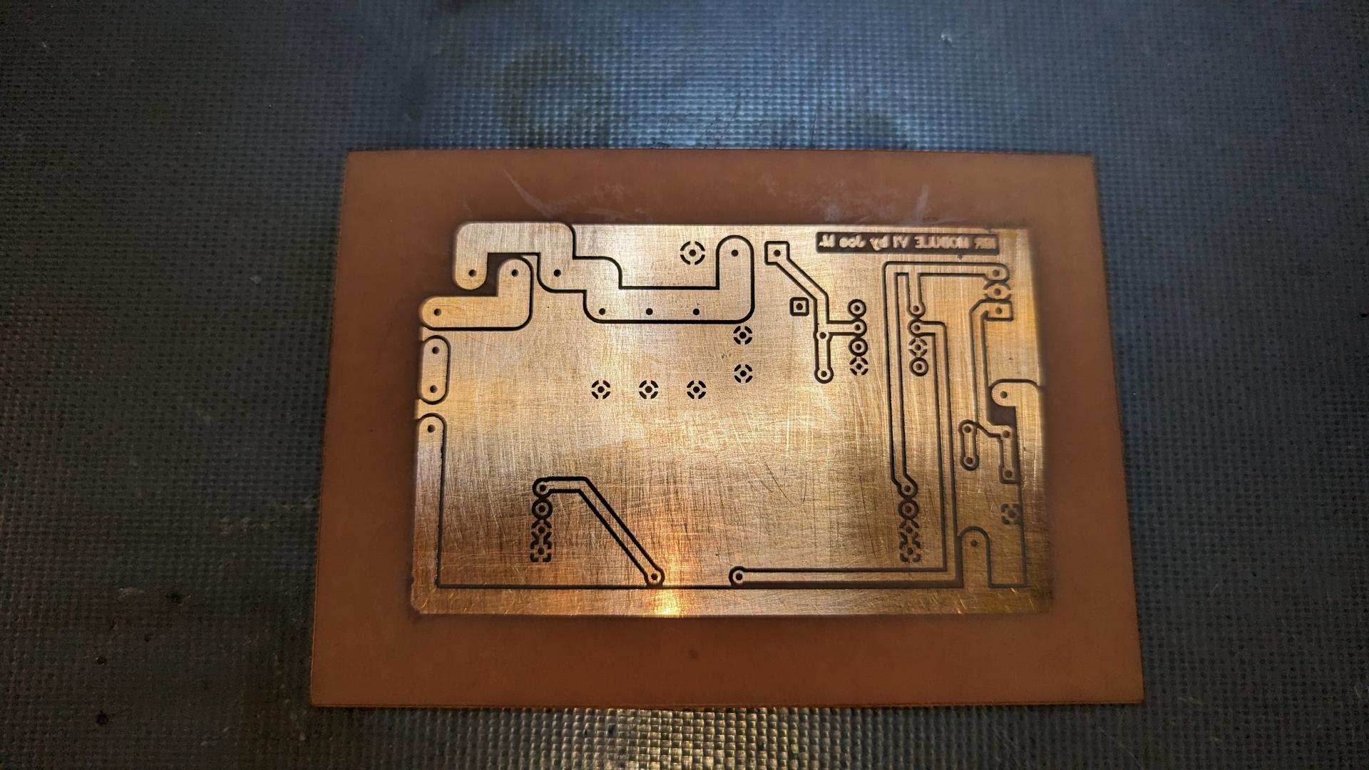

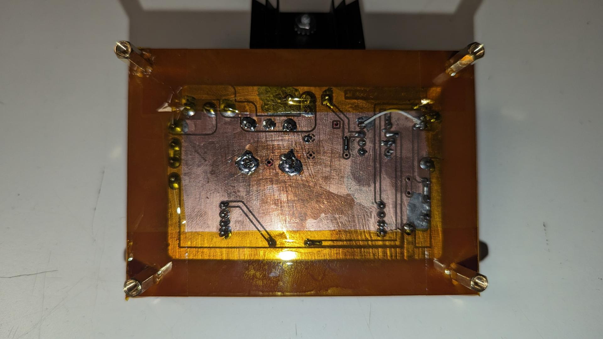

                  Couple more prototype switches I've been working on....
