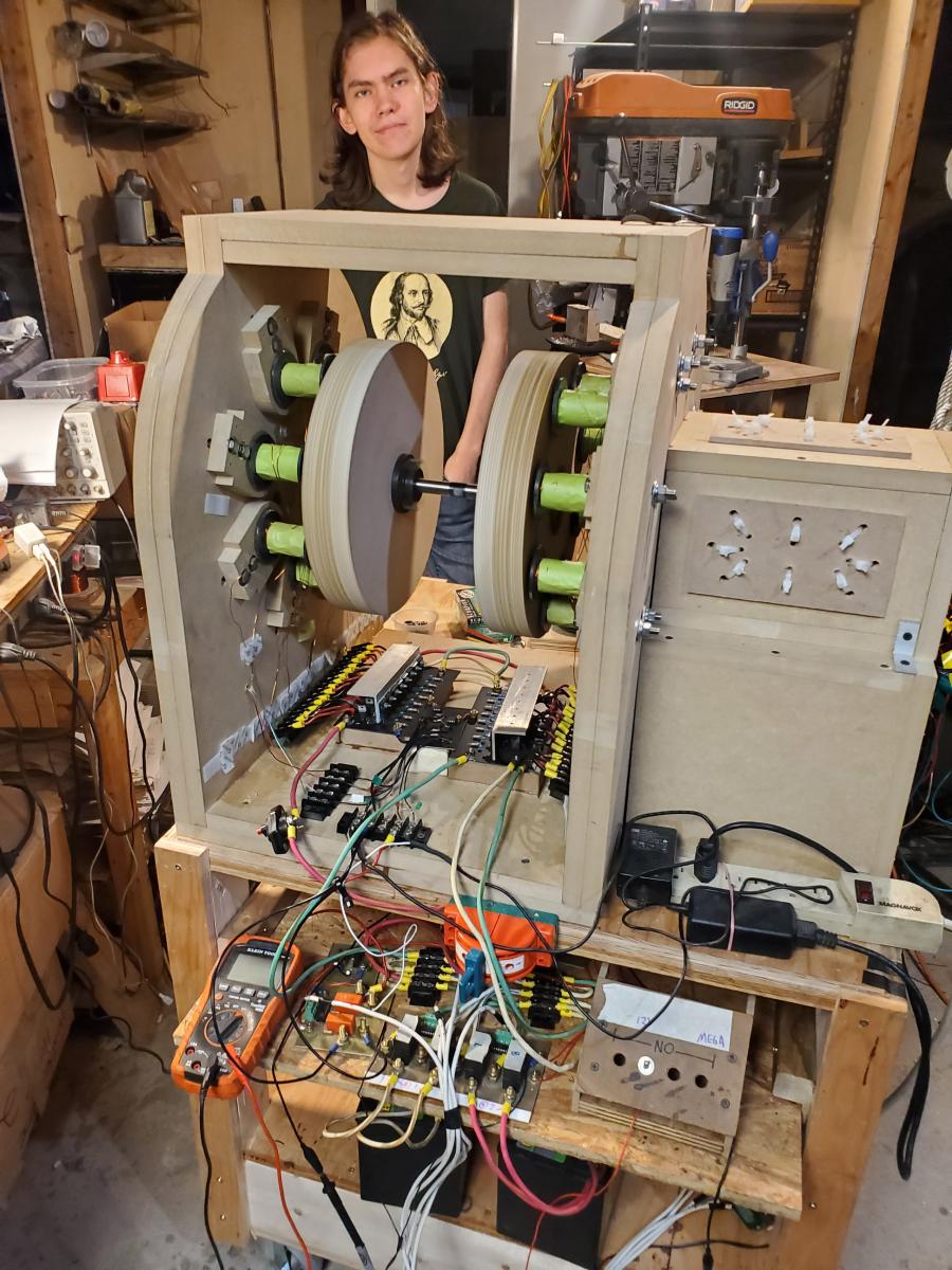

ID:	512679 upgraded to bigger wires
      Working on 6 mag generator that will go on the motor shaft rather than have a belt.
      It seems to me that a belt causes more drag than having gen on motor shaft.
      No Load she runs at about 2200 rpm so I'm looking to to stay above 1500rpm Under Load.

      The pic with my 16yr old son, Luke, is before I added weight to the rotor. The Gen on the side is a 4 mag / 4 coil version.

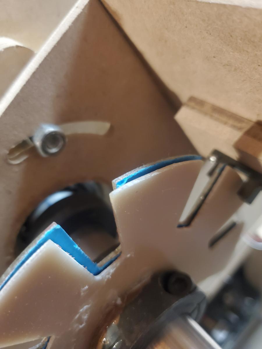

          Regarding optical switching with a slotted timing wheel... use 2 sensors. One for on and the other for off with a single slotted timing wheel. The sensors are mounted so that the flat wheel's edge goes in the groove of the optical sensor (like a disk brake caliper). The position of the sensors must be adjustable around the timing wheel to allow for the precise location of the on and off positions. The slots are straight and narrow (1/16").

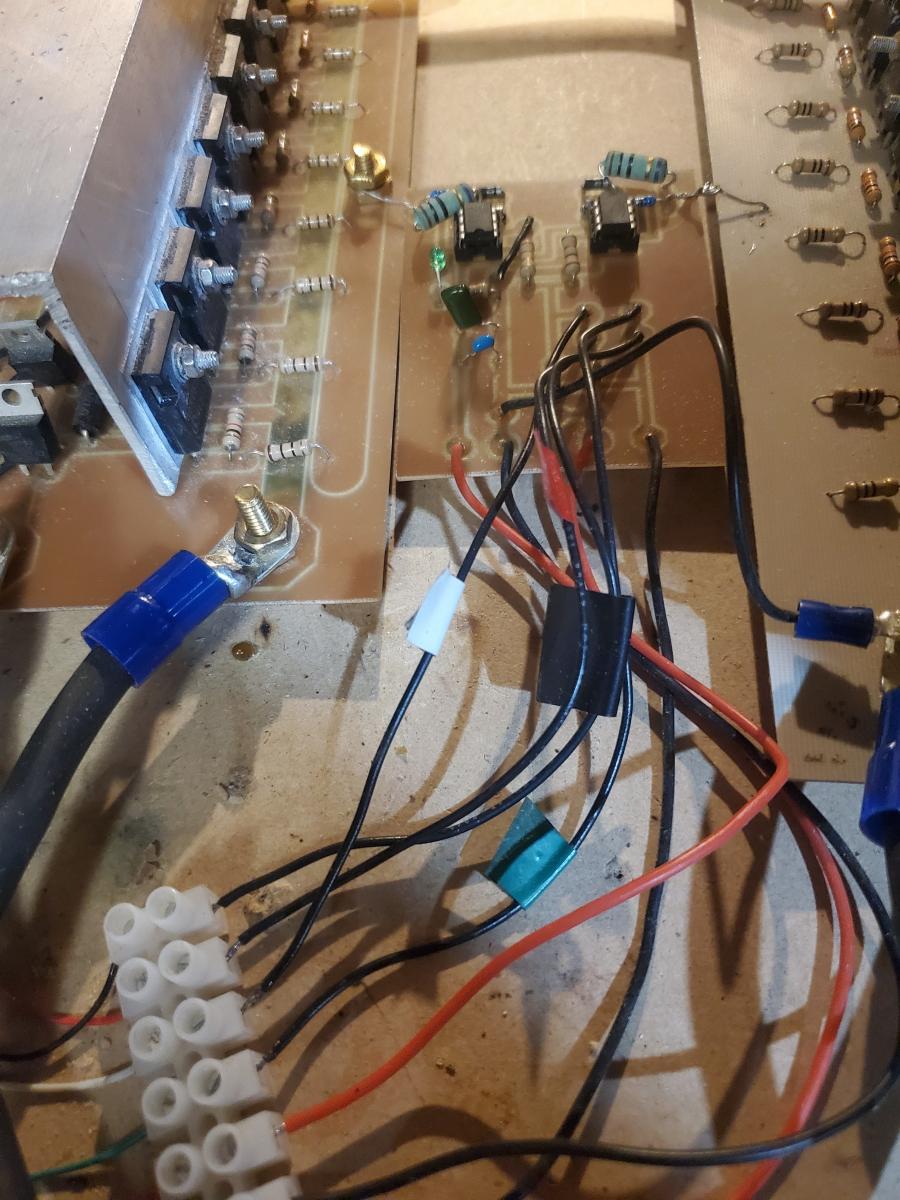

                      2ND DRIVER BRD.pdf
Name:	colored tape on wires from opto trigger to brd.jpg

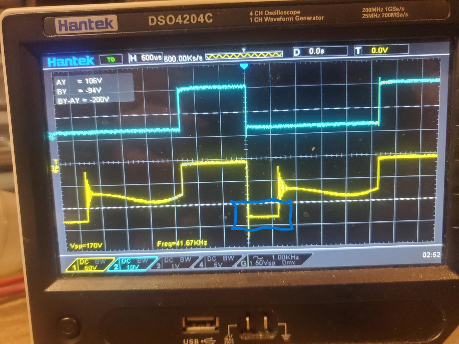

ID:	512710 Click image for larger version
Name:	SCOPE OF 2ND DRIVER BRD.jpg

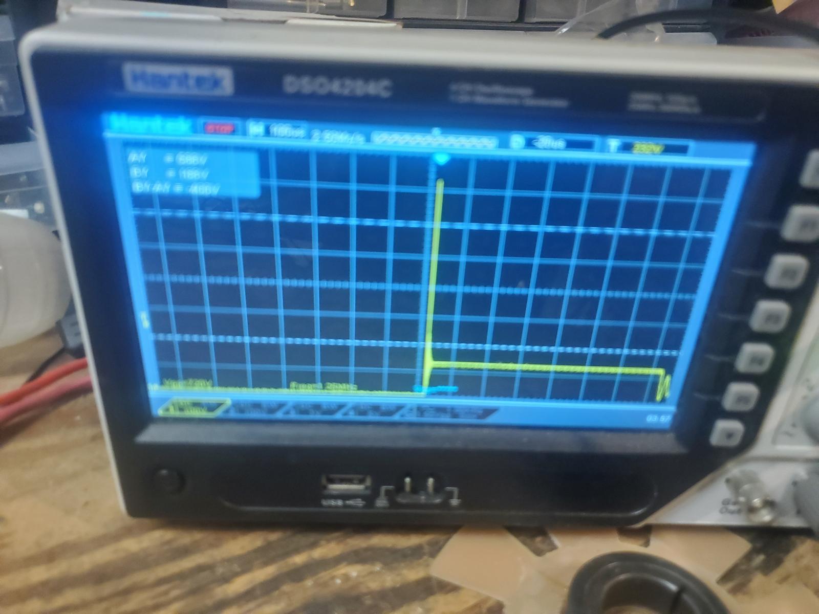

                      I'm seeing spikes over 700v Click image for larger version
Name:	over 700v spike.jpg

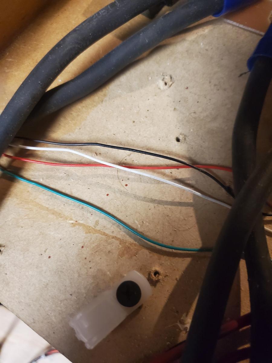

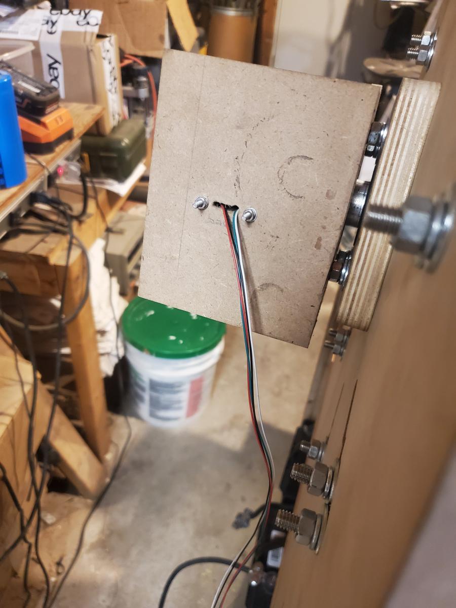

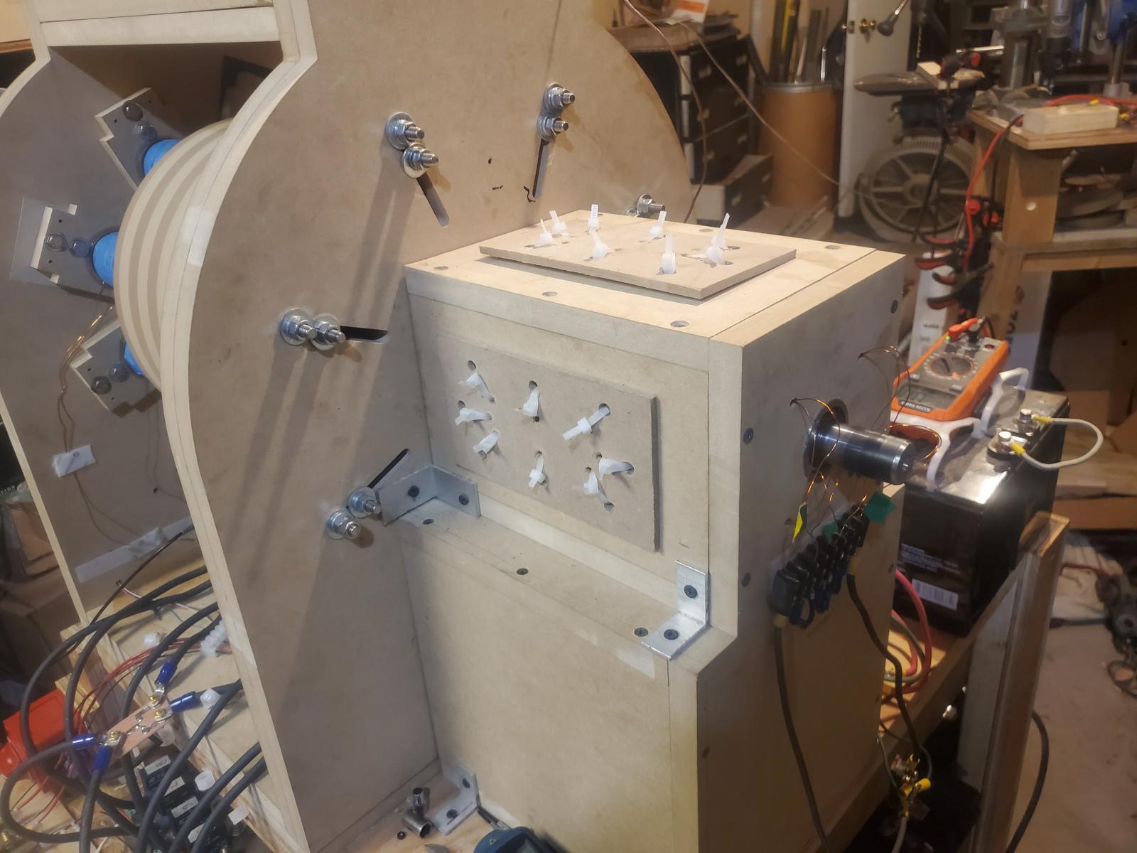

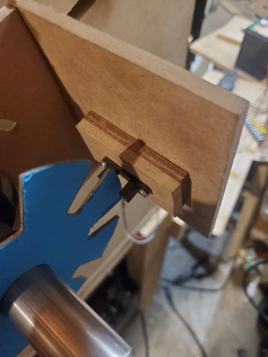

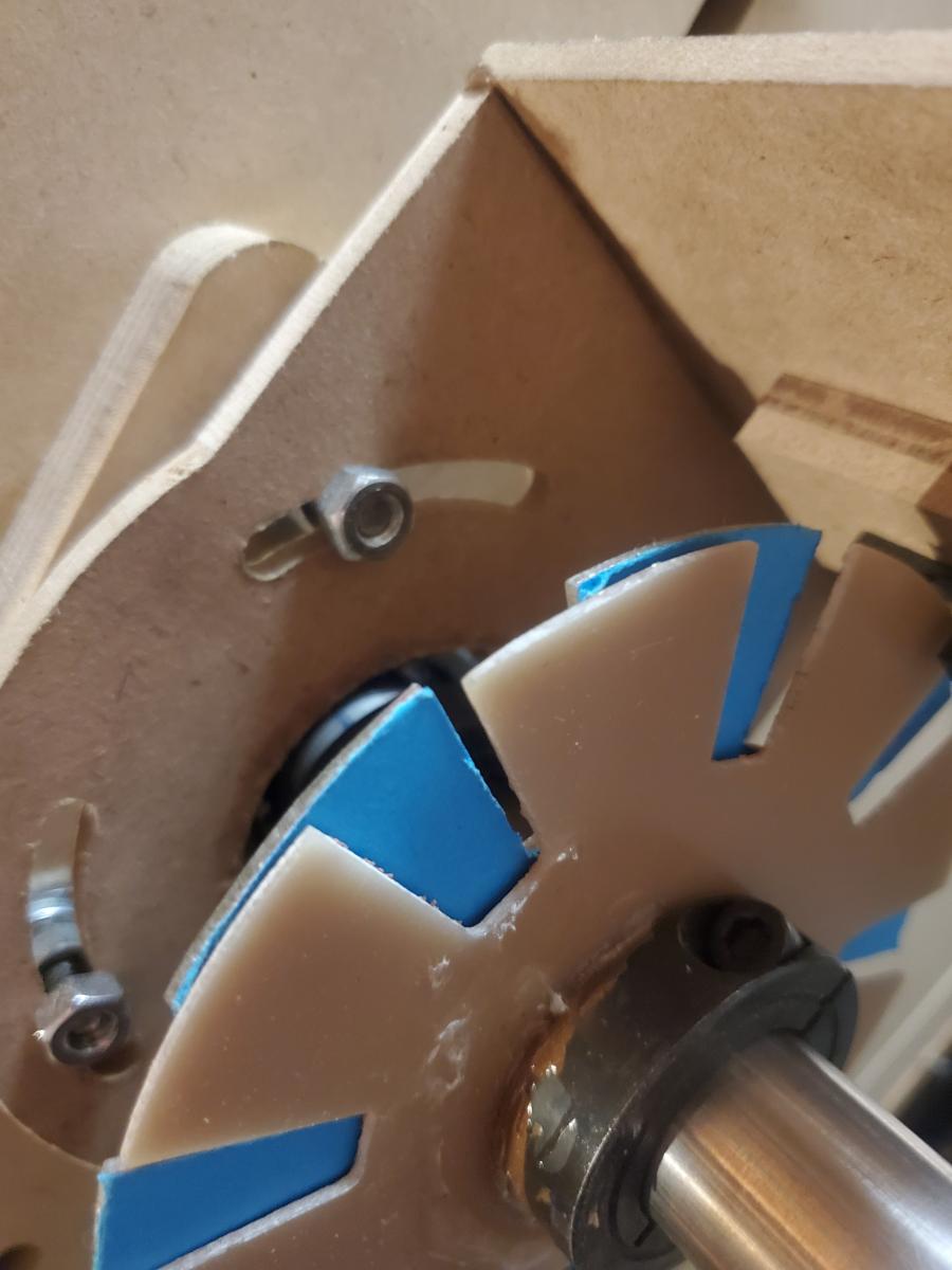

Name:	opto sw 1.jpg
ID:	512714 Click image for larger version
Name:	opto sw 2.jpg
ID:	512715 Click image for larger version
Name:	opto sw 3.jpg
ID:	512716 Click image for larger version
Name:	opto sw 4.jpg
ID:	512717 Click image for larger version
Name:	opto sw 5.jpg
                        colored wires from opto sw to board. I can use 2 timing wheels back to back to adjust pulse width. Wider width = faster = more amps.
                        I can run NL, full width, 2200rpm. I adjust timing location by rotating the opto switch holder. High RPM calls for significant advance of timing.
                        (mag coil relationship)
                        bro d

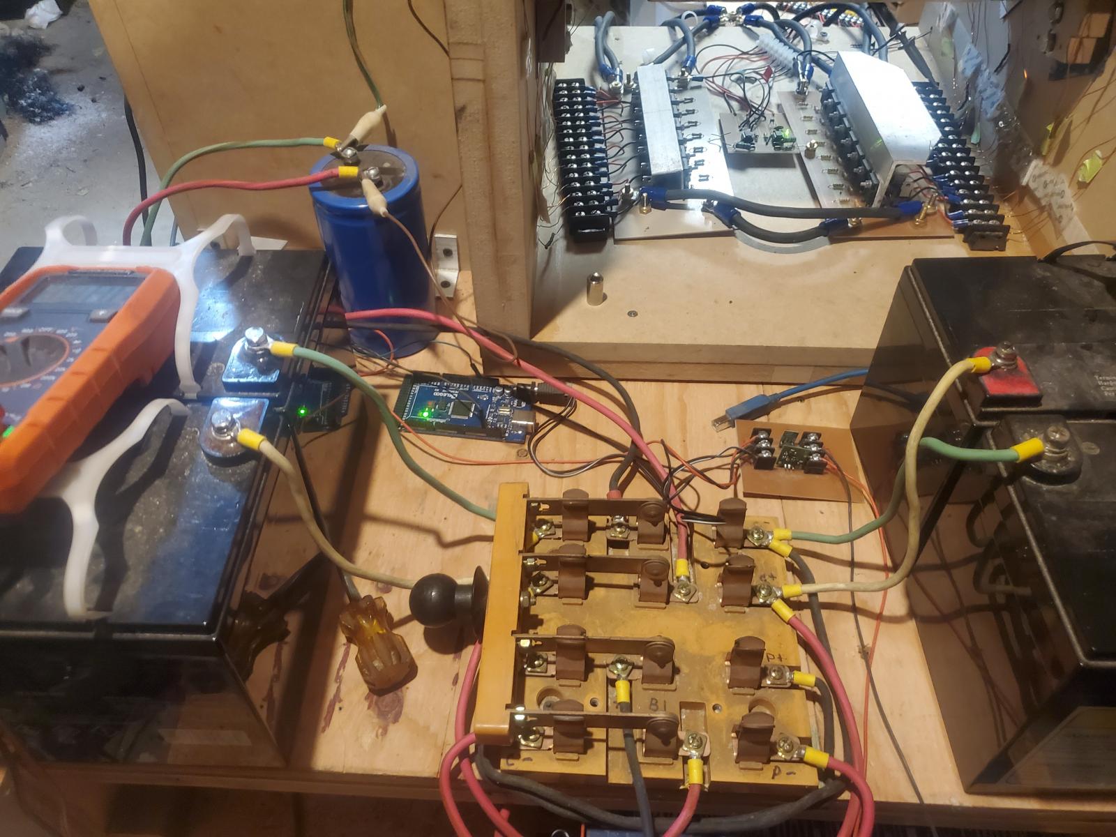

Name:	4PDT MANUAL SW.jpg

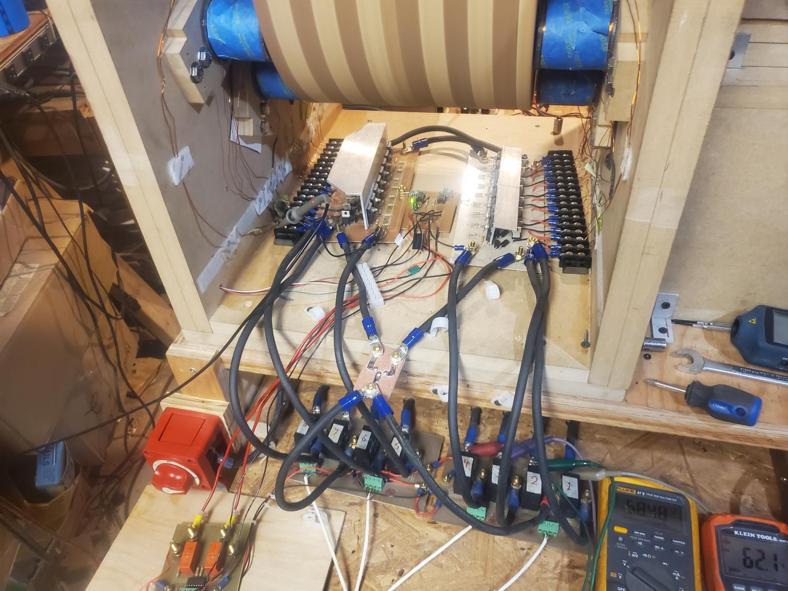

                          4PDT MANUAL SW. When switched to the left as shown the left bank is being charged and the right bank powers the arduino and fet driver through relays (Pololu) and the right bank feeds an invertor on a shelf lower than the big sw. When sw'ed to right reverse is true.
                          • #14
                            This cct goes between gen and 4PDT manual switch.
                            ARDUINO 4 FET CAP DUMP FROM GEN.pdf
                            bro d
                            • #15

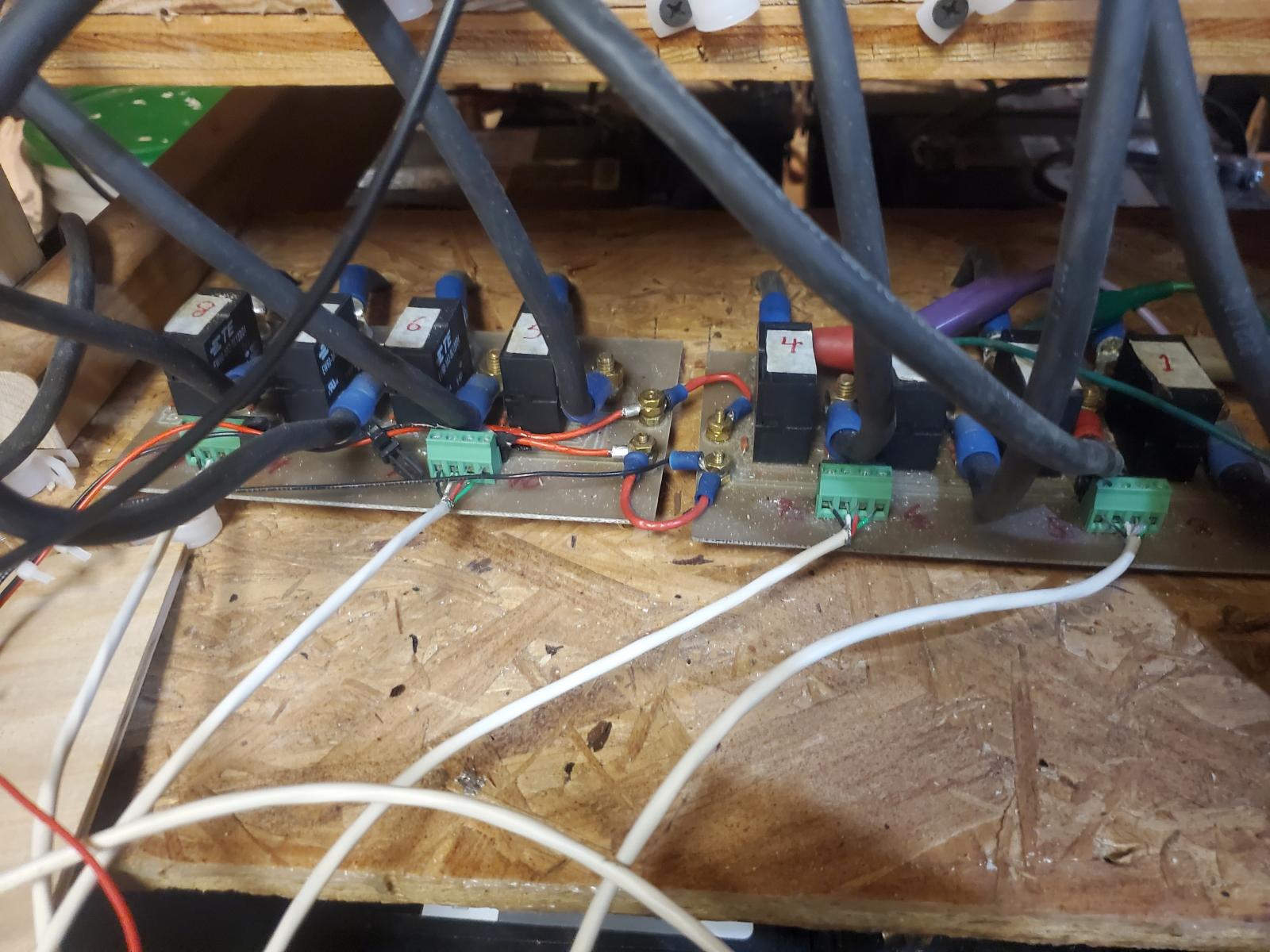

                              I use Arduino MEGA with a screw shield. The shield allows me to to tightly screw each lead rather than have inserted pin wires.
                              Click image for larger version  Name:	mega with screw shield.jpg Views:	20 Size:	262.2 KB ID:	512725
                              Click image for larger version  Name:	8 - 60A SPST LATCHING RELAYS.jpg Views:	21 Size:	209.9 KB ID:	512727
                              bro d
