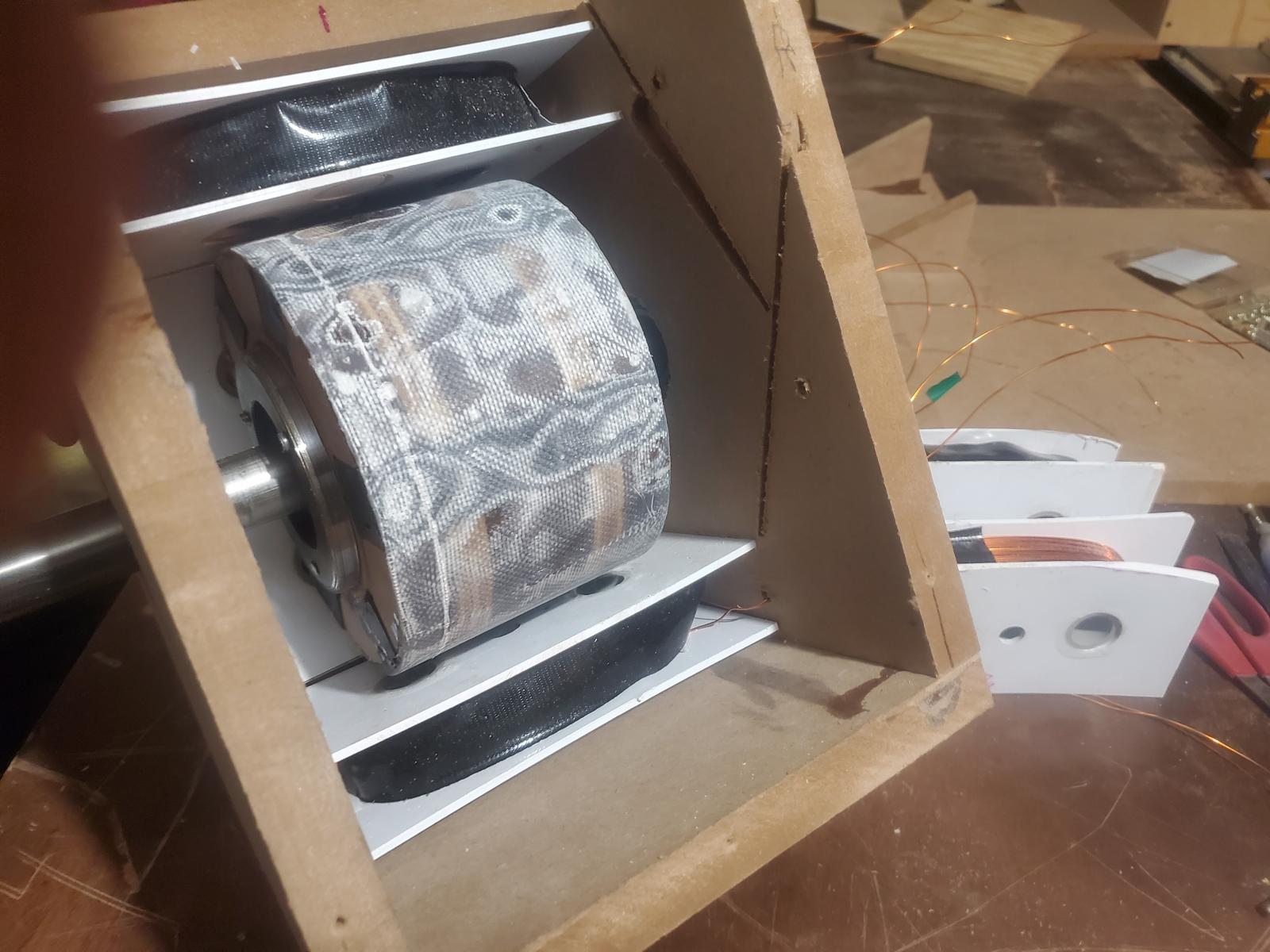

      1. Resistance of your 16 motor coils, as in the resistance of one of them, I assume they are all about the same.
      1200T OF #22 WIRE, 9.1Ω per coil. ( AVG)
      2. Resistance of one of your gen coils.
      600T of #20 wire, 9.5Ω (avg) The mags are 1 x 1 x 4", rectangular, air core.
      3. What way are the magnets on the gen rotor facing?
      N,N,N
      4. If the gen coils were energized by DC, what would be the orientation of the magnetic field they produce?
      Refer to pic of 6 mag gen before full assembly.
Name:	6 mag gen.jpg
      All the leads of the coils proceed from one end and the beginnings are marked.

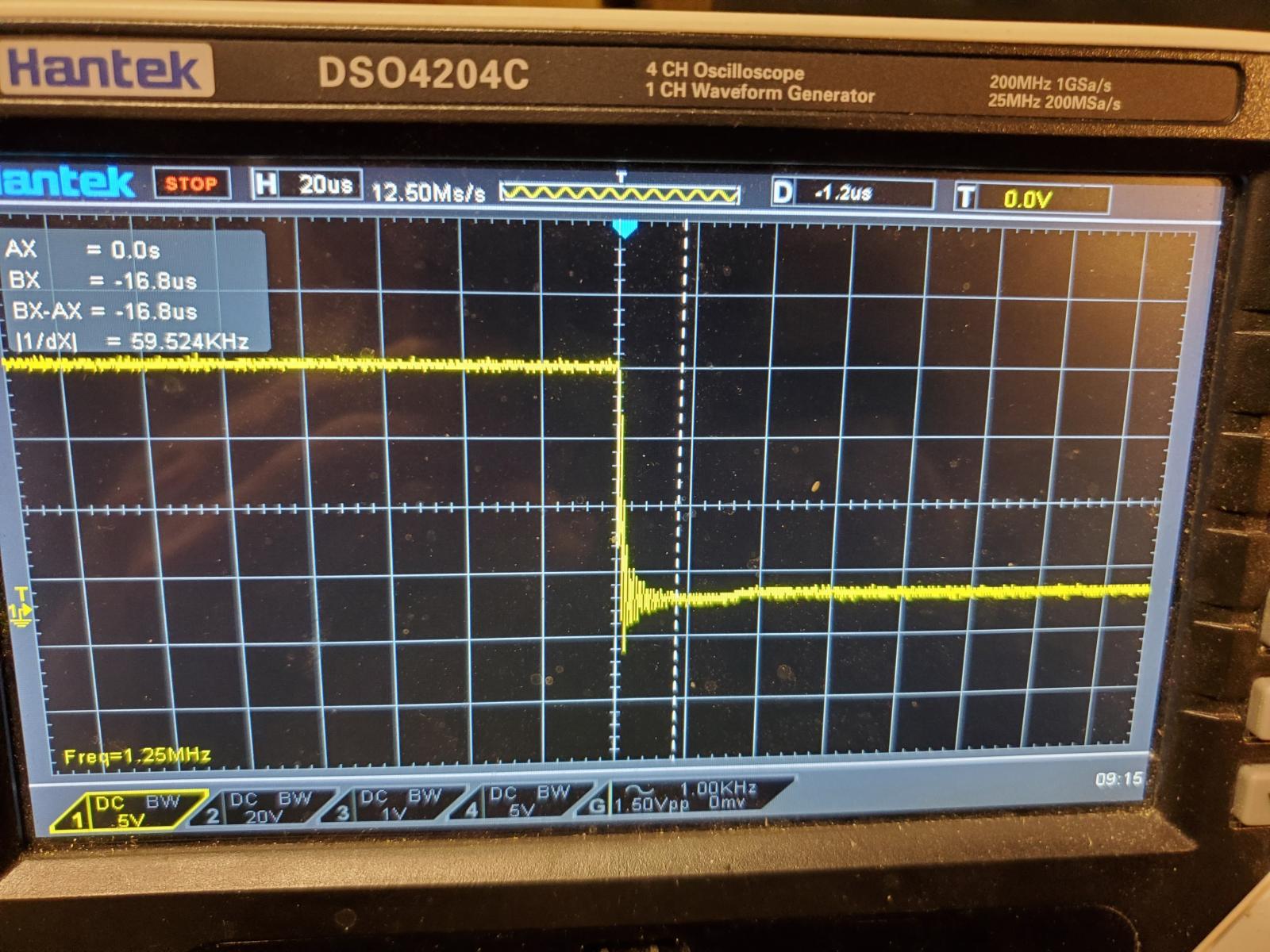

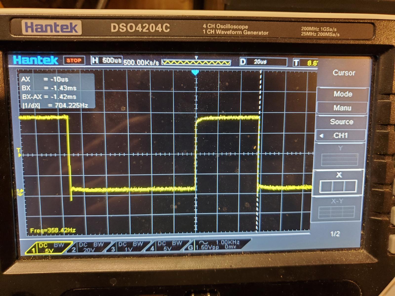

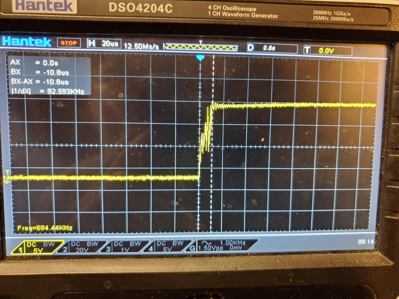

            What are the rise and fall times at the outputs from your gate drivers?
            3 pics. 1785RPM = 237.5 Hz (or so)
            1785 * 8 / 60 = 238Hz
            Probe is at the driver output.
            Click image for larger version  Name:	1 gate pulse.jpg Views:	0 Size:	266.4 KB ID:	512796 Click image for larger version  Name:	2 rise time.jpg Views:	0 Size:	266.2 KB ID:	512797 Click image for larger version  Name:	3 fall time.jpg Views:	0 Size:	259.0 KB ID:	512798

            • #36

                  2nd pic shows "Miller plateau" which is beyond my knowledge.
                  bro d
