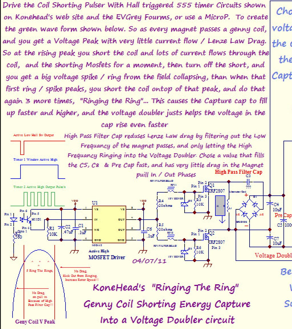

      Click image for larger version Name:	Ring the Ring-2024-02-01_18-23-58.jpg Views:	0 Size:	401.1 KB ID:	513227 This is like Ishmal Aviso (sp) / Konehead's Ring the Ring circuit.

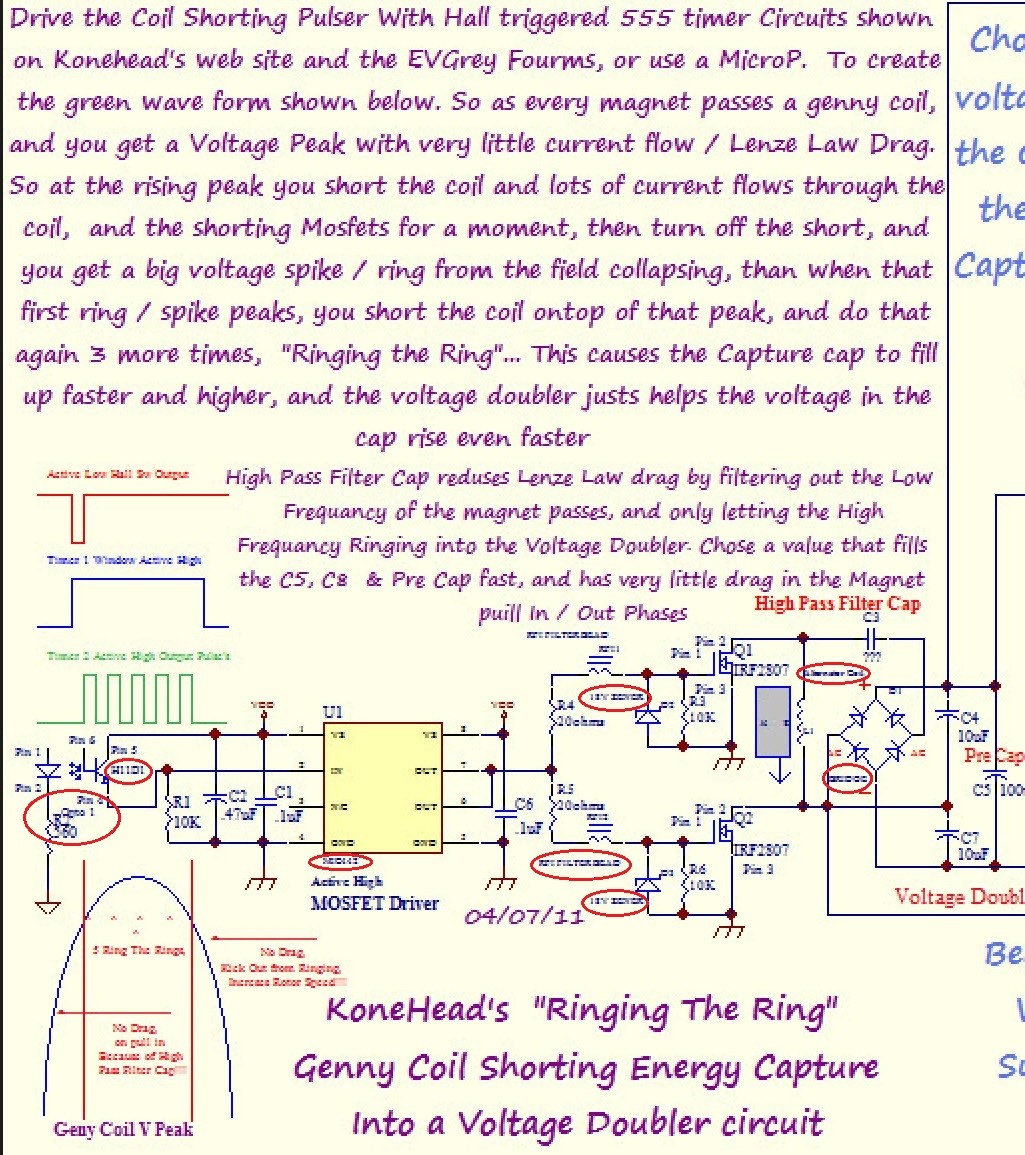

      Hey RS - I know this schematic is all you have but I can't read some of the part numbers and labels. When you have a moment, could you identify these for me? I've circled all of the labels that I can't read in your Ringing the Ring schematic (see attachment).

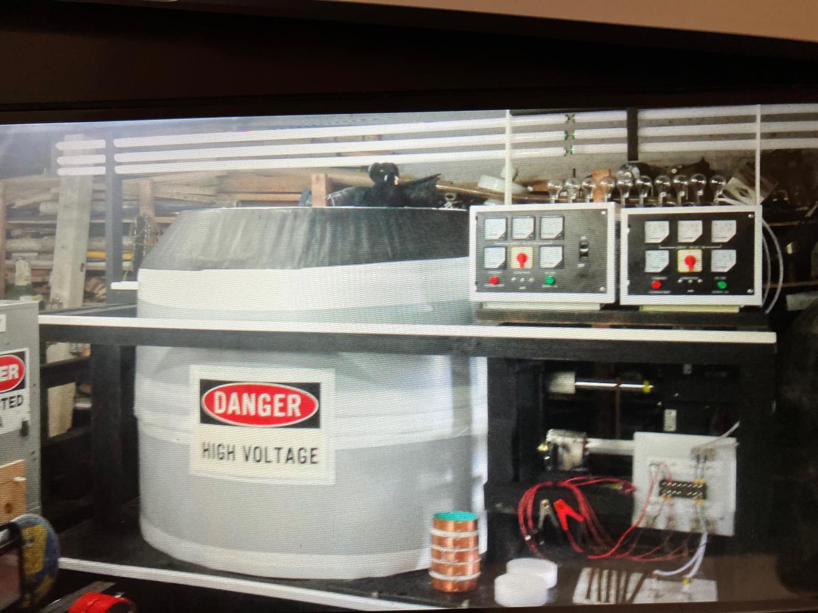

            The reason I am posting is twofold soon I will be having a REAL Joe Newman Motor for sale to everyone for R/D work
            it will be about 1x1x1 foot sq.
            You can see my BIG 10,000 lbs Newman Motor at energybat.com

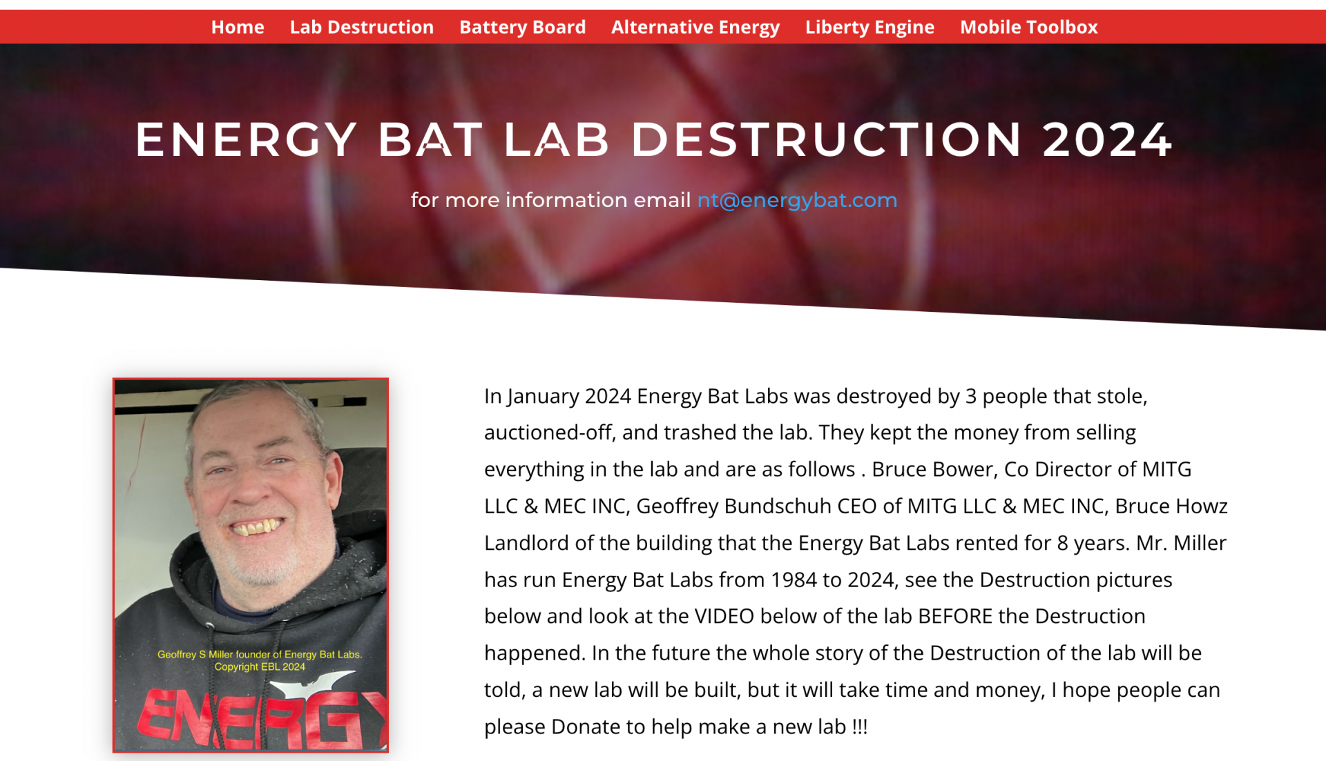

            The other reason that I am posting is that in this past January my 5,000 foot LAB was totally Destroyed,
            I want to rebuild a new lab, it will take money and Good people to help me to do this!
            You can see what happened to the lab on my website energybat.com, and look at the VIDEOS of it all.
