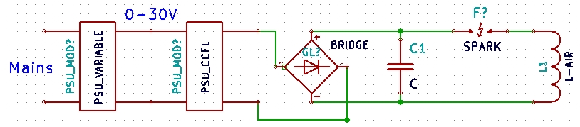

  • Originally posted by JohnStone View Post
    Here my schematic out of KiCad:
    [ATTACH]9578[/ATTACH]
    The negative voltage may occure due to the fact that your base current is being produced by a coil.
    Thanks for this schematic ok now I understood.

      Hi Guruji & all,
      now i realize - the initial laser saber circuit applies a series diode regarding to the transistor base. This protects the BE junction as well. So far no difference
      BUT:
      if we consider switching speed there are some additionl factors to be considered.
      As I explained before the BE junction contains a parasitic capacitor and this one needs to be charged and discharged at every switching edge befor the switching takes place. In case of the series diode this parasitic capacitor can't be discharged externally (because of diode blocking). It discharges itself by flattening the off slope a bit.
      Looking at this circuit i posted the diodes give a moderate negative voltage at base and thus the BE capacitance can be discharged readily. The slope is a bit better.
      BUT it comes worse:
      Please consider that every junction in a transistor contains a parasitic capacitance. So let's look at the CB capatcitance. At switch off time the C voltage raises very fast to enormeous voltages. This effects a minute current through the CB capacitance from C to B and thus the switch off time is being delayed - the slope flattened. (There are schematics where this is welcome in order to protect the transistor by opening it again by base current at excess voltages - but not in our circuit)
      Once again the series diode can't help but my posted schematic is able to drain this unwanted current from the collector to the moderate negative control voltage.
      A small capacitor across the base resistor is necessary as well in order to deliver a decent negative voltage / current for a short time.
      Following the hints above will increase both switching slopes of a transitor and help keeping it cool.
