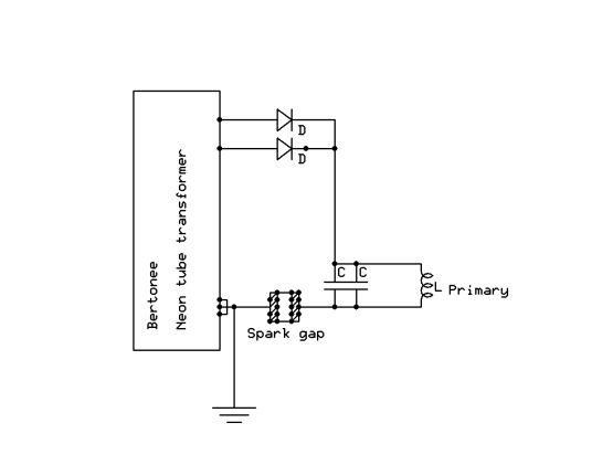

                  • Series Spark Gap
                    @ All,
                    If you are not running your primary LC in the same resonance frequency as your NST or Flyback, then you have to put your Spark Gap in series so it will generate enough spurious frequencies so that your LC primary will be exited by those kicks
                    So say that your NST/flb works again on 30 Khz, and you have tuned your primary LC for 5Mhz (which is a normal range for the air coils/capacitors used here), then a parallel SG will not work as being mentioned in my earlier post (dead short).
                    Putting the SG in series will cause the SG to fire and kick with its frequencies the primary LC tank to resonate on 5Mhz.
                    It will also limit the voltage in use here.
                    Concerning the LC circuit, use as less c (in the 10's / 100's pF range) as possible so the coil L will resonate as close to its natural resonance frequency as possible (highest Q).
                    Use one of the many resonance calculators on the web to calculate your LC values:
                    L/C Resonance Calculator
                    Say your Primary L has 18uH, then your C will need to be 56 pF to resonante at 5 Mhz
                    Make sure your C can handle the HV.
                    Be aware you are basically building a spark-transmitter which can cause lots of interference.
                    Regards Itsu

                      • Originally posted by Itsu View Post
                        @ All,
                        Regards Itsu
                        What happens when diodes are used to charge the caps on double frequency?
