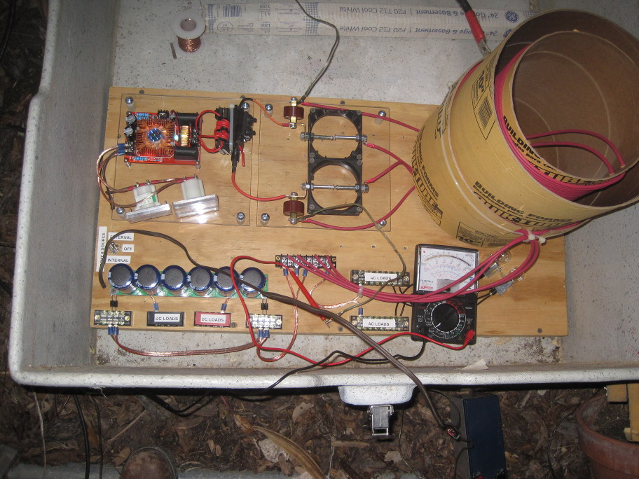

    Tonight's progress: more-or-less completion of the HV side (need to figure out a good way to mount the meters), and measuring the actual antenna current. Measured 0.25 mA using the analog meter while driving device with ZVS at 24V input. This represents ~7W of power at 26KV. No light on the bulbs with either one bulb or two, but of course one secondary is now charging the cap bank so this represents a load. Cap bank pre-charged to 12V and no looping tested. Spark is a brilliant pure white.

    Hey Tswift; it is me or your secondary is far from your primary??

    OK, tightening up the build quality of the HV section. Wood anywhere close to HV is not good. Standoff distances are going to have to be close to 2 inches to reach higher voltages. I made the HVM on a separate baseplate from the PPV/cap section, so I can drop-in a replacement HVM section with the PVM12 and multiplier stacks when it's ready. I also took the brass brackets to the belt sander and rounded off the corners to reduce corona.
