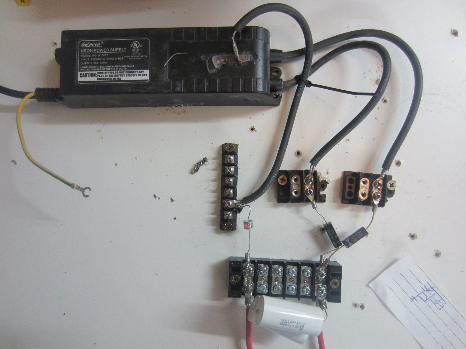

    • trying to get my primary side firing with a high frequency nst and using the ground wire was not doing anything so I dug into the case and attached directly to the center tap of the secondary, finally have a firing spark gap using both outputs together with a diode on each.
      • Good, looks like you're making progress! Although, in my experimenting I have had very limited success with those GDT's used like that. They tend to just light up like a neon tube in a steady glow (and get very hot) instead of operating in discrete sparks at a high frequency. I'm assuming there's a coil across the cap out of frame in the first picture, you should see on the scope a short burst of noise at the peak of each AC waveform, that's the spark happening and the coil ringing. If you adjust your trigger level to trigger at the noise burst and then zoom the timebase in you should see the coil/cap ringing frequency. If you then zoom in several steps further you should see the coil 1/4 wave ringing frequency at the very beginning of the spark pulse.

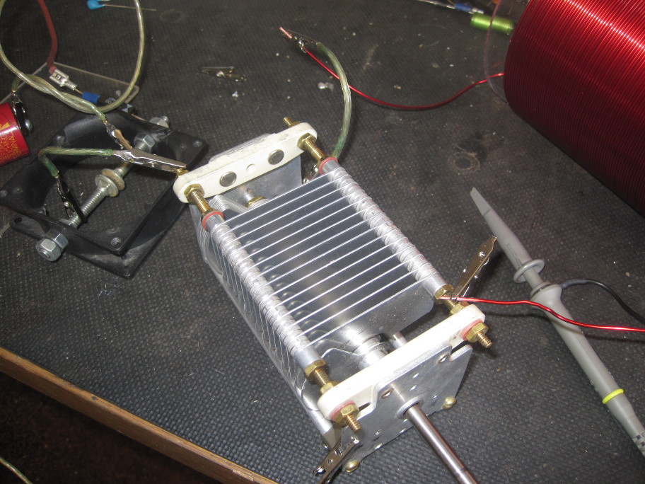

            • He are some photos of a preliminary test with an existing coil that was lying around and then making a 1000uH 117 turn coil on 5" acrylic tube to be resonant at 500khz.

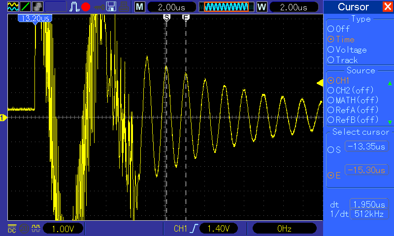

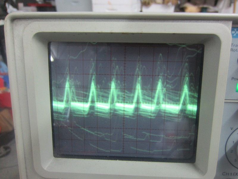

                      • Today's experimenting: put the L1 coil into the test circuit and check the frequency. The design frequency is 500 KHz, with a tuning range encompassing both higher and lower frequencies. As built with the variable capacitor I have the tuning range is approximately 300 KHz - 1000 KHz. Here some pictures and a scope shot of the test circuit tuned for 500 KHz (approximately).
