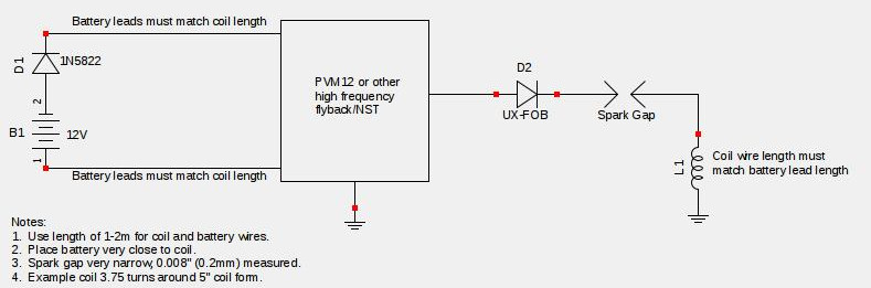

              • Here's an example of this applied to a Don Smith style circuit. The coil is the primary from my small slayer exciter / benchtop Tesla coil (depending on input). It's 3.75 turns around a 5" coil form (an oatmeal can). The capacitor is 10 nF in a series/parallel array so it can take up to 6 KV. This coil and cap in parallel resonate at about 675 KHz, which is a perfect match for my 3" mailing tube Tesla resonator (not shown in this picture). Here I am zapping this coil/cap combo through a spark gap placed between ground and one side of the coil/cap combo. The NST in this case is the PWM12 I use for many of my experiments, through a high voltage diode. The whole cap/coil combo is hot (electrically with HV) at the NST frequency when operating, and each spark of the gap also triggers the coil quarter-wave resonance, as can be seen with the scope probe just barely visible in the picture. As per Don's instructions, the battery leads are also tuned to quarter-wave resonance at the same frequency, because they are the same length (measured and cut to about 68 inches in this case) and I have coiled them similiarly to try and get a more precise resonance match. With the kickback diode in the positive lead (it's small but can be seen at the positive battery terminal), this arrangement is supposed to be self-charging according to Don. Indeed, in the hour or so I have had this configuration running on the workbench this evening, the battery voltage has not only not dropped, it has gained slightly. Not that this is really conclusive: a battery this big can run this circuit for many hours and lead-acid batteries exhibit numerous behaviors that can fool you. As you observed, trying to use a digital meter anywhere near an operating circuit is useless, I have to turn it off to take measurements.
                Essentially this is the Don Smith configuration up through the L1 coil. Don's "tabletop" device is really two separate overunity stages in series, and this is the first. The battery acts as radiant receiver and stays self-charged, with the overunity happening in the NST transformer. The amount of overunity power involved is quite small, only a couple of watts probably. The second overunity stage uses the big cap bank as the radiant receiver and the overunity happens in the output transformer stage, and this is where the big power gain happens. Or at least I'm pretty sure will happen, once I have it working.

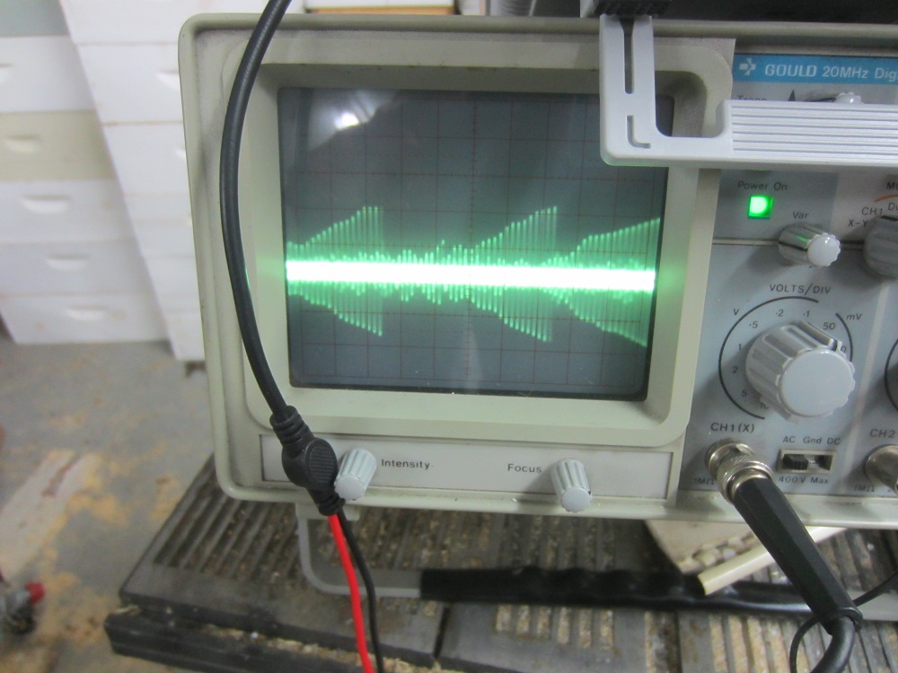

                • Very nice, thank you for the example, I set mine up just like that and took some scope readings, I used my other nst as well and tried two different coils, also played with capacitors across the coil, they were all similar to this and not much I did changed anything. I believe I am looking to have a trumpet shaped trace or "whale shape" instead of what I have now. I had a ground wire connected to the sparkgap.
                  Any advice on this? it's hard to know what to do/change when I am not exactly sure what I am looking for in the first place.

                  • Looking good, you're off to a good start. The real problem we face as experimenters trying to recreate the Don Smith device is that the available information is incomplete and we know it. So since I don't have a fully working device either, all I can do is (A) share my own theories and test setups and (B) give you advice on equipment and technique. What you will need to do is accumulate a selection of different parts that you can fit together in numerous different ways, and get good at building configurations, testing and observing the results, and then rebuilding to examine different aspects yourself. For example, the spark gap position. What happens when it's in parallel vs. in series? What do you observe?
                    A couple other things... you have a high voltage diode but it's not a high frequency ultrafast diode. When working with one of those NST's that isn't 60 Hz but something higher you'll need a faster diode. That one will (A) heat up and (B) not block well if at all in the reverse direction so it won't really be rectifying. The ones I have I got from Ebay and they are marked UX-FOB, rated 16 KV and sold for use with inverter type microwaves. Also, it looks like you have a digital storage scope. There is probably a way to capture a single waveform trace and store it so you can measure it more easily and it isn't jumping around all over the screen. Try to find this and get a clearer picture of what is happening immediately after the big vertical jump in the waveform, this is where the spark is happening and you want to zoom in on the first part of the ringdown.
                    In a regular classical Tesla coil with a primary and secondary both ringing, the ringing waveform seen by a scope probe some distance away is mostly due to the secondary and the modulation envelope will first rise within a few cycles as the primary transfers energy to the secondary and then slowly ring down over some dozens of cycles. Experience with building and tuning a regular Tesla coil is highly relevant to building the Don Smith device, and you even need most of the same parts, so I would recommend doing it as a small side project. If you have a 60 Hz NST without a GFI and a variac you're mostly in business already. You'll need to wind a primary and secondary, but this doesn't have to be complicated or expensive. I scavenged a microwave oven transformer for the wire, and used the 16 gauge primary wire for the Tesla primary (shown in the picture) wound around an oatmeal can. The secondary is about 14" long wound around a 3" cardboard mailing tube using the 26 gauge wire from the MOT secondary and the two match quite well with 10 nF of capacitance across the primary. I can drive it with a transistor as a CW slayer exciter, or with a spark gap as a real Tesla coil. For just a few watts of input power I can get 2" sparks out of it but of course our primary purpose here isn't to make pretty sparks. For the Don Smith device we need to make this oscillating electric field around the ringing coils (which Don called "disturbing ambient") and see if we can can collect power from it. It's easy enough to transmit power wirelessly between two Tesla coils with one as transmitter and one as receiver, but this by itself is not overunity. You can test this yourself by winding a second identical Tesla primary and secondary, one MOT is enough wire to wind two this size. As with all science, the way to progress forward is to TEST THINGS YOURSELF instead of just accepting textbook explanations or other people's opinions. Your goal should be to acquire the necessary test equipment, supplies, and skills to be able to do this.
                    Also, you can begin looking for signs of overunity now with this configuration you have going. Do what I did and connect your battery with a wire the same length as the coil you're zapping. Another coil of identical dimensions would be perfect, but start with just the wire length and find out. Actually you would need two coils, one for positive and one for negative, or else make a bifilar coil out of something like speaker wire that's two strands. Put a high-speed or ultrafast diode in the battery positive lead. Test the battery voltage, run the circuit for a few hours, then turn it off and wait for the battery voltage to settle (perhaps 5-10 minutes, watch it on a voltmeter and observe how it recovers after the load is removed), then find out whether it's self-charging or not as Don said. You will also need to make sure there is an earth ground on the NST that's properly grounded (into the third prong of the house wiring works OK) in order to have any hope of seeing the Don Smith effect manifest. Then coil up the battery cables into a coil with similar geometry as the one you're zapping and test again. Does it really make any difference? If you can observe self-charging happening, then you already have a self-running overunity device. Then it's a matter of figuring out the L2 coil and output circuit to get larger amounts of power.

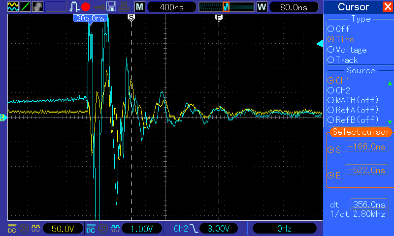

                        • I took a few scope shots to better illustrate the ringing you're looking for. This is essentially the same bench setup shown before, the PVM12 into a high speed high voltage diode, then through a very narrow spark gap, then into the coil which has the other end grounded. The spark frequency is 69 KHz. The ringing frequency of the coil (with no cap across it) is about 12-13 MHz, as can be seen in the second scope shot. I am using the cursor feature of the scope to measure three waveform peaks, so multiply the computed frequency by 3. This is the same waveform as the first picture, just zoomed in greatly on the timebase axis to show the first microsecond after the spark happens, when the coil is shock-excited. The waveform is complicated and messy at first as the spark excites not just the fundamental frequency but all kinds of overtones. The overtones damp out more quickly than the fundamental as it rings down. Since this is a system with one end grounded, the overtones will be primarily odd order, like 3f, 5f, 7f, etc. However, the grounding is not zero impedance and the ground wire has its own length so in the real world it's quite complicated as the scope shows.
                          The length of this coil is about 68 inches. Using the 247/L formula it should have a frequency of around 43 MHz, not 13. The additional inductance and distributed capacitance caused by winding the wire into a round form causes this. I assume a straight conductor of the same length would test reasonably close to the computed number. This is one of the great difficulties with the Don Smith device, you can't just do a little quick arithmetic, slap some parts together, and have it work. You have to be able to measure and tune. Even Don said to take a neon bulb and find the point of maximum output on the secondary coil because it's hard to compute exactly.
                          • After some more testing, this configuration APPEARS to be self-running. Upon starting the PVM12, the battery voltage droops a bit for the first 5-10 minutes but then starts gaining very slowly afterward. I need to run it continuously for many hours to be sure, but if true it confirms what Don said about making the battery leads 1/4 wavelength long keeping the battery charged. The battery leads shown are 68 inches long, the same as the wire length in the coil to within an inch or two.
                            The scope trace shows what's happening, the yellow trace is from the probe attached to the battery positive terminal. At each spark it bounces quite a bit and the "kickback" diode should be pushing in current on each positive peak. The blue trace is from the scope probe sitting next to the coil on the bench separated by an air gap with only capacitive coupling, so it's measuring the "disturbance to ambient" as Don would call it. The two waveforms are quite evidently in phase so the electrons being pushed into the battery are picking up the scalar characteristic of the ambient voltage at that point in the waveform, which then causes reduced Lenz's law in the high-voltage transformer within the PVM12. The spark gap is adjusted very narrow, almost touching, and the PVM12 is set to maximum frequency (about 70 KHz). I have run this configuration for a number of hours off and on now, but not continuously. The battery is very nearly dead, it was reading 10.1 volts yesterday before I ran the test. After about half an hour it was at 10.3, when I shut it down. This morning it's still at 10.3 after sitting overnight so the gain appears real. As I said, more testing is needed but this looks like a preliminary positive result.

                              • After further testing, I'm still calling this one a qualified success. Starting with an almost completely discharged battery reading 10.1 volts, the voltage on the battery climbed to 10.42 over some time. However, the battery gets weird so it's hard to be sure. At first the voltage droops for a few minutes. Then if you stop the circuit, let it rest for a few minutes to get a good battery reading, and restart it, the voltage starts gaining. It's impossible to get a good reading with a digital voltmeter while the circuit is running. But as it runs some more, over time the battery readings get strange. After several hours, it seemed like the spark gap was running less strong, so I stopped it and the battery read 8.00V initially... but then very slowly climbed up to 10.42 over a period of 15-20 minutes. My voltmeter also likes to go crazy and give erratic readings on the battery, you can watch it start climbing slowly and then peak out over the 20V range (not an autoranging meter), then go back down to a reasonable reading and repeat this over and over. If I put the same meter on a conventionally charged battery it doesn't do this. Sometimes it calms down and gives believable readings. If I check the battery voltage with the oscilloscope it doesn't show this erratic behavior, but the scope is much less precise.
                                The conclusion I am reaching is that the battery is getting charged with at least some radiant energy, as Don described. Since the test configuration is so simple I recommend everyone to test it for yourself and see what results you get. It appears to be self-running some of the time, but not all of the time. Why, I don't know yet. Test it for yourself and see what it does for you.
