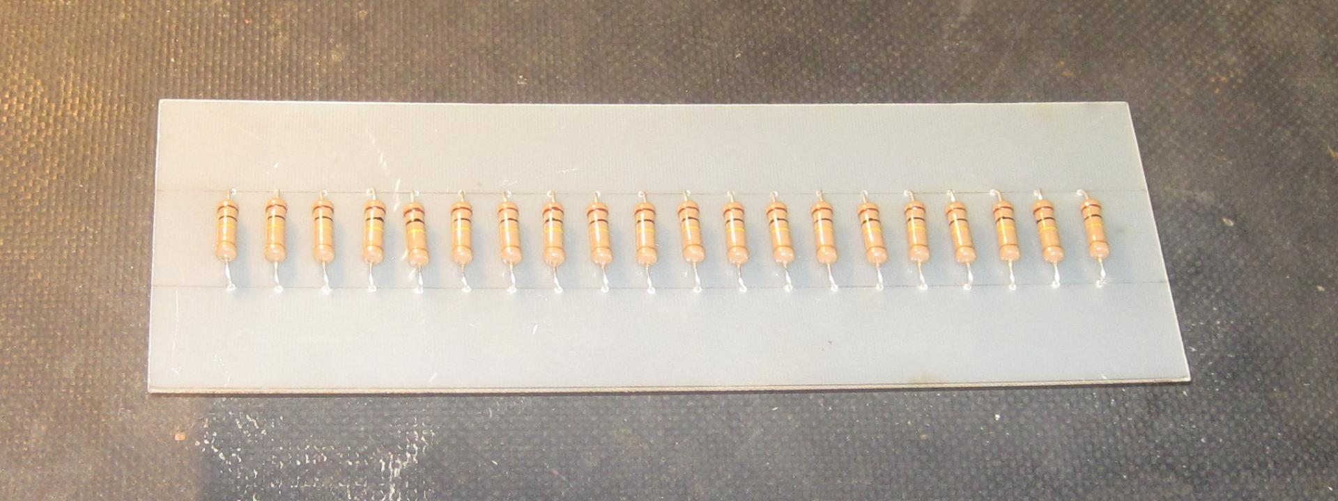

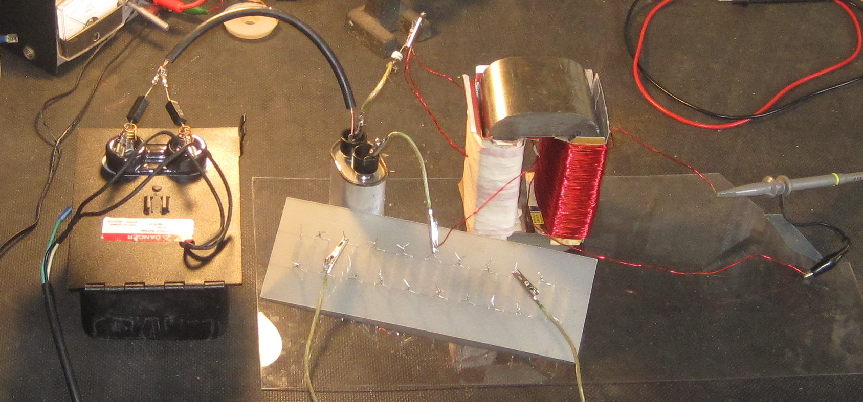

              • OK, as promised here is the new test rig implementing the schematic previously mentioned. I needed some high-value resistors, I got a bunch of 100K carbon film resistors rated 2W and 500V each. I made a series array with 20 of them on a spare sheet of G10 fiberglass (I would have used acrylic but I know these will get quite hot), so I now have a 2M resistor array rated for 40 watts and 10KV. Sure enough, when hooked up to the output of my 10KV oil burner ignition transformer they get warm. The transformer is rated 240VA and 10KVAC, so that's a rated load current of 24 mA and an optimum load resistance of 416Kohms.
                To get close to the 416K resistance I jumper to the middle of the resistor array and then use the exposed resistor leads as taps. In the photo I have six resistors on each side, so that's 600K but there are two legs in parallel, giving a 300K net load resistance. For this test I tried various settings but it didn't seem to make much difference.
                The cap is the same 0.86 uF microwave oven cap I have used in various experiments. It's rated 2100VAC, but here it's not charging to anything near that because the 120V gas-discharge tube across it that shorts it into the transformer primary, as in the schematic. Using more capacitance reduces the spark rate for a given setting on the variac feeding the OBIT. With this small capacitor and the variac about halfway it sparks at a constant 60 Hz, with two half-wave charge cycles from the transformer bringing the cap up to the point where the GDT breaks down. The transformer is the same big metglas core I have used for numerous experiments. The resulting waveform is a nice half-sine cycle, but when you attach any load to it the voltage collapses greatly, showing no signs of reduced lenz's law.
                So in conclusion: the circuit operates but no magic. I think there must be something missing, the schematic shows a cap bank as if it's implying a large capacitance, but I tried configurations up to 50 uF with a couple big motor run caps in parallel and the only difference it made was greatly reducing the spark rate. Also the variable resistor would seem to imply a much lower resistance value, it's hard to find real power-rated rheostat type resistors of more than 1-2K. This would still cause a voltage drop across the resistance when the cap is charging, which I assumed was the point of the circuit, but a much smaller voltage drop. With my high resistance array the voltage ON the cap (as opposed to the voltage ACROSS) the cap is nearly the full output voltage of the OBIT.

                              How/where do I probe my nst to check its frequency without ruining my scope or frequency counter/function generator?
